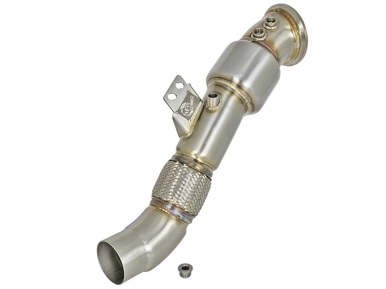

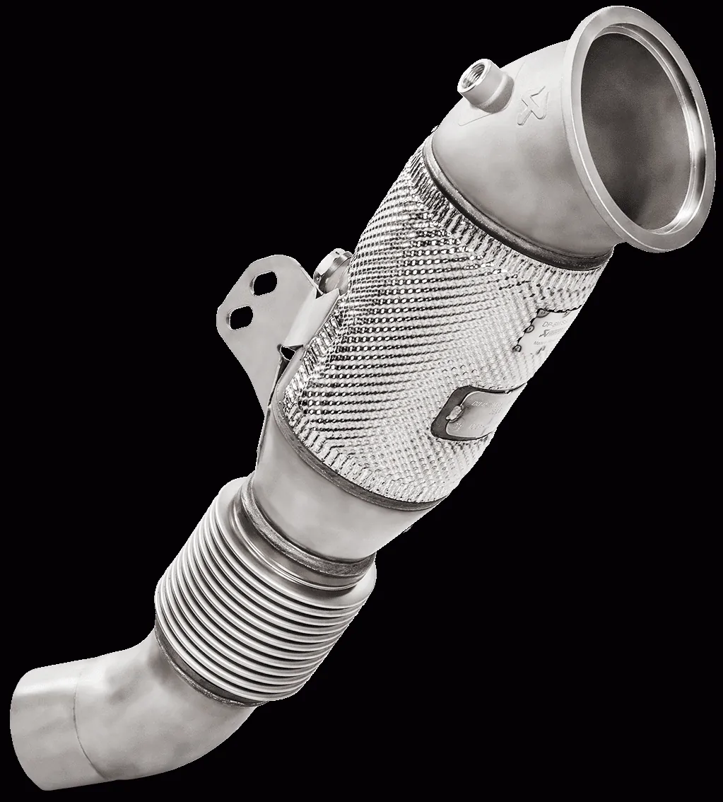

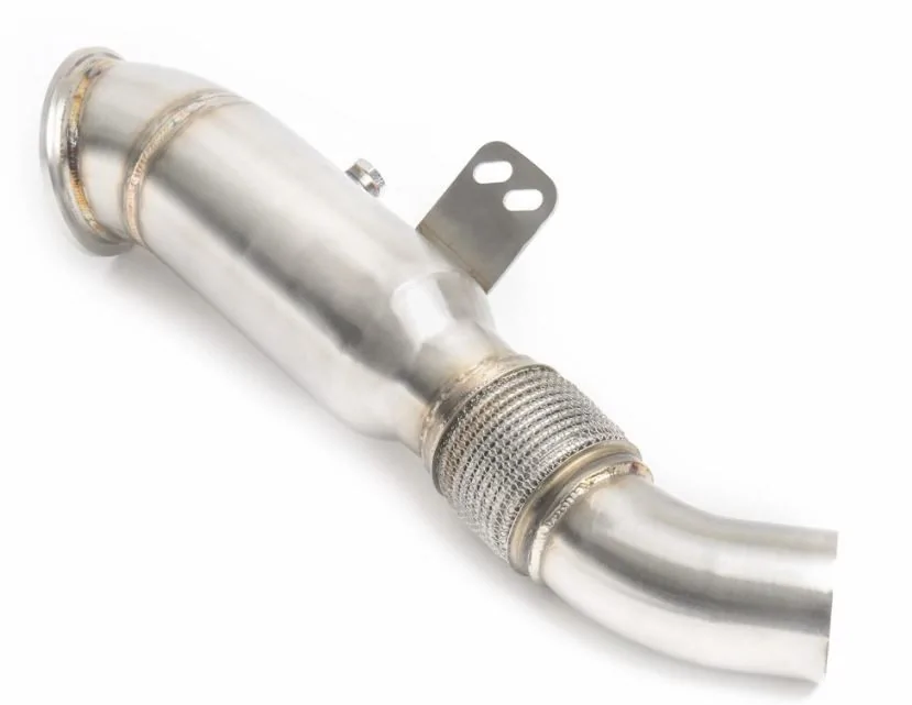

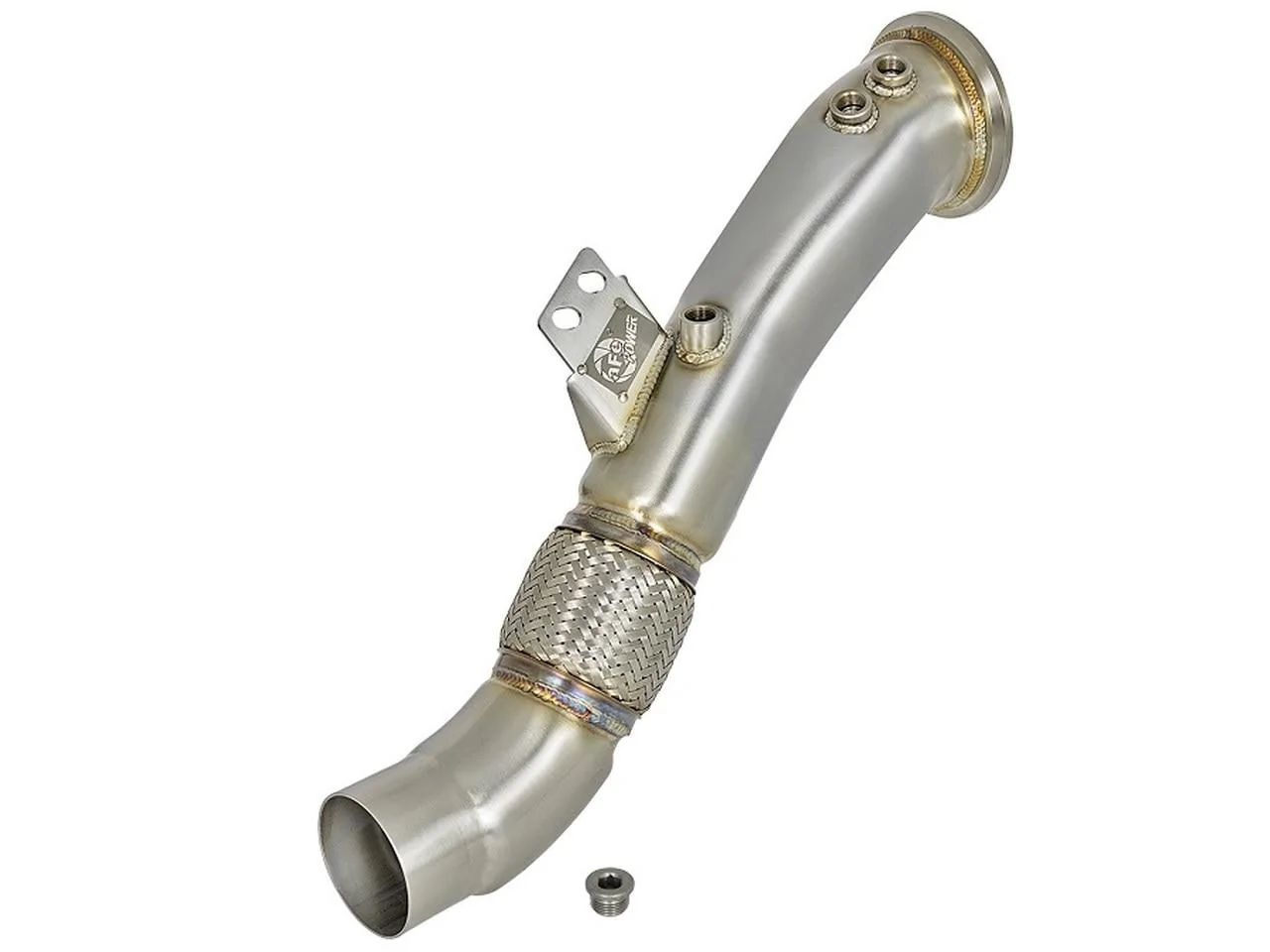

Well, I've looked at (not physically!) almost all downpipe websites and YouTube videos during expanding the, now unfinished, mods DB and I can tell you they vary in inlet diameter, transition diameter, location of sensor and with all that the flow restrictions hence the varying sounds. Some come without the bracket...
While I had no luck in finding any specifics on the Akrapovic in any website, the pictures suggest a smooth transition from 4" CAT to 3.5" flex area to end with 3.15"
CG-Precision starts off at 5"..
Also, some end with 4" if you have 4" catbacks to attach to..
Akrapovic:
aFe DP with CAT
aFE DP without CAT
Some noname brand
Just to show you how they differ in overall diameter, the transition... However, less restriction doesn't always equate to more desirable sounds.. So, better watch videos and look at dyno results... but more or less they'll give you the same power..
