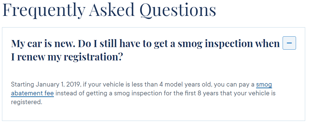

Usually any form of high flow cat isn't legal here in California.
BUT it is also worth mentioning that any MKV Supra technically doesn't need to be smog checked for 8 years anyways due to the recent smog rule changes in 2019.
