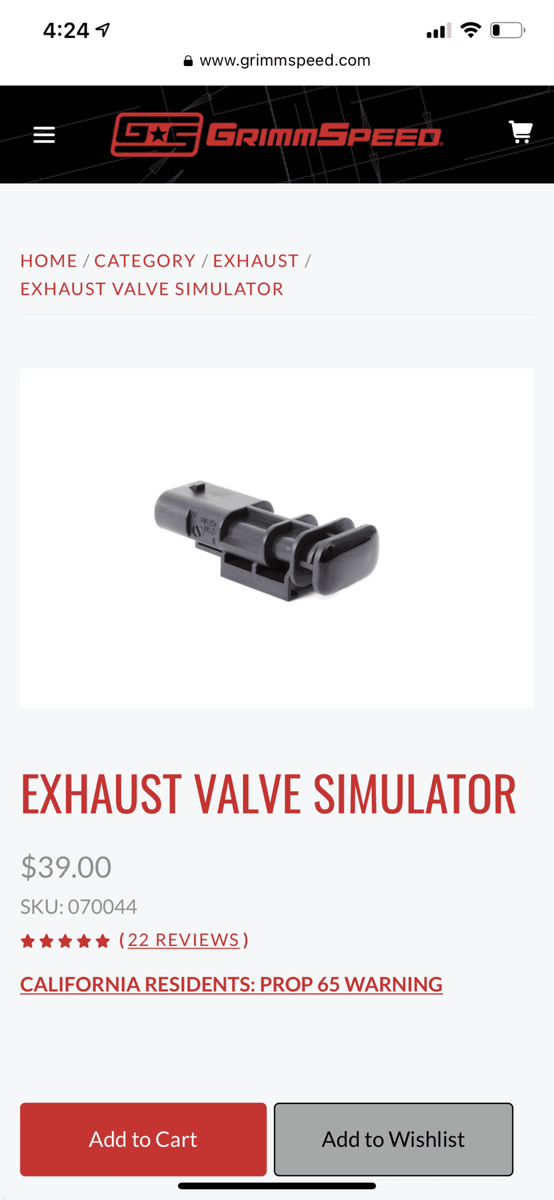

One more question. What did you do with the oem valve motor? Did it trigger a code since it's not installed anymore?
It does not trigger anything. Mine has been unplugged on my OEM exhaust ever since I put my downpipe on.
8,473
14,119
The valve motor not being attached should absolutely throw a code. That’s why the little plate things are sold. Perhaps it’s coded out in your tune.
do you have a part number? or is it this one? I need to confirm so I can order mine before my exhaust gets sent to me.
BMW part 18302411427.
So, I unplugged the valve and left it on the factory exhaust. Then I stuffed the cord that connected it up in a panel under the car. At this time I do not have any issues or codes. However, I am keeping an eye on it as I feel it should throw code. I’m curious if this could be the solution?
I never threw a code with the tomei.
Untunable 2021, Its been unplugged since may and 16,000 miles. Zero codes
