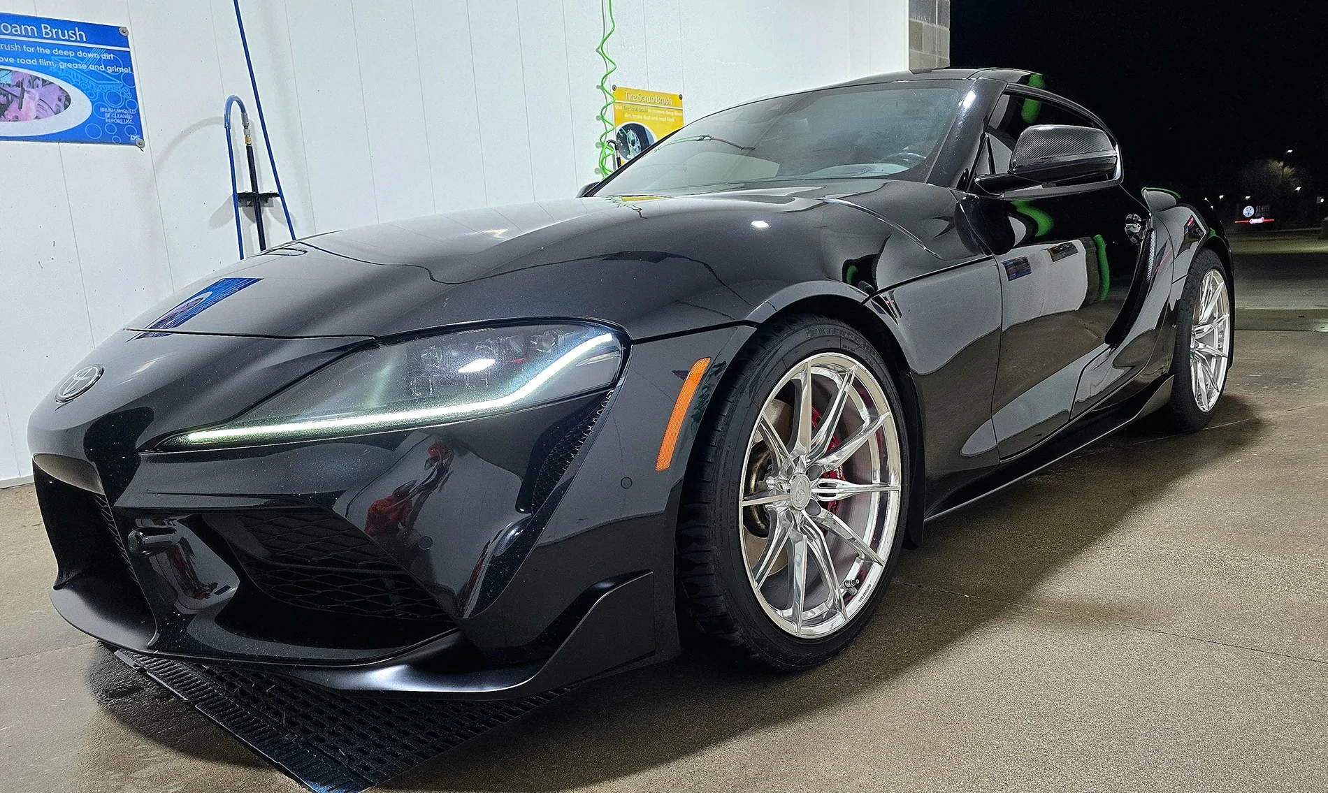

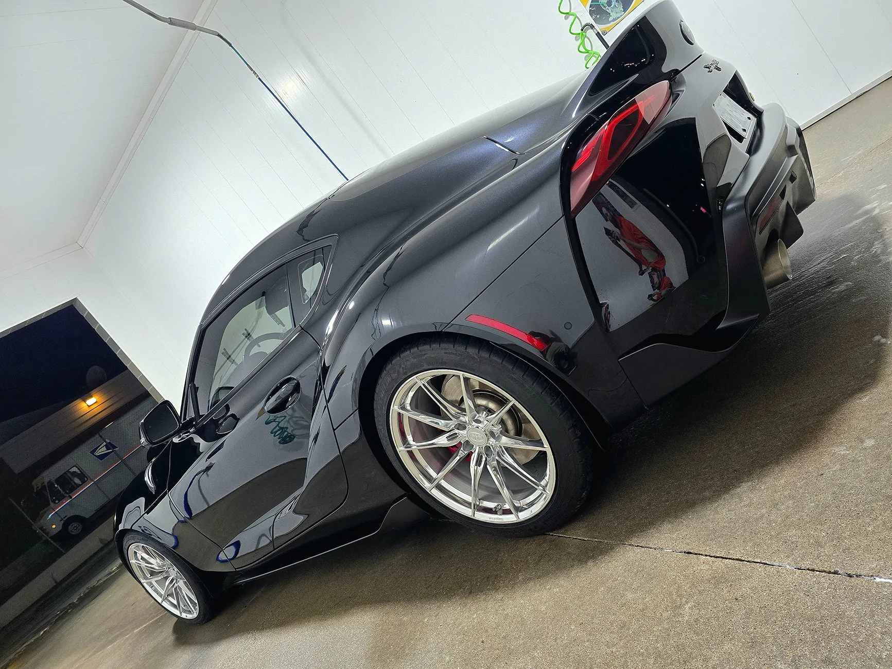

Here's my current setup for my '23...
All stock suspension. Zero Rubbing.
VFC Performance Wheels OEM Style.
Front: 19x10 (+30) 275/35/19
Toyo Extensa HP II (500 Tread Wear).
Rear: 19x11 (+40) 305/35/19
Michelin Pilot Super Sports (300 Tread Wear).
