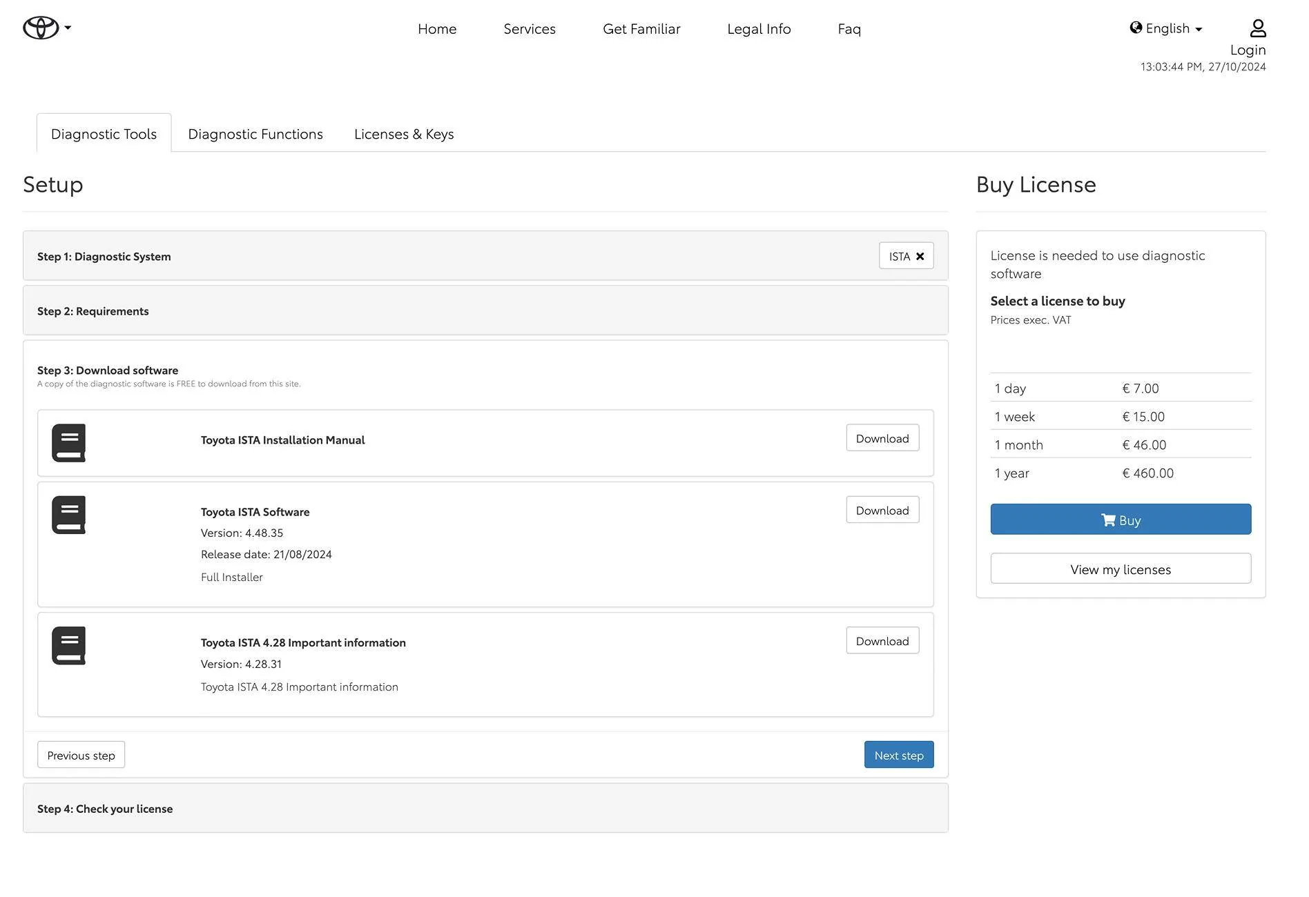

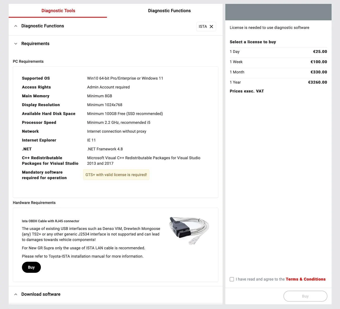

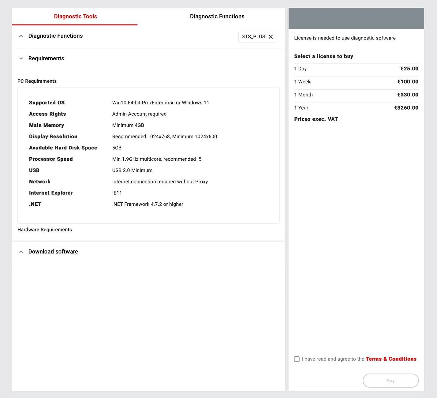

When trying to purchase gts or ista at 15 euro for 1 week each:
https://www.toyota-tech.eu/DiagnosticTools/Software/ISTA
it sends me to the Toyota log in page for techdoc-toyota.com and only gives options to buy GTS+ for $100 for a week and ista for $100 for a week. I feel like I'm missing something. Any advice is appreciated!
Edit: I realized that I need to go to the .eu site. It is down for maintenance through the 28th. Sigh.
