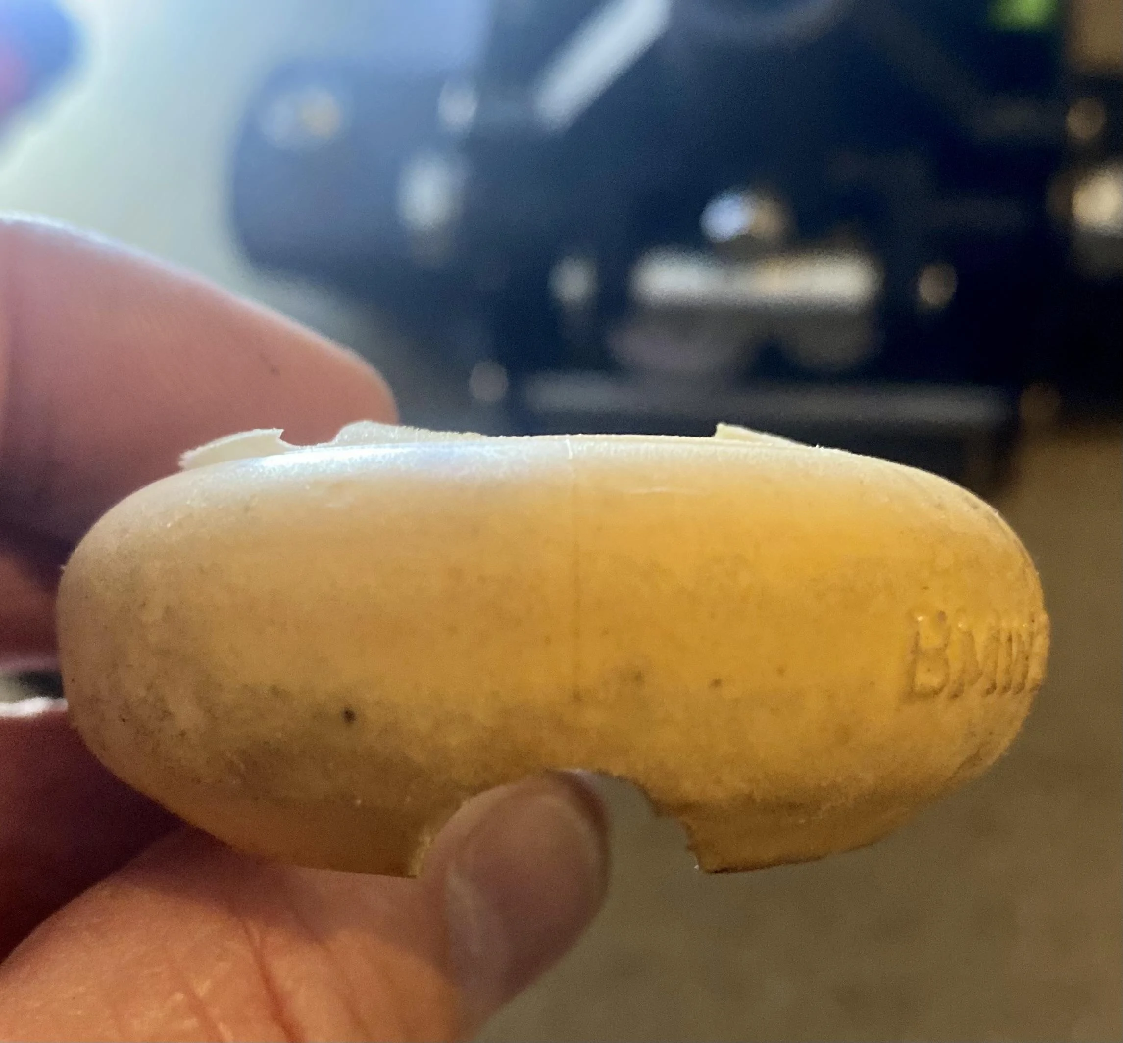

Those of you with the Euro Eibach springs, do they come with silencers or bump stops or anything else?
~ The rear springs have the silencers and you must trim the front and rear bump stops.

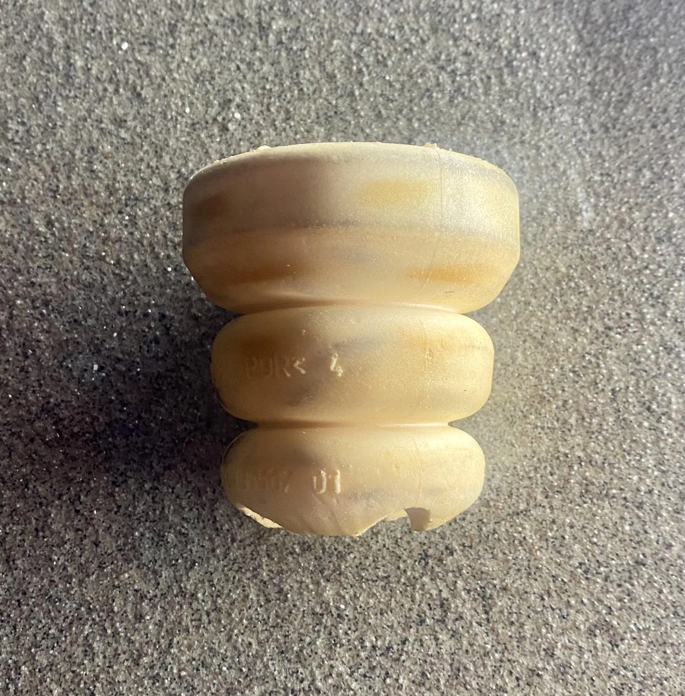

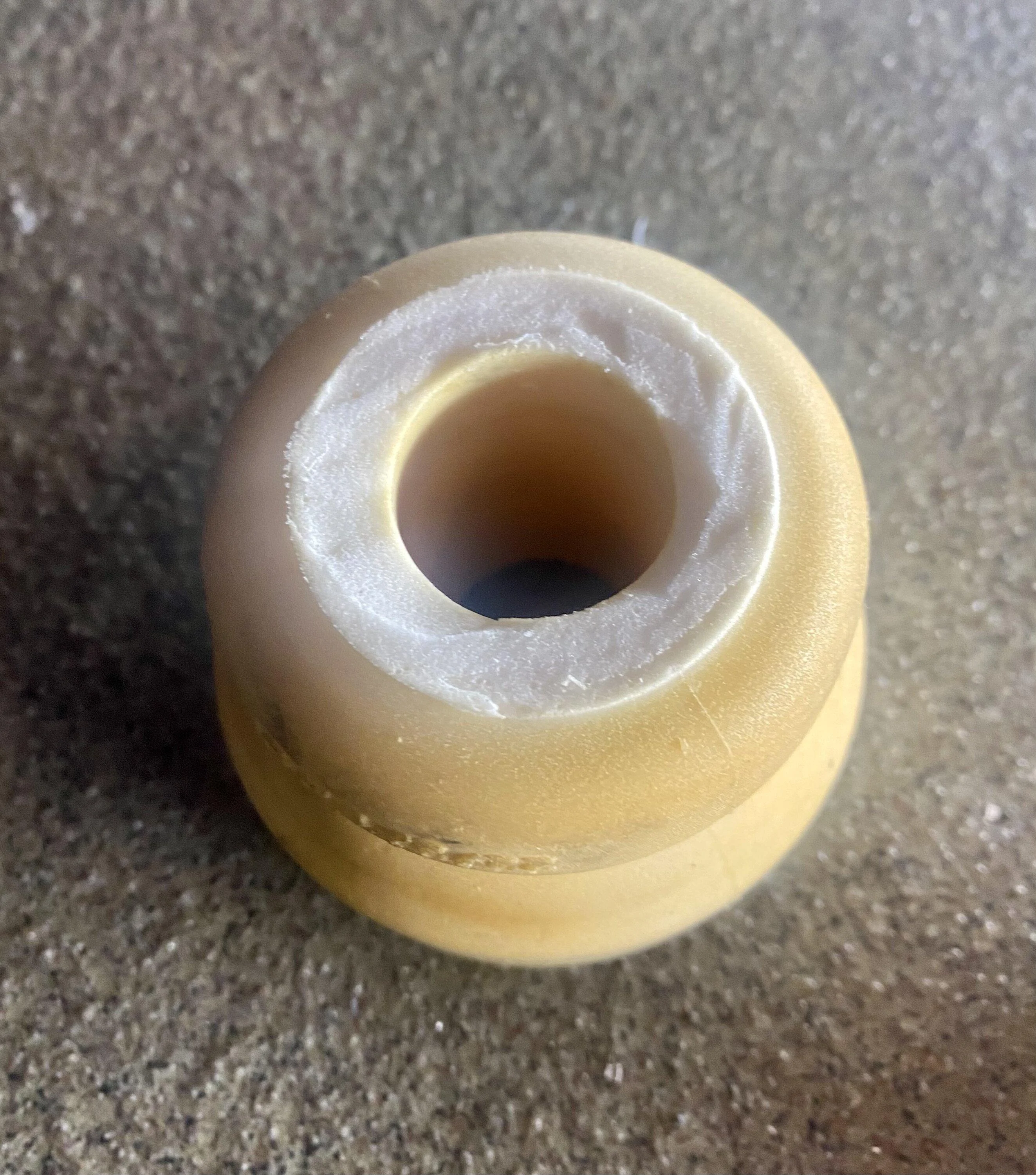

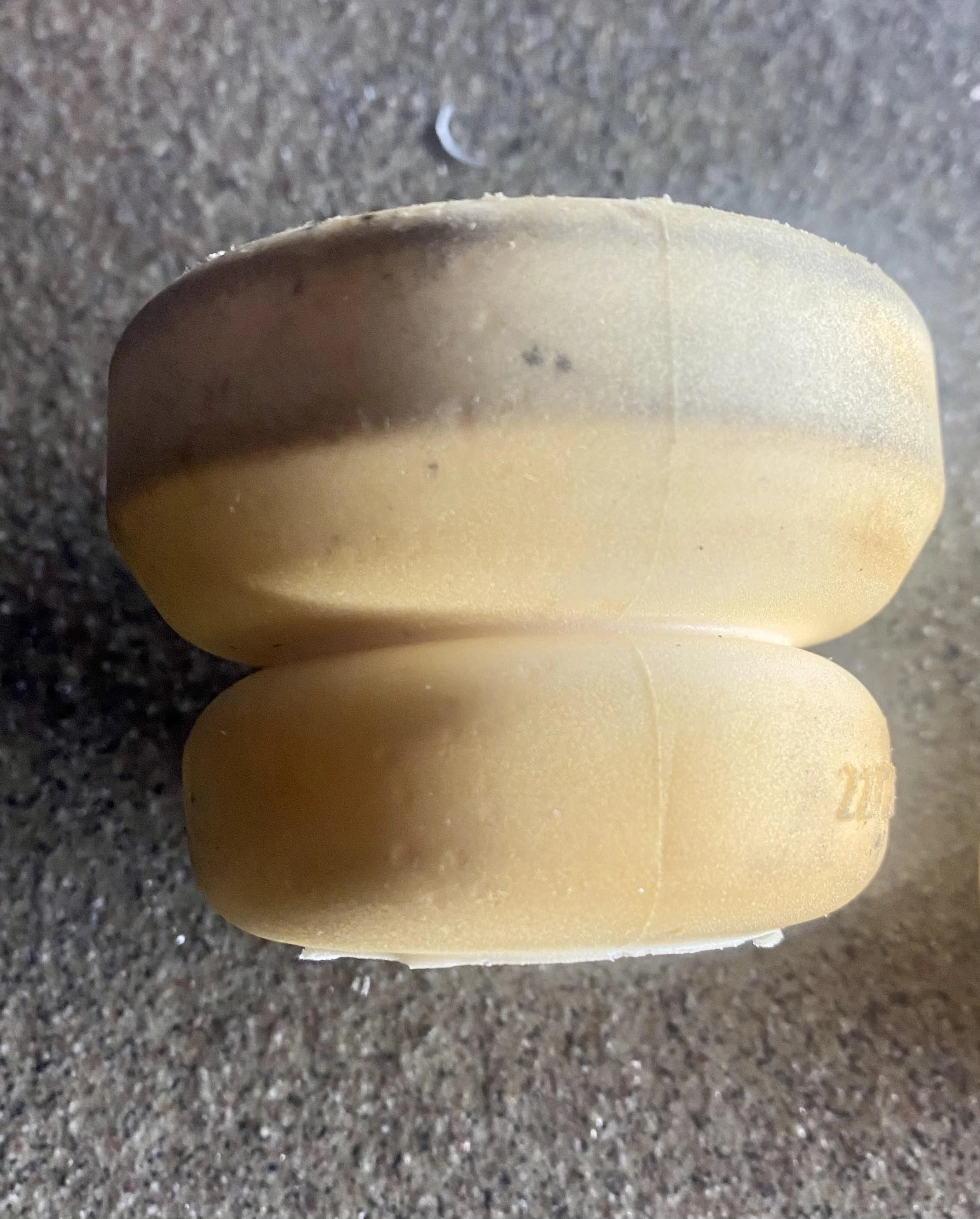

I'm installing these springs on my 2022. How much of the bump stops are you supposed to trim? Any help would be appreciated.

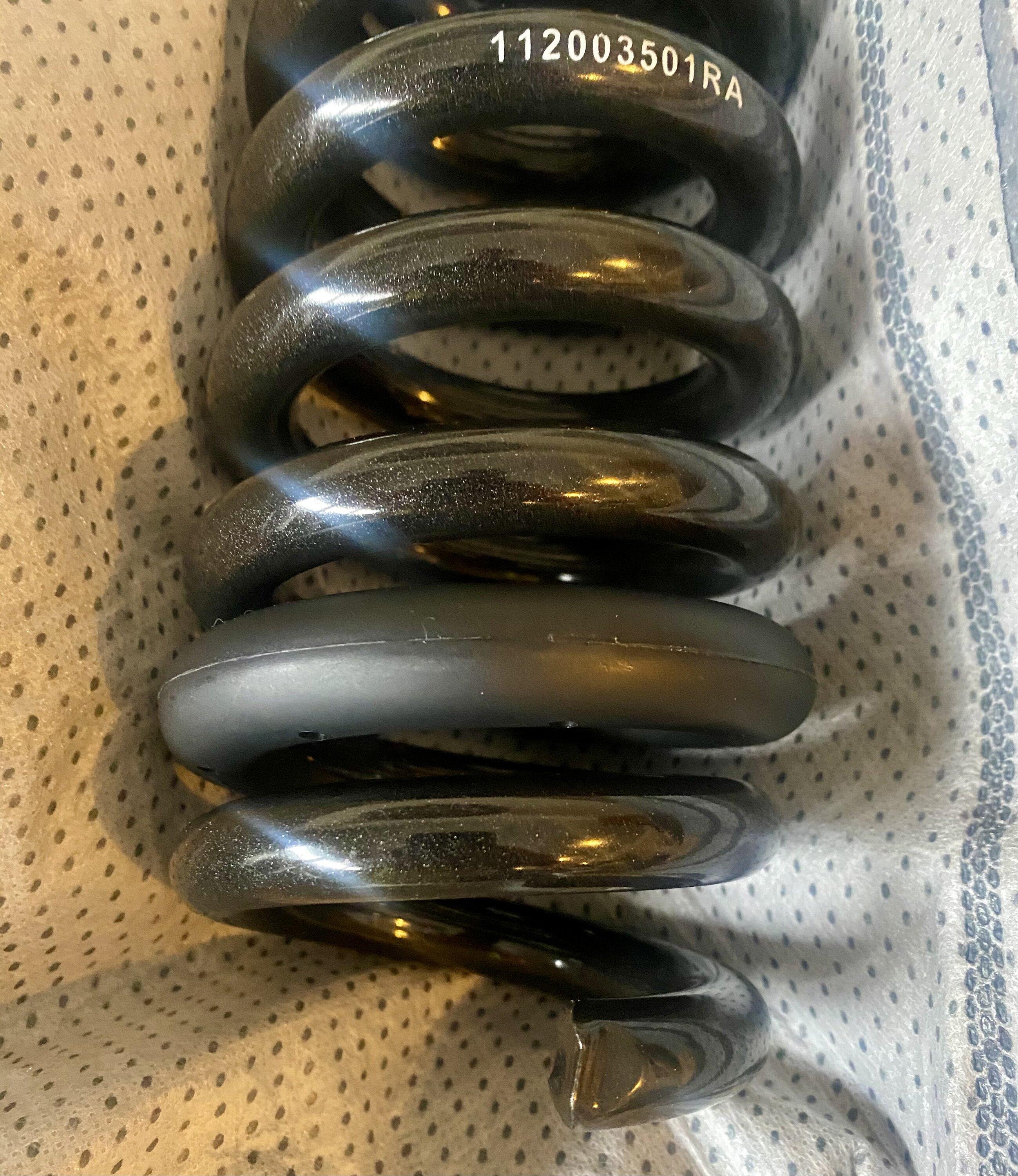

Welp. I have a set of eibach z4 lowering springs and some set of silencers. I haven’t decided whether I want to install them or not, since my past experience with cars, every time I installed aftermarket parts, I always end up with some mysterious suspension noise. Anyone install springs and NOT get weird sounds?
They install exactly like the stockers using the same silencers. The only change is cutting one donut from the bump stops. If there are noises after install then you’ve done something wrong. I can’t even tell a difference in ride quality.
No. Reuse everything and cut one donut off the bump stops.

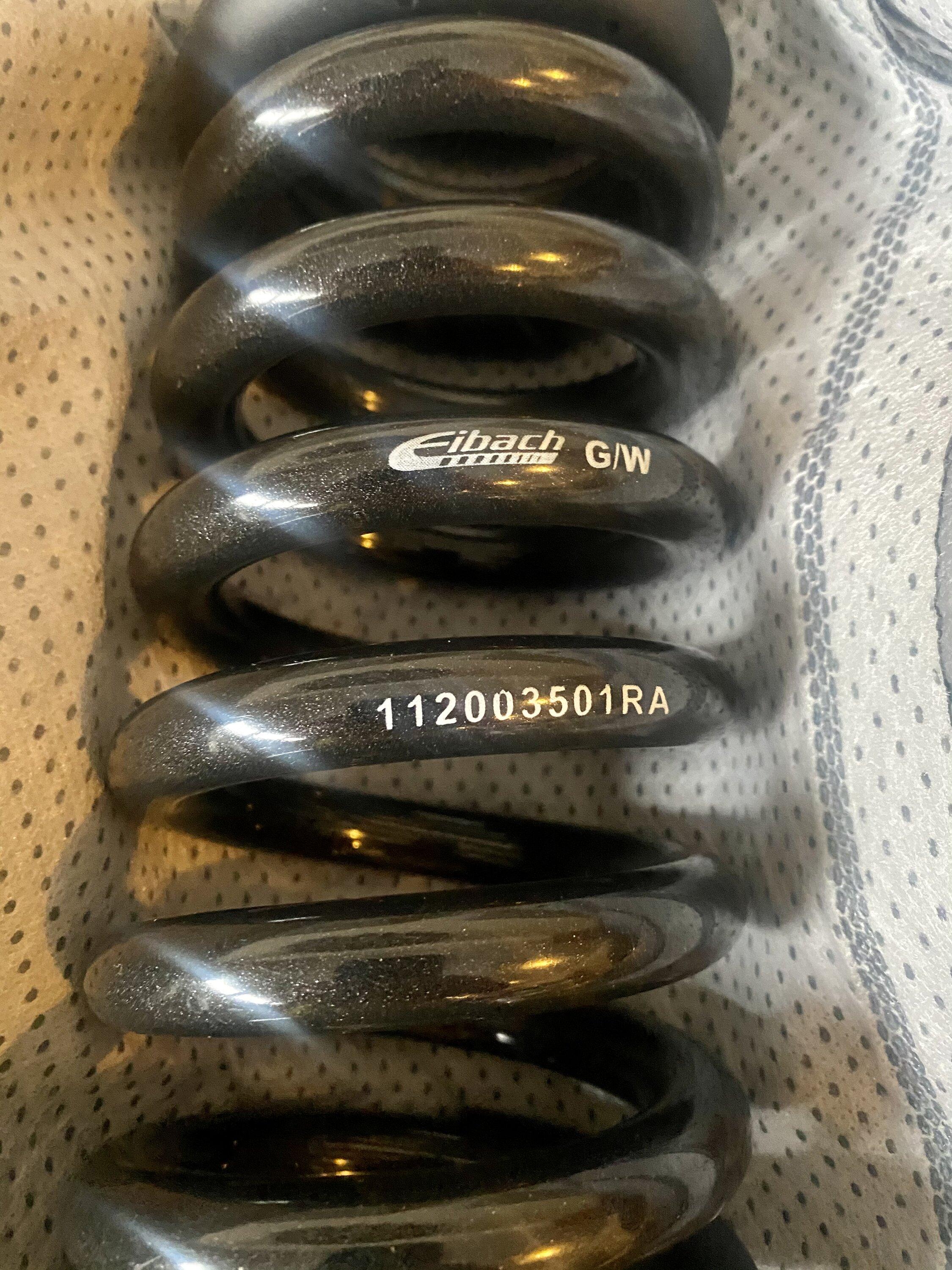

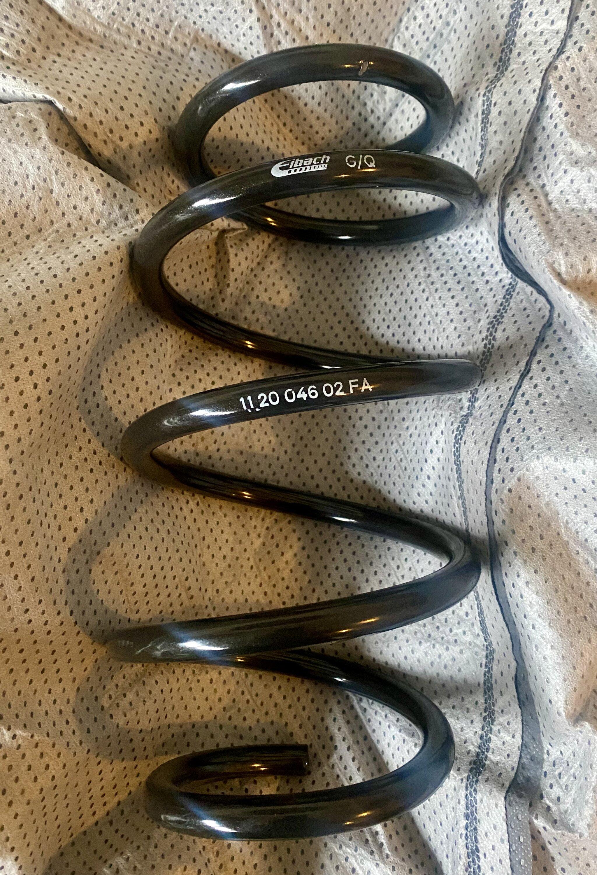

Can anyone compare differences on ride quality and street performance between the Z4 Euro Eibach vs US-spec Eibach ProKits? I know they have different advertised height drop but the US spec was specifically made for the GR Supra while the Euro-spec was just used for the Supra because “it fits and with milder drop” springs.
I have been searching and searching for the answer this question myself and would like to better understand how these z4 springs feel in comparison the more aggressive kit. I am leaning towards the z4 springs but dont want to install them is they are considered too soft and cause rubbing issues later. Any feedback is appreciated!
Eibach Z4 springs are excellent on the street - slightly stiffer than stock and retain much of the OEM ride comfort, reduced wheel gap, while not be so low that you scrap everywhere. Handling precision and responsiveness is slightly increased over stock. They are not too soft for the street or spirited driving on the OE dampers. I liken these springs to something that GR/TRD could have offered as an OEM+ upgrade.
I love the Z4 springs but I am transitioning to coilovers because I want to run aggressive track wheels that require more inboard clearance that coilovers offer. I don't regret getting Eibach Z4 springs - I just regret not coming to the conclusion at the time of my suspension shopping that I will be getting aggressive track wheels.
