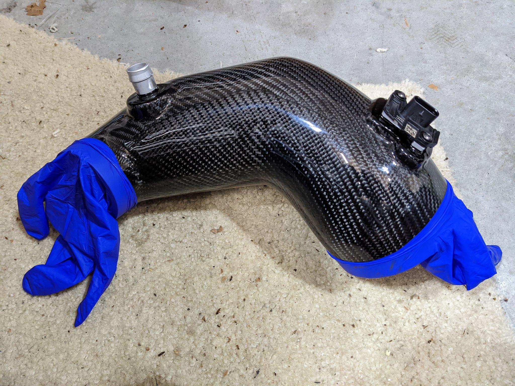

Put a glove on each end and the sensor mounted and suck on the pcv tube, its hard to see light unless its a really bright flashlight.

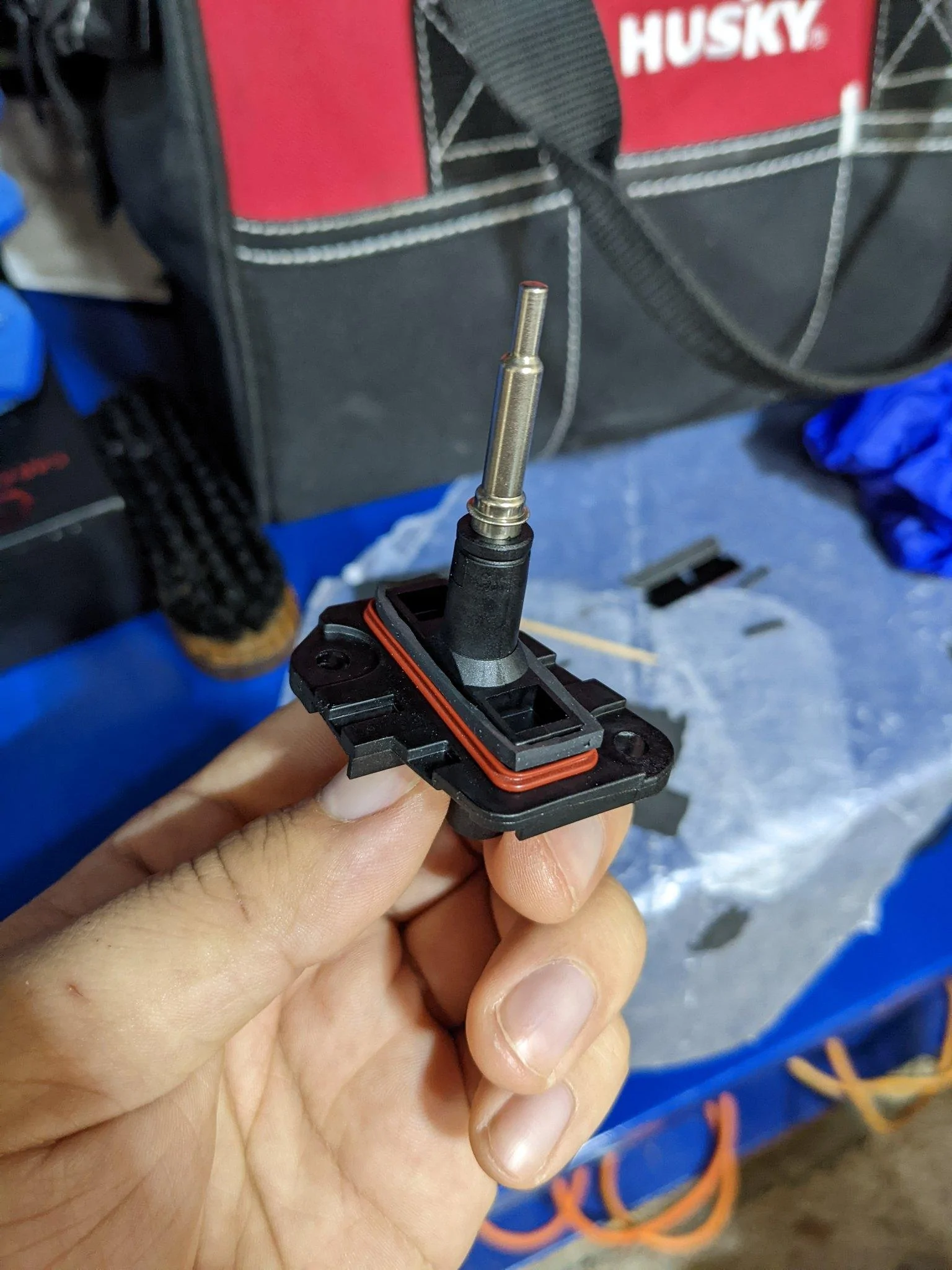

When i mounted the temp sensor to my HKS the stock oring compressed as the sensor was tightened down. Night and day vs the Armaspeed.

I got mine from A90 Shop, shined a really bright lamp through, but couldn't see it. I then attached gloves to the ends, tightened the sensor down and blew into the vacuum line. I was able to confirm for sure it leaked out air at the sensor area.

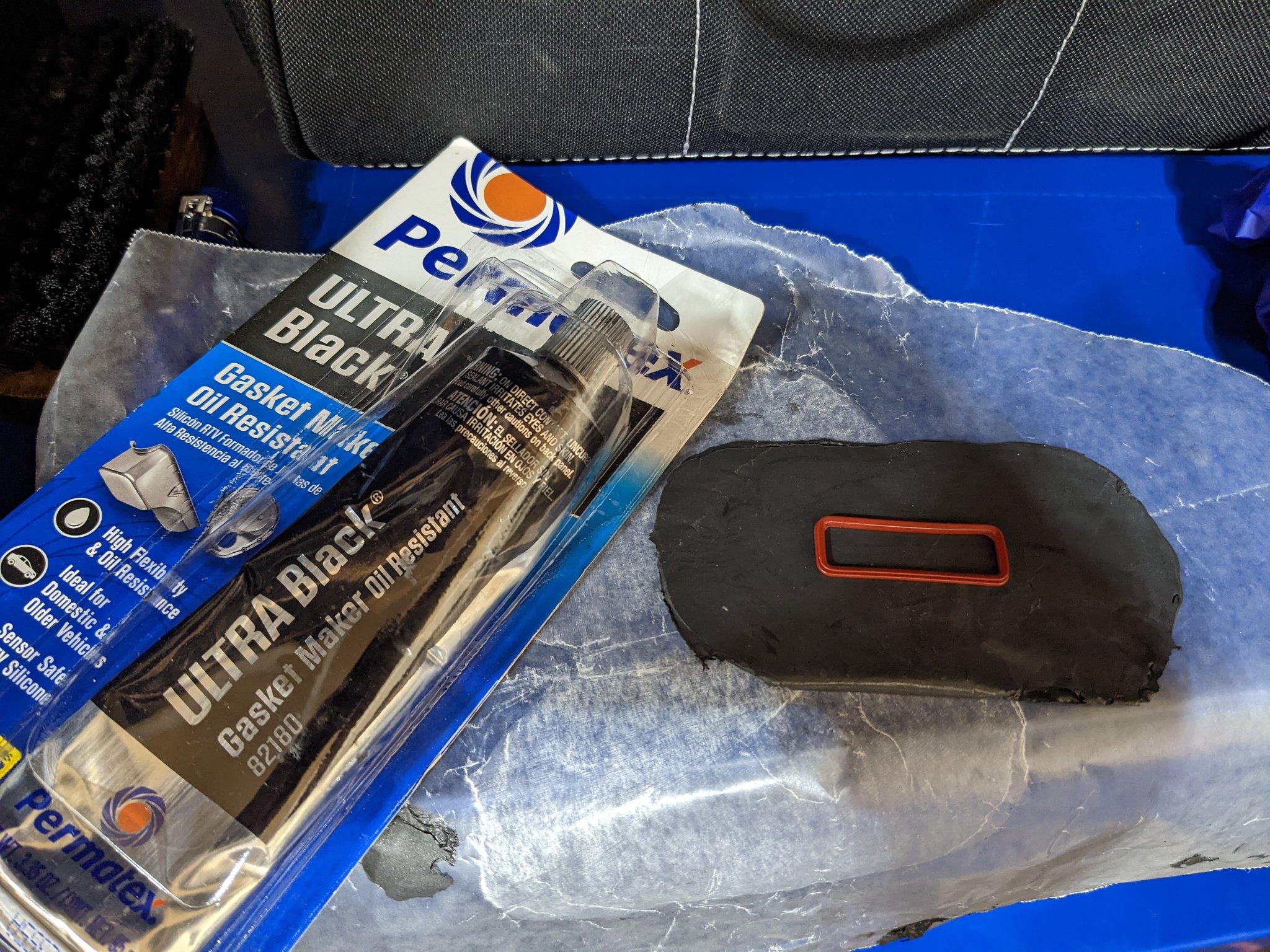

I had some gasket maker paste laying around from a Maintenace job I did on another car. I spread it on Wax cooking paper and tried to flatten it to 0.055", but after 24 hour drying time it came to 1/16. No matter, even at that thickness, I was easily able to stencil it out, put it on the sensor and tighten it down. I performed the glove test again, blew into the vacuum line; no more leaks and happy with the results.

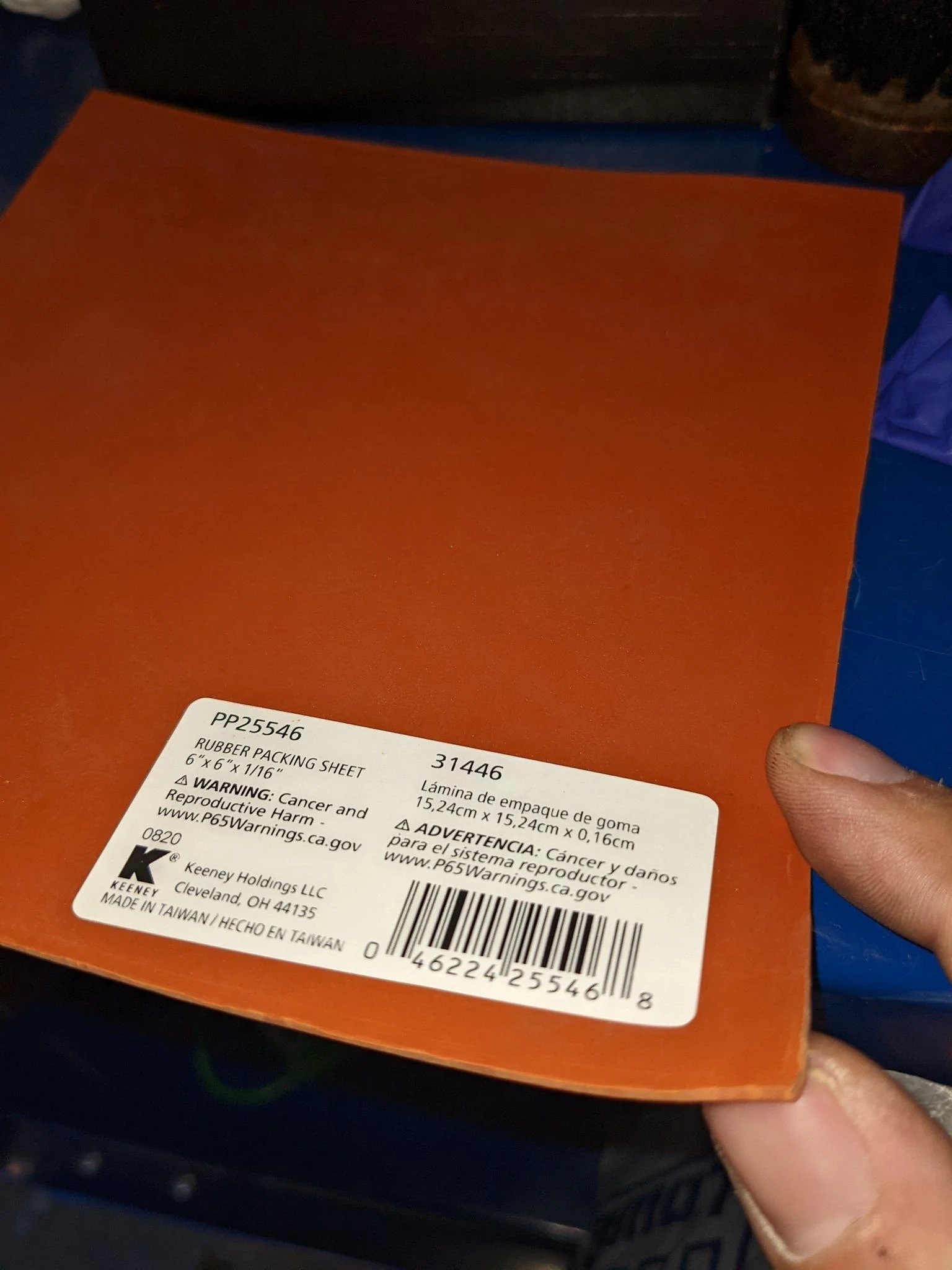

I had purchased a rubber washer gasket maker from Lowes for under $3 as a backup plan ( Keeney 6-in Rubber Washer at Lowes -- it's hard to locate it in stores, look for it in the faucet\toilet repair area), but since my method above worked, I didn't end up using it. Figured I'd mention it for others looking for a quick and easy solution.
