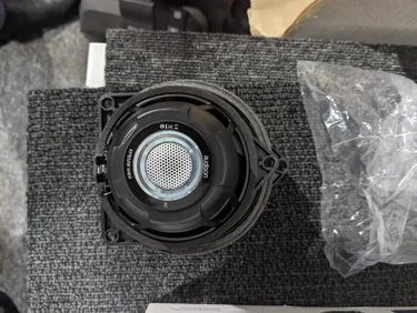

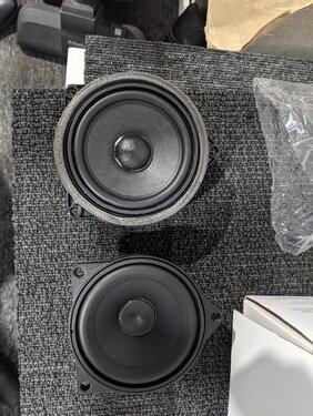

Here is a picture I took of my fronts OEM compared to the "M's"
The holes don't line up
The rears I am certain are the same but I am not sure
I have ordered the "E's" not sure when they will get to me.

Thats interesting.
If you look at the bavsound speakers even the image shows different speakers front and rear.
https://www.bavsound.com/products/b...MItP71lOq28AIVCyCtBh1eJw5GEAQYASABEgJ7o_D_BwE
Edit: I just watched the Bavsound GR Supra install video closely. The speakers are different front and rear.
It looks like the K4M's (smaller basket) you have are correct, they just fit in the rears and the K4E's (large basket) that you ordered should work. I had it backwards myself.

I hope the ones I ordered are correct??
The pictures that I took shows the two holes line up perfectly but the top hole is off. The picture was with the OEM door speakers. I have not at this stage bothered with the rears. Rears are just for fill. You could get away with keeping them stock and it's a huge cost to replace those with little gain. iMO. They hardly work now with the JBL system. I will connect them if I pull the trigger on the mobridge amplifier..who knows I may get excited and replace them. Not sure about centre speaker yet either. They all supposed to match in theory.
I just hope the "E's" are correct because the "M's" don't fit.
