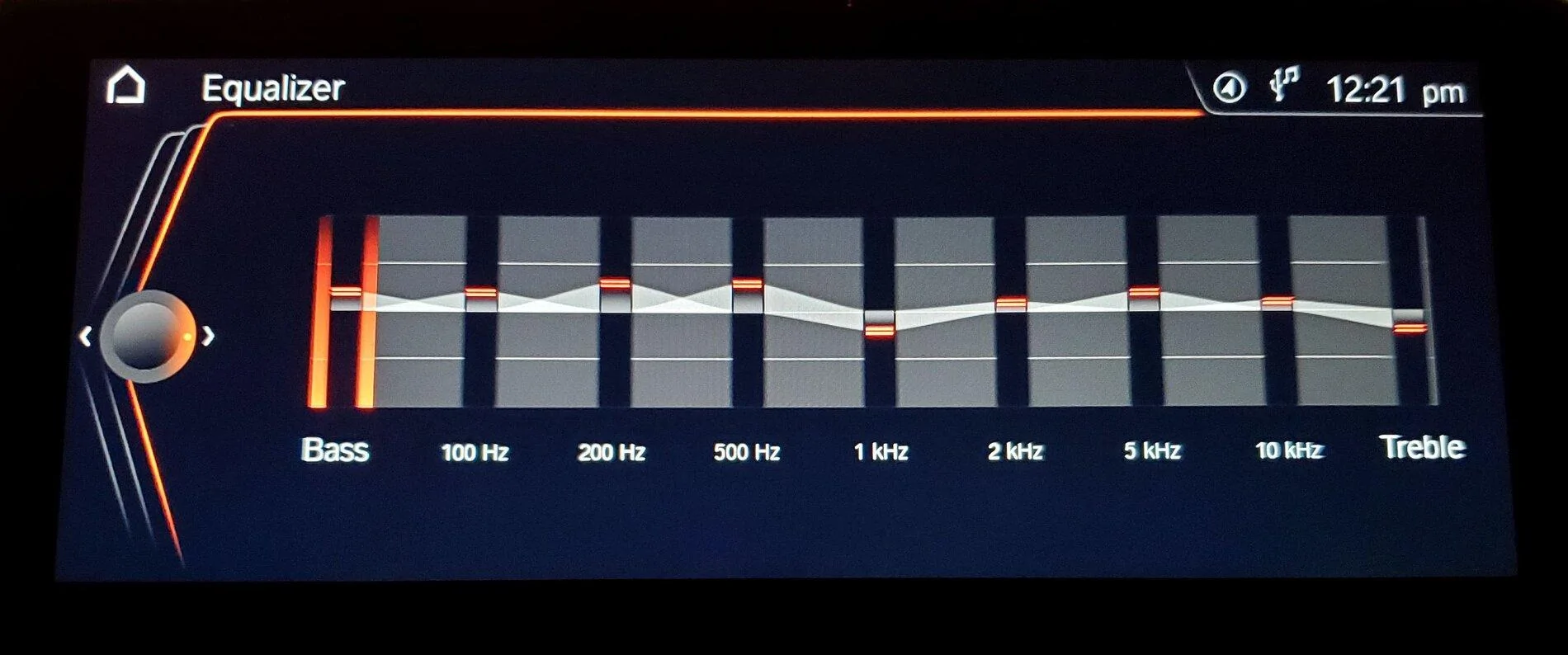

  • Equalizer (shown below)

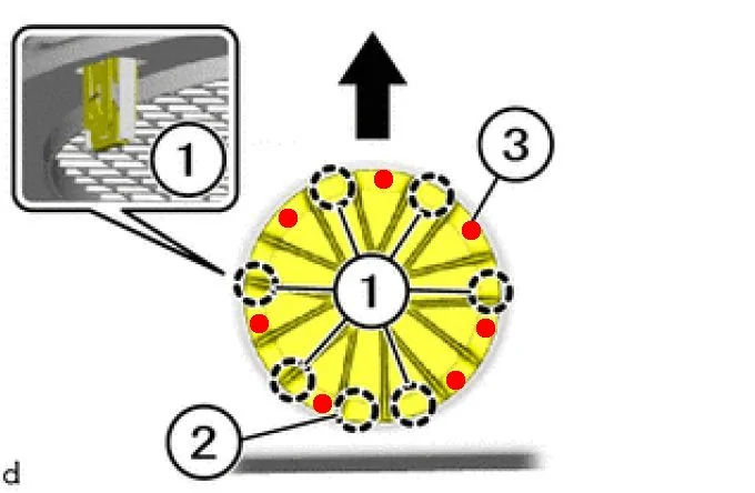

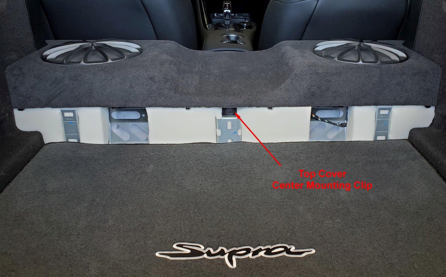

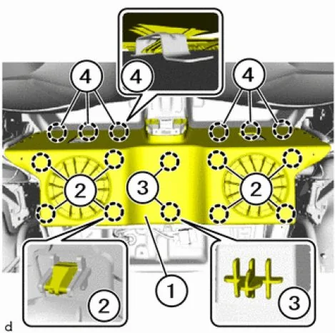

1) With the removal of the center bracket (shown below) that you decided to remove in your setup you also eliminated a key mount point of the center top cover which holds it down securely against the 8 subwoofer enclosure clips...
Without this mounting point secured the top cover will vibrate particularly around the 8 mounting clips (#2) under the top cover that secure the woofer enclosures tightly against the top cover as shown in the shop drawing below....

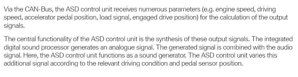

4) Have you disabled Active Sound Design (ASD) which injects a engine noise overlay signal onto the audio signal channels and creates quite a bit of distortion and muddies bass response....
Thanks Tadda,
I remounted the original speaker grills but placed felt between the plastic rings and yes I now have zero vibration there. The design looks cheap.
Your point about the wadding is interesting I don't feel like pulling everything apart again to get this wadding to lie flat against the walls as its impossible to do this from the front ports.
So perhaps the thumping which I thought was excursion was actually the top section moving due to not having that central support clip?
Now that everything is back together in its original form but with foam, felt and sound deadening everywhere the whole area is solid enough and vibration free with the original slim panel without ventilation and its works perfectly.

Thanks Tadda,
I was able to feed the wadding through one of the three elongated ports and then manipulate the wadding into place against the walls using a long thin screw driver or long pic tool...You can also pull it back out from the front in the same manner...Stuffing that enclosure can have a negative effect on sound quality and will reduce bass response if not done correctly....
This very well could have been the case...

In regards to the ASD I have not disabled this yet? does it really make a big difference? I have the Aussie version of the Supra and the exhaust is almost as quiet as a Toyota Camry. I can barely hear the ASD? I am about to fit a AWE exhaust system however I am not sure the ASD is even effective or barely audible?
Absolutely Yes...Most of us that have disabled ASD notice a big difference in sound quality...Think of it this way, overlaying synthesized exhaust noise onto the audio signal doesn't improve the sound quality and actually distorts it quite a bit...

May I ask does ASD make such a difference to the engine note or is it so subtle and barely audible it wasnt worth Toyota adding it in the first place?
ASD isn't connected to your exhaust system and does not change external exhaust sound in any way...ASD is simply an electrical sound generator which overlays a faux engine sound on top of the audio signal inside the cabin...
Those of us that have removed ASD have noticed a significant improvement in audio clarity...

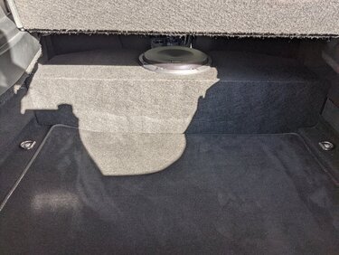

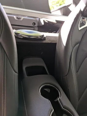

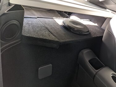

Made some decisions on my audio system and commenced some work
So far to keep weight down and simplify the installation somewhat I decided to go with the following.
I am somewhat hoping a single sub and two door speakers will be enough. If not I will buy another 10 inch subwoofer and also add the additional two speakers behind the seats.
So the centre channel and the rear speakers will be disconnected for now.
Components are:
DA-G2.PRO MOST25 - Take out the OEM amplifier and simply plug this unit in, in its place and you can run any amplifier you like, set time alignment, dsp 10 channel analogue out fibre out.
https://mobridge.us/product/da-g2-pro-most25/
amplifier yet to be determined I have a 4 channel Alpine I want to try first.
Single 10 inch Audioson Subwoofer - APS10D
https://www.audison.eu/products/aps-10-d/
Door Speakers - MUSWAY CSB4.2C BMW
https://www.sound-tech.com.au/csb4-2c/
So I have removed the entire rear OEM subwoofer section built a shallow (to spec) box for the 10 inch subwoofer.
Used rubber backed boot carpet for behind the seats trying to keep the weight down(not use timber). Cut to size it magnetically attaches to the subwoofer box to hold it perfectly in place and can be removed in seconds.
Made carpeted covered foam inserts to fill in the sides.
Made a panel in the trunk that magnetically attaches to the sub box and original metal brackets
It can all be pulled apart in seconds if need be.
I have not installed the electronics yet.
I think the weight would be similar to OEM.
Next week I will start the wiring and connection.
I am driving around only playing through the front, rear and centre channel as the OEM subwoofers have been removed.
I did not want to take up any more room the height is marginally taller than OEM. 1 inch
Its solid no rattles and creaks infact it eliminated some noise I would hear from time to time in the rear when going over certain bumps.

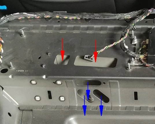

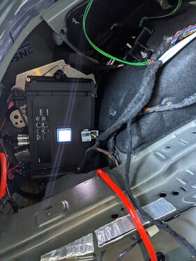

GO Mobridge. I can vouch for them from my expereince. Latest firmware works perfectly and its plug and play.
I installed the pro preamp. https://mobridge.us/product/da-g2-pro-most25/
10 channels preamp outputs. You have full control of the output.
Channel mixing for centre and subwoofer, output level control for level matching each speaker.
main output level control. Time alignment, crossover points, slope, you can adjust the frequency curve to boost or lower output in certain freqencies. Just about everything you need to fix the signal. Also the phone, NAV, warning chimes levels can be adjusted and you set which speaker you want to play them out of or all speakers.
You simply remove the existing OEM amplifier and ASD module and plug the fibre optic cable into this small light mobridge unit, plug in your PC and set it up very easy and quick.
The mobridge unit slides under the bracket where the ASD unit fitted.
I did not cut a single wire and can return this to stock.
Currently I am running a single 10 inch Audison Sub and two cheap Kicker coaxials in the doors all driven off a cheap Alpine 4 channel amplifier. This simple cheap system was a trial run before I spent more on components however it sounds far superior to the OEM in all areas and is far louder. TBH I could leave it as is, its that good. Essentially thee speakers.
I am also keen to move to Mobridge Amplifier add another 10 inch sub if it fits and run wires to the doors for a full active system controlled by the mobridge software.
Here is the Alpine amplifier and Mobridge hidden behind the left panel in the trunk.
