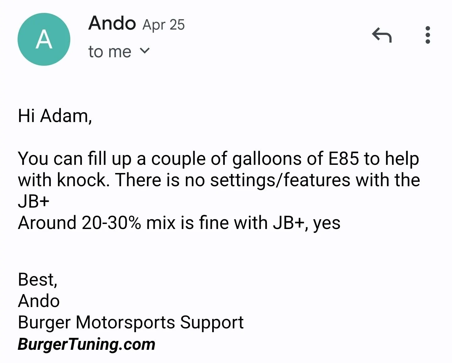

First hit with the JB+ caught me off guard. Way faster than I was expecting too. I am going to try mixing in some ethanol this week, as BMS told me 2-3 gallons E85 is fine with JB+.
Some M340 guys found power gains that way.
Have a read: https://g20.bimmerpost.com/forums/showthread.php?t=1881902 (TLDR: JB+ M340 handled up to ~E40 without any errors, so stay at E30ish to be safe)

First hit with the JB+ caught me off guard. Way faster than I was expecting too. I am going to try mixing in some ethanol this week, as BMS told me 2-3 gallons E85 is fine with JB+. Some M340 guys found power gains that way.

I’m scared to mix e85 since I have no experience with it. Can our fuel system handle it?
As far as I know, the stock fueling (with stock turbo) can handle up to E50 no problem when flash tuned for it.
Essentially, your car's ECU has a range of fuel flow that is acceptable within its pre-defined OEM limits. When you flash your car, those limits are adjusted. A JB+ is not a flash, so it still uses OEM limits. Though the B58 fuel pumps can handle more ethanol, putting more than 30% will likely trigger a fuel trim error by exceeding the OEM limits.
Hope that makes sense. If it makes you feel any better, there are some countries that have E30 fuel by default (I believe Brazil is one of them). Just try doing 2 gallons E85 to start and fill the rest with 91/93. It really takes very little ethanol to improve octane/reduce timing corrections.
