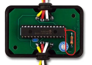

Supra Specific version, where your resistor is mine had another chip, this is after I lowered the dial:

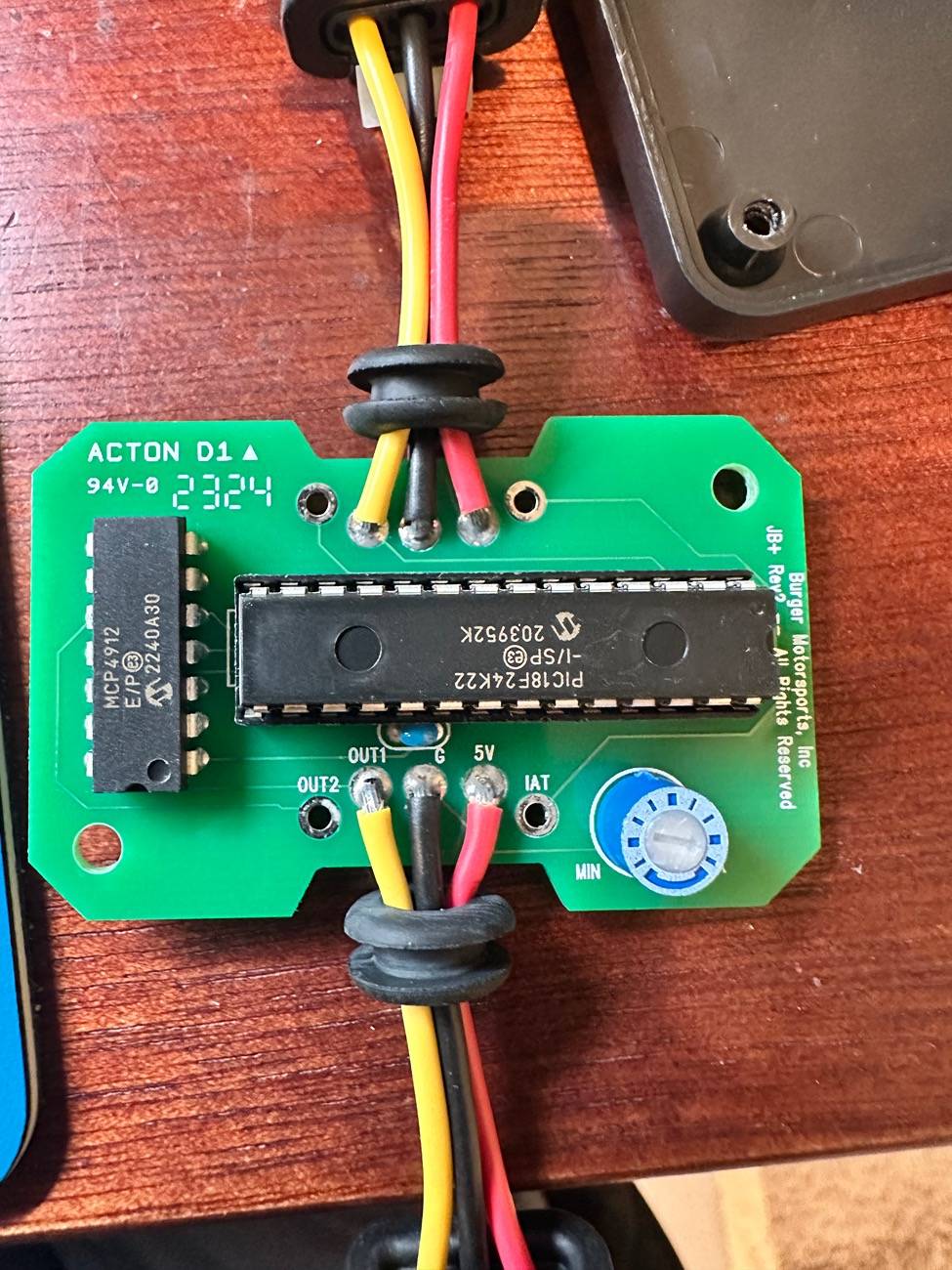

So I ordered one and got one where there is no resistor and it has a chip. Is this the incorrect one?
Edit to add: emailed Burger, they said it’s correct.
Just installed it, let it warm up driving around, then gave it the beans. No CEL, and a good amount of power! Definitely breaking much more traction than before, and even rolling in 3rd it’s got a fair amount of power added. I have an AA catted dp and power felt smooth.
It came in the max setting, but since I only have 91, turned it down to 3 pm.

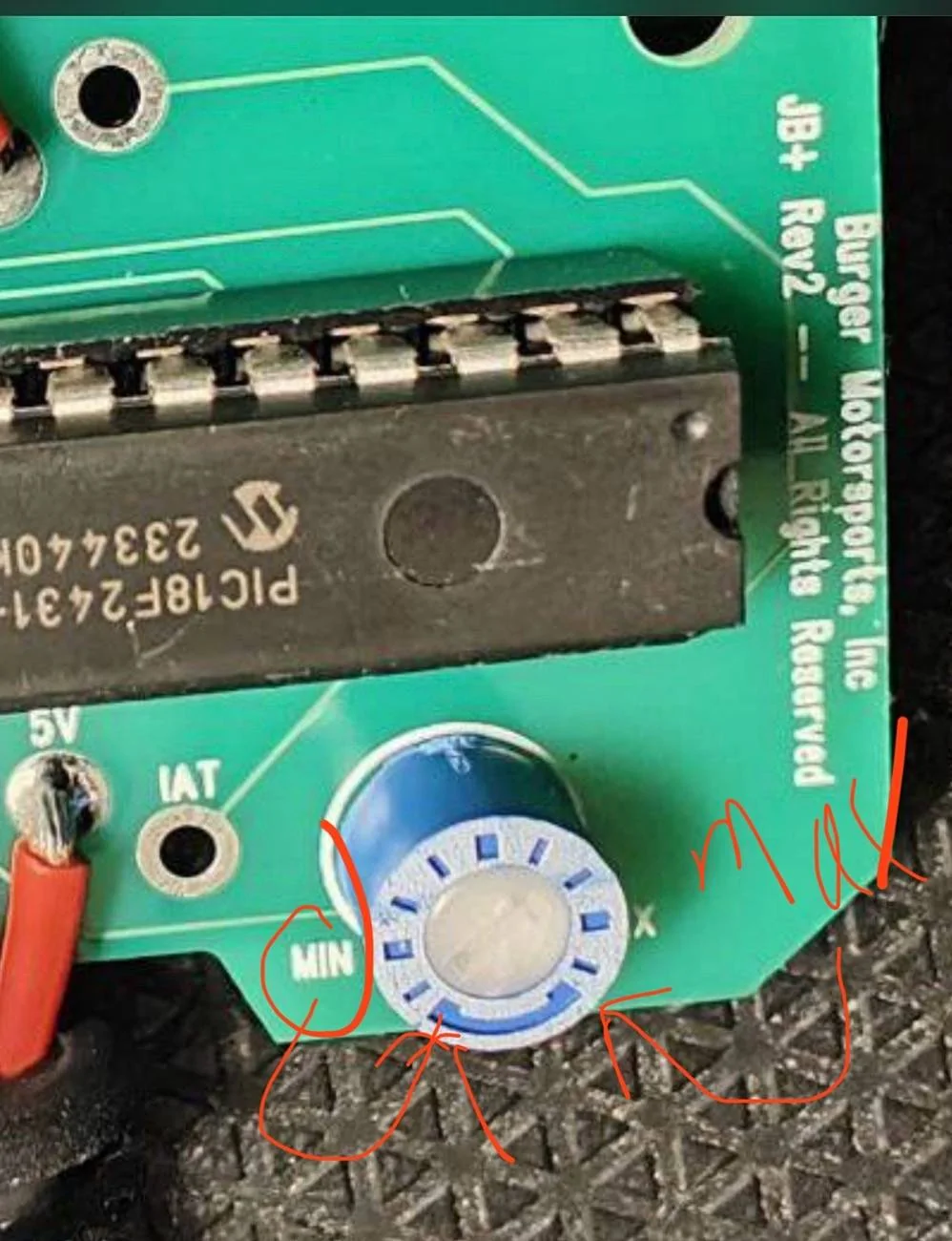

I ran mine on max the entire time I owned it. I clarified with BT when I ordered it. The difference in “3PM” and “Max setting” was the need to make sure you are running 93 and not 91. So if you have 93 max it out if 91 I’d stay in the 3PM setting. It’s 3lbs boost vs 4.5lbs according to what BT told me.
It’s a good affordable device but eventually you’ll want to tune the car, it’s cool but when you finally step up to the tuning it’s a whole new car. Good thing is there’s always someone to pass yours on to and to move to the next step of your hearts desires.
Pic with arrows of min and max for anyone new, just make sure to not exceed the max area as you can damage the device.
the blue thing is the resistor, its set to 3pm if you notice
You're all good, you wouldn't know there is an issue till you run it, the resistor not being there was just a hardware revision. The real issue is it was programmed with the from firmware from the factory and they resolved that.
I was referring to the resistor I circled in red. We have a newer revision (2.1+) that doesn't have that there anymore.
