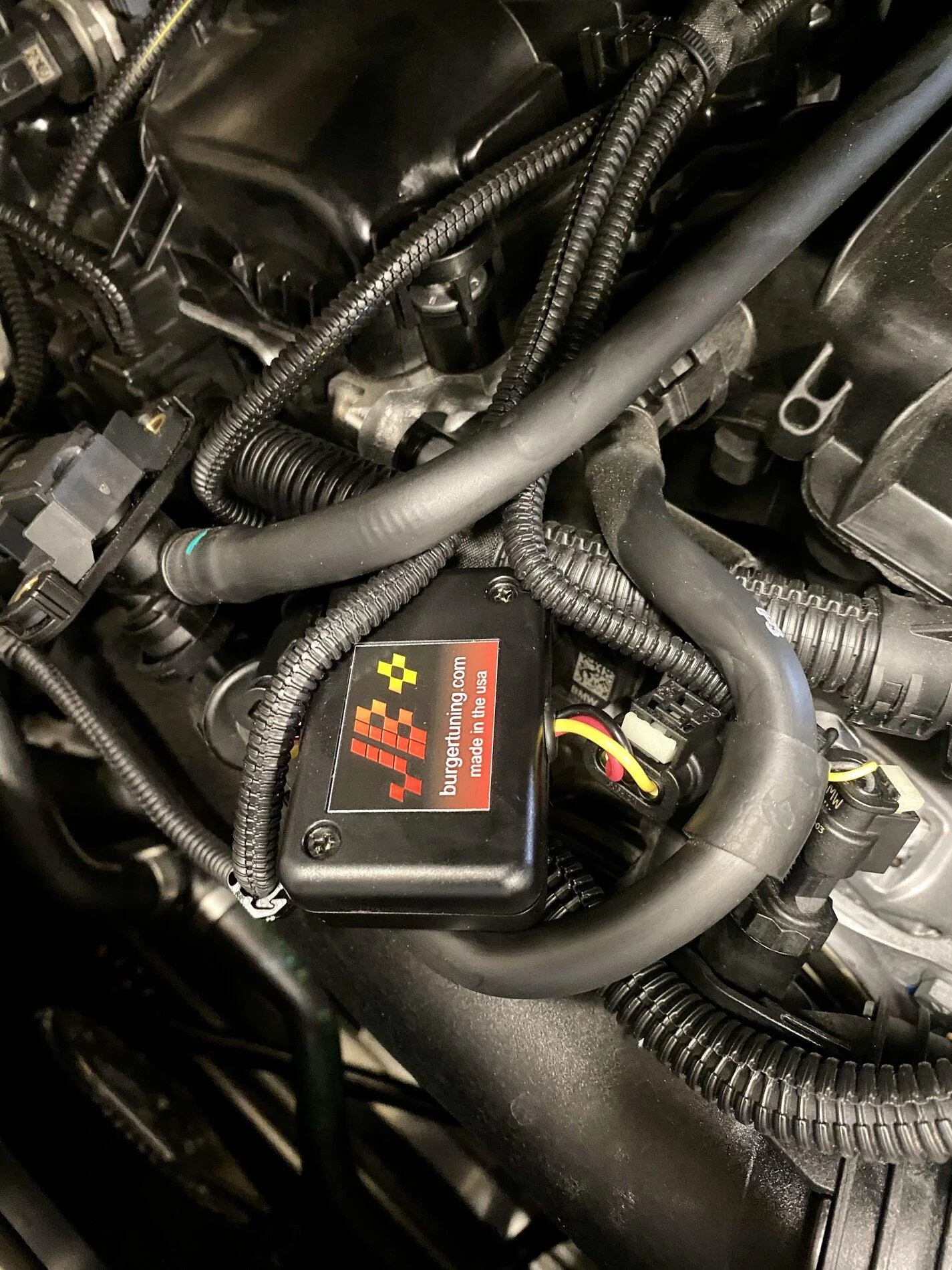

Does anyone have any tips to get the cable off the tmap sensor before putting the JB+ on?
Having a really tough time removing the cable even with the white latch unclipped properly

Well after starting this thread... I have finally given in now that I’m over 1500 miles. Appears the hiccups are no longer. Installed today.
Unfortunately I have a ‘rain delay’ for my test drive. ?
Did you happen to have a hard time getting the stock plug off? Any tips to removing it?
Yes, it took a little elbow grease. Be careful, there is a video online that tells you to remove the wrong one and I was struggling with that one first, then figured it could not be that hard and looked up a different video and realized it was the wrong plug, but they look exactly alike.

This is a pic off of the JB+ install guide that I've drawn on. Pull the #1 tab out. Squeeze #1 down and pull the connector off gently while lightly sticking the pick tool in between the male and female connectors at #2. It came off VERY easily. Don't try to force anything.
You actually are a saint, this method is how i got mine installed just now, took way less time.
It's currently on around 3-3.5 psi setting based on each 'pip' being .5 psi
Thanks!
I ended up using the pick tool method and it was a world easier to install
