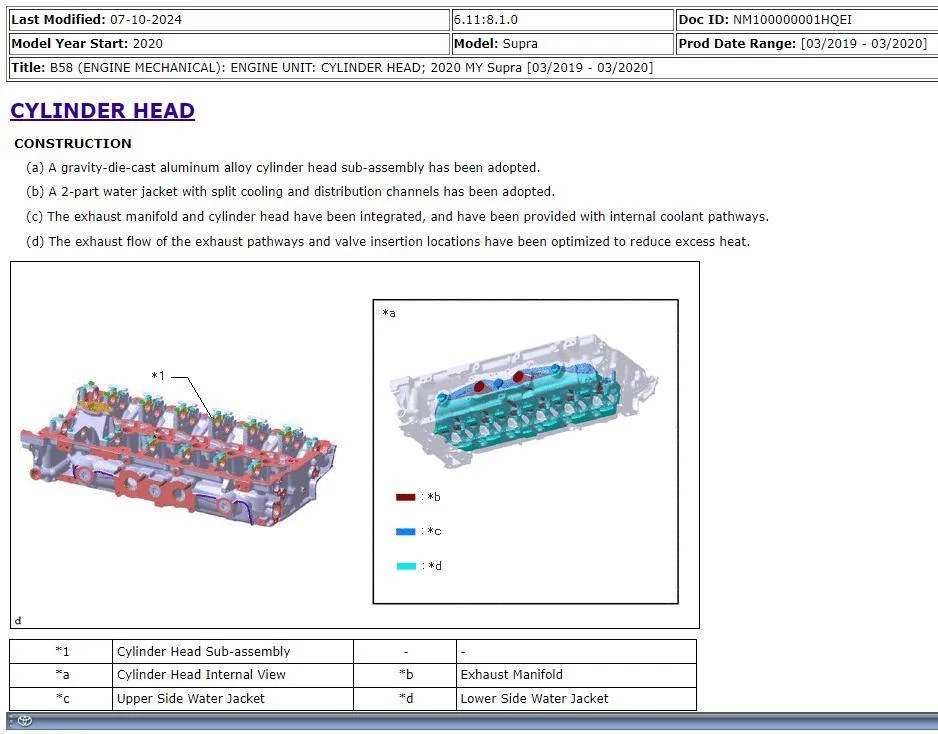

I could see this happening

Looks like catless downpipe and MHD tune.
-RJM
Yea, OP went catless and MHD after knowing and “resolving” the coolant problem. The car was bought with 69k miles, wonder if OP know any mods history prior to that
