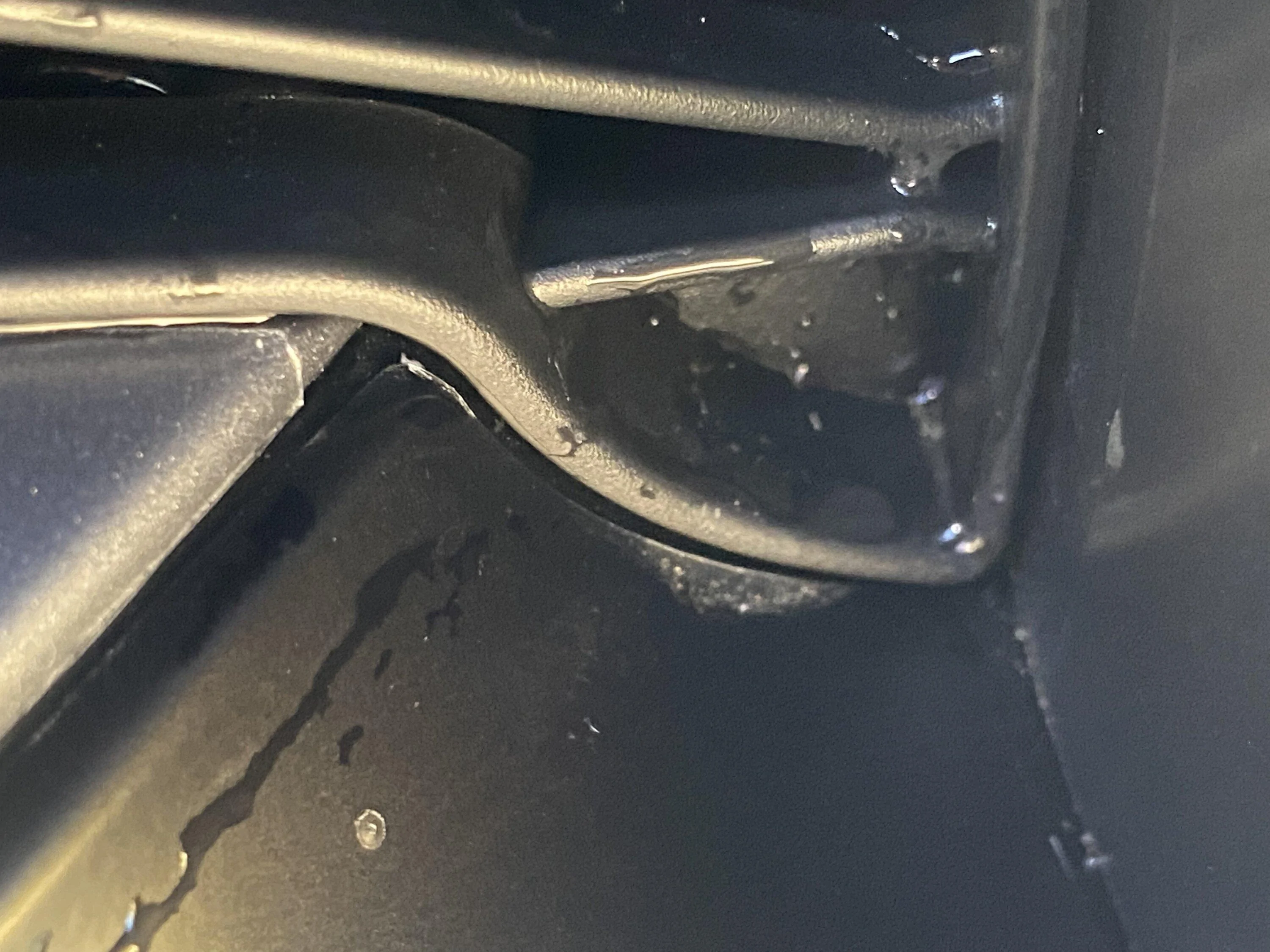

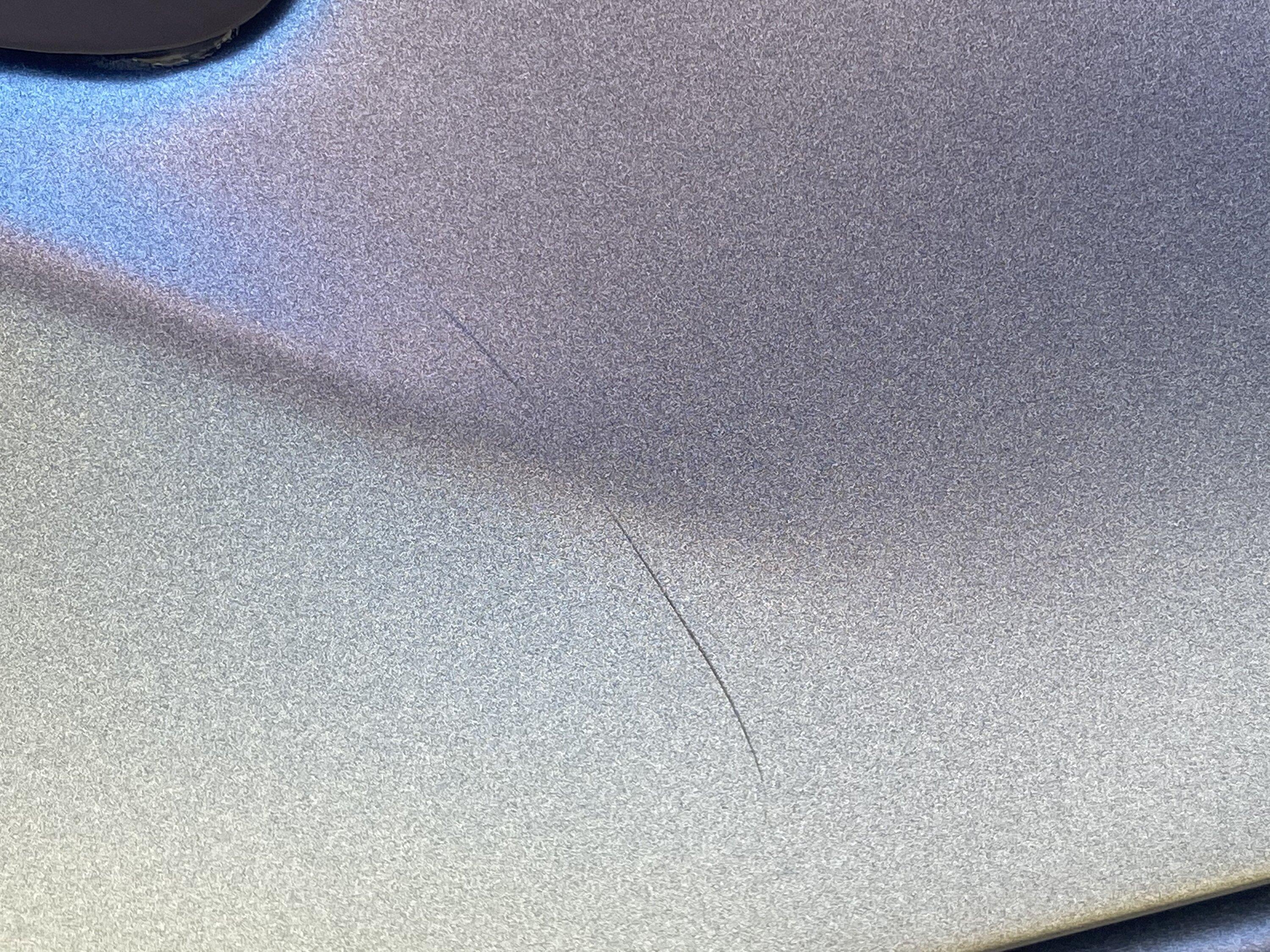

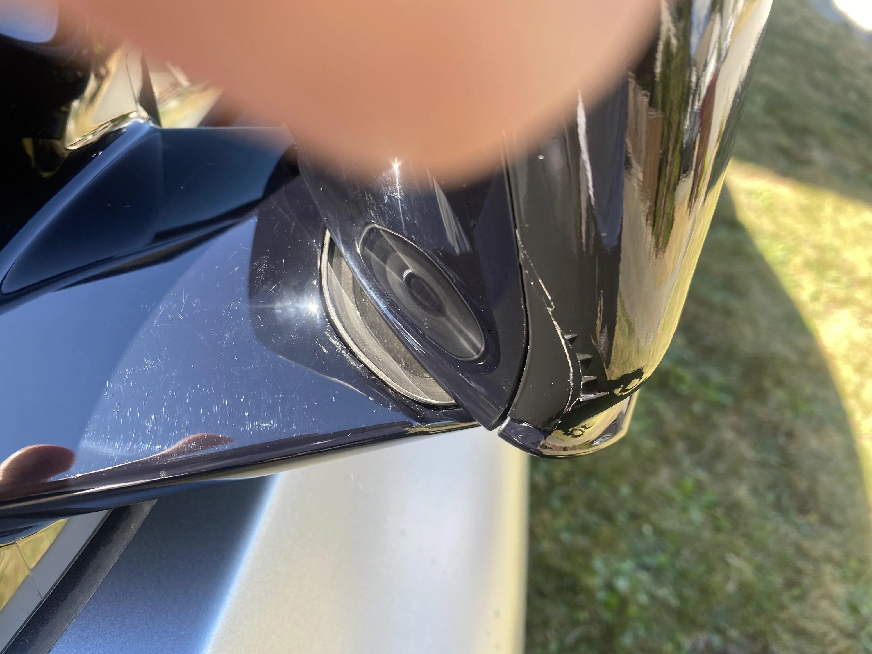

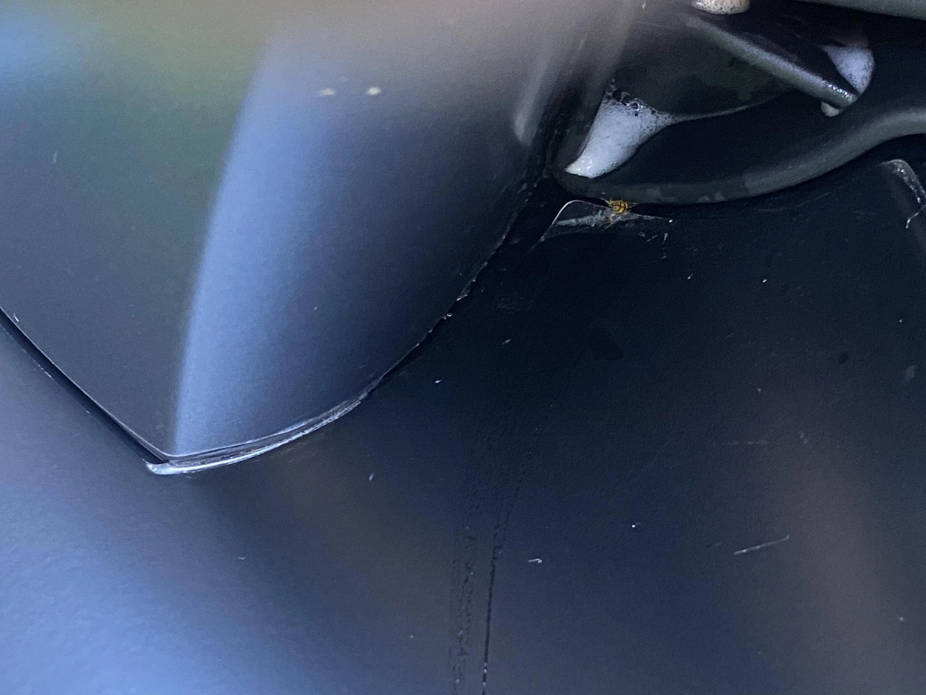

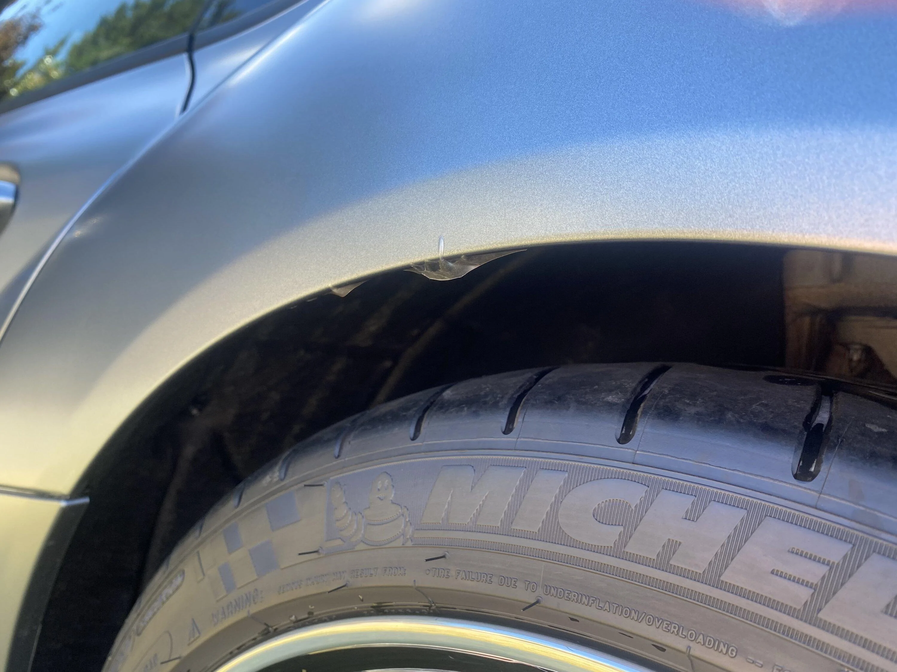

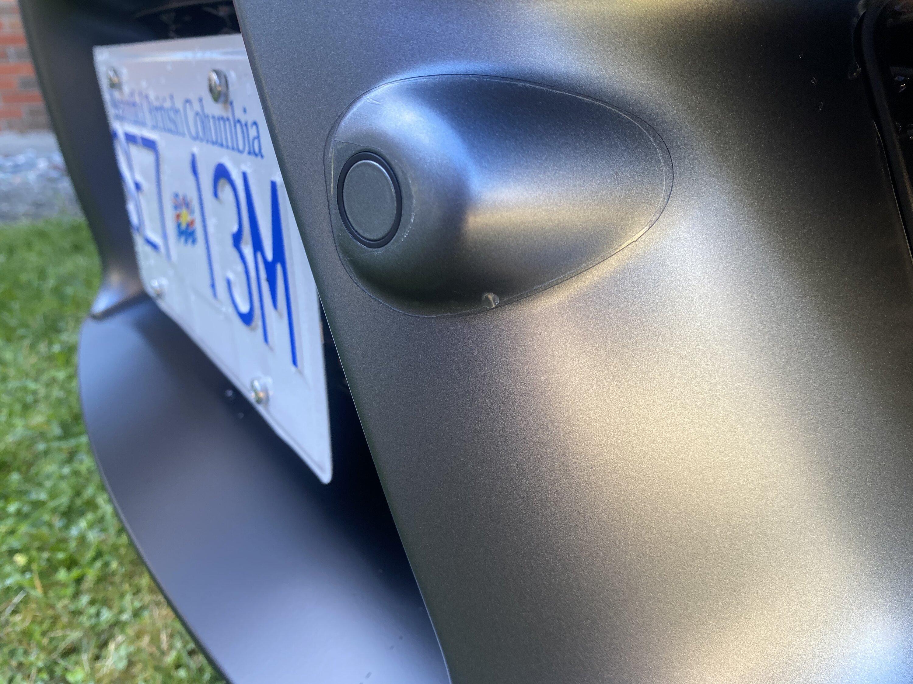

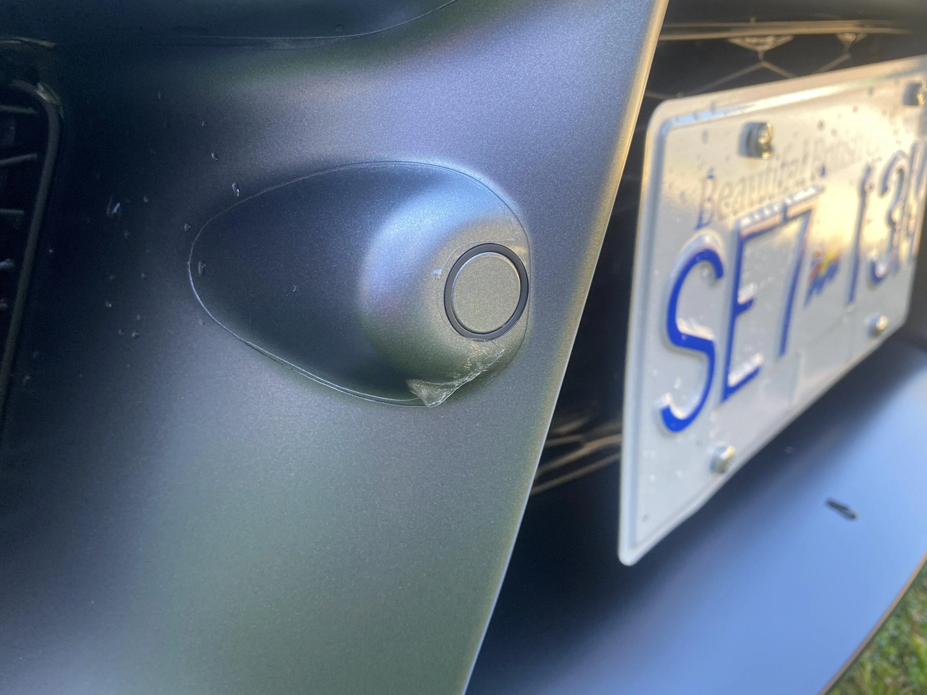

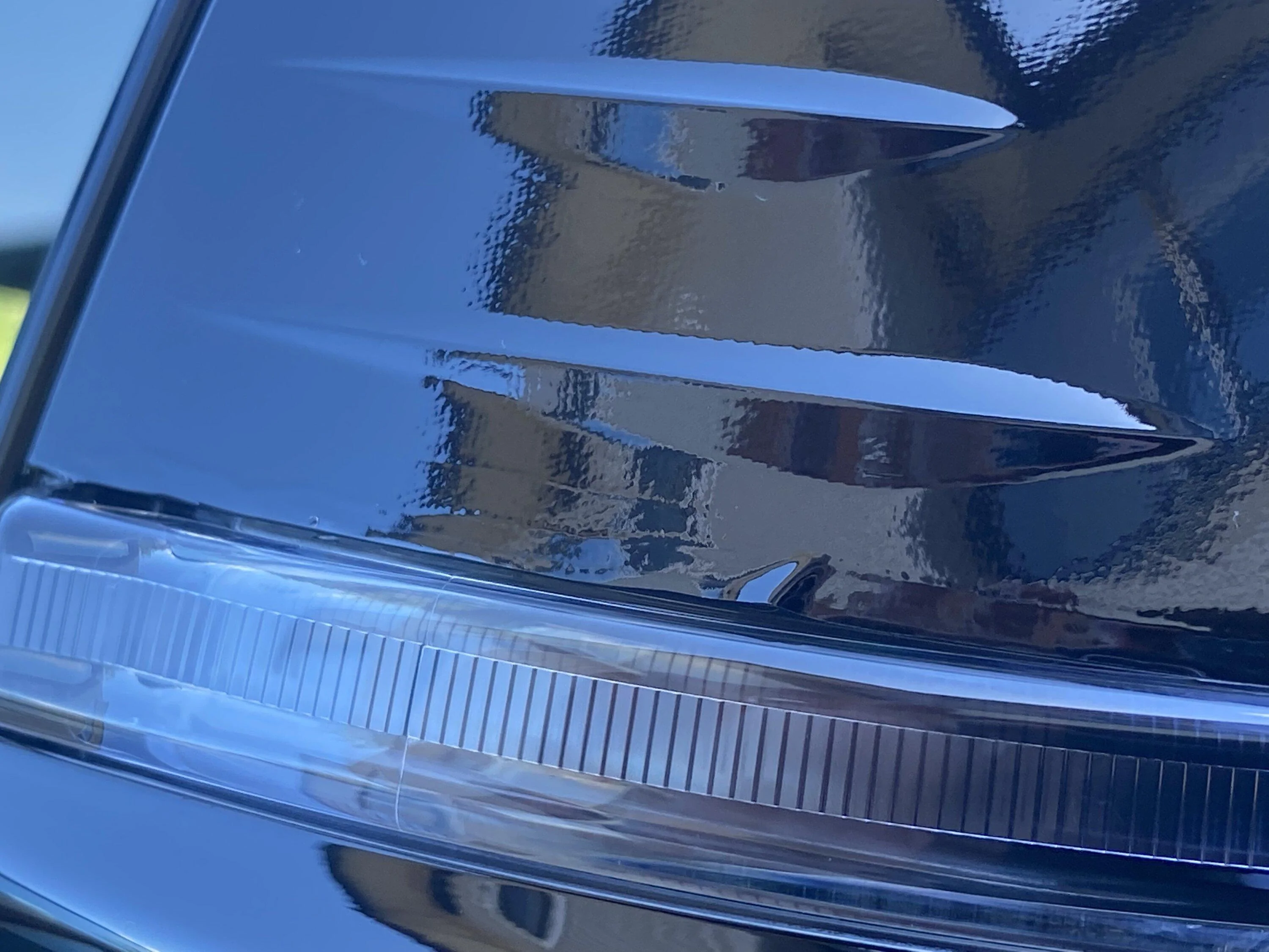

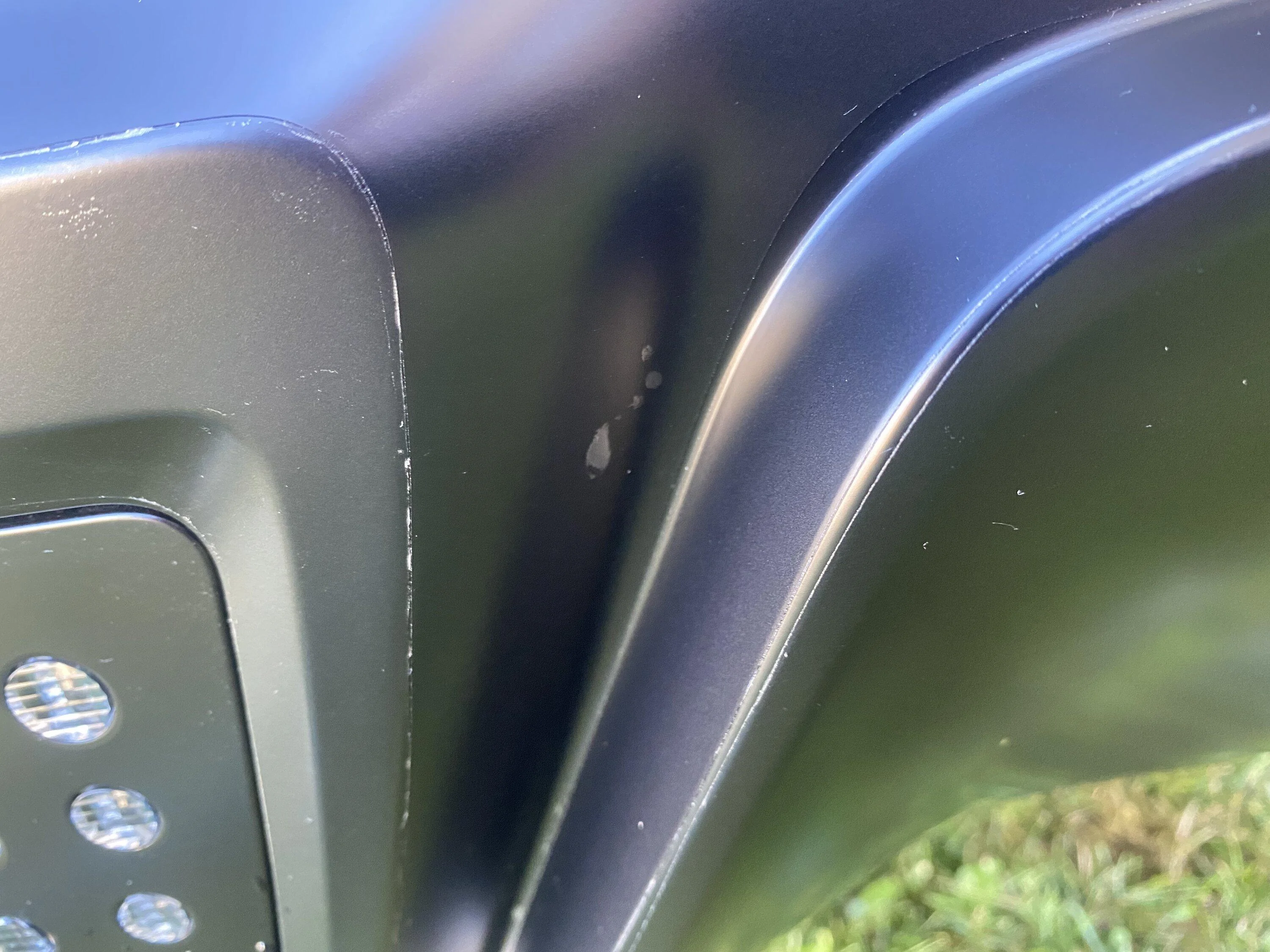

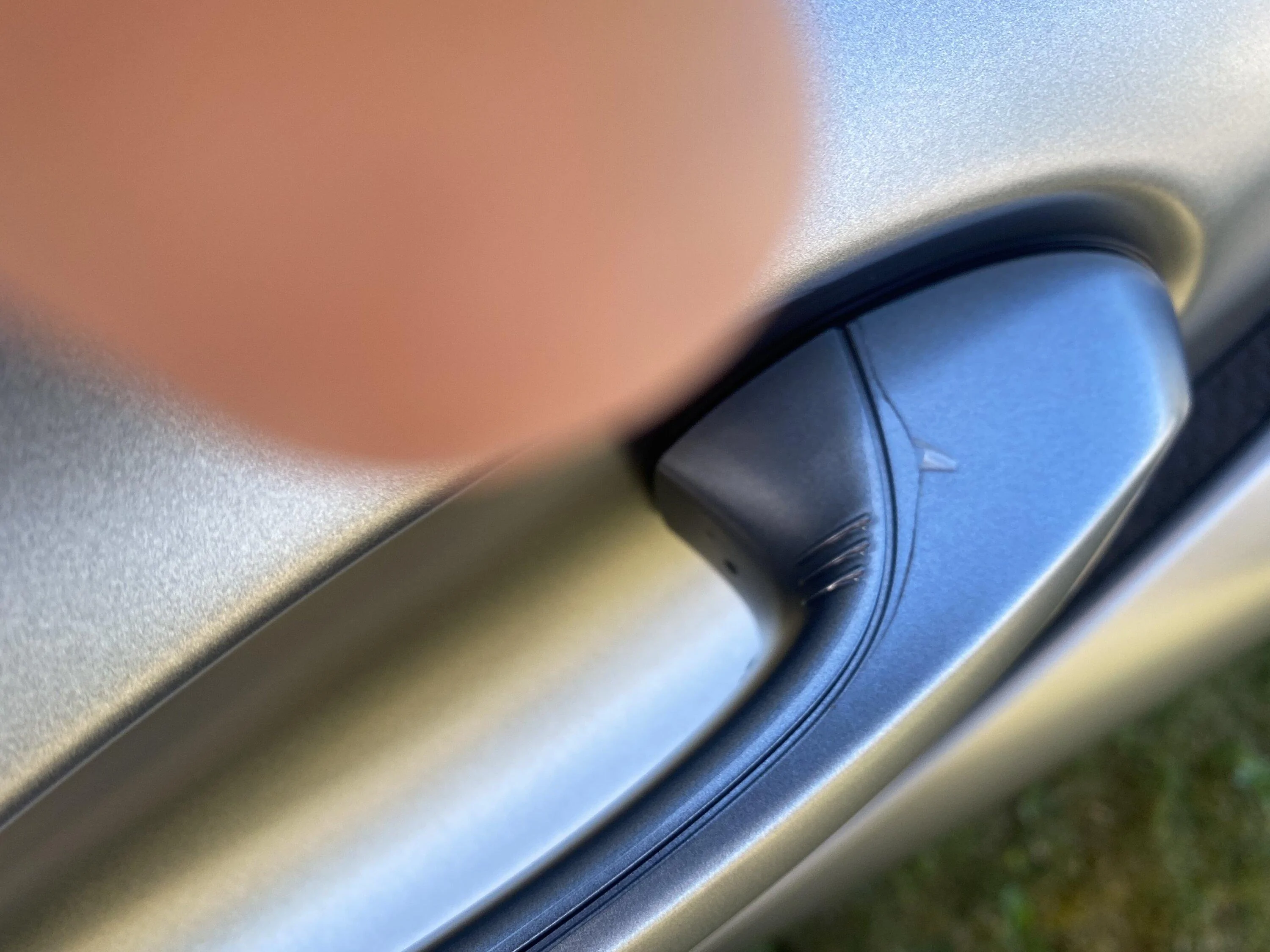

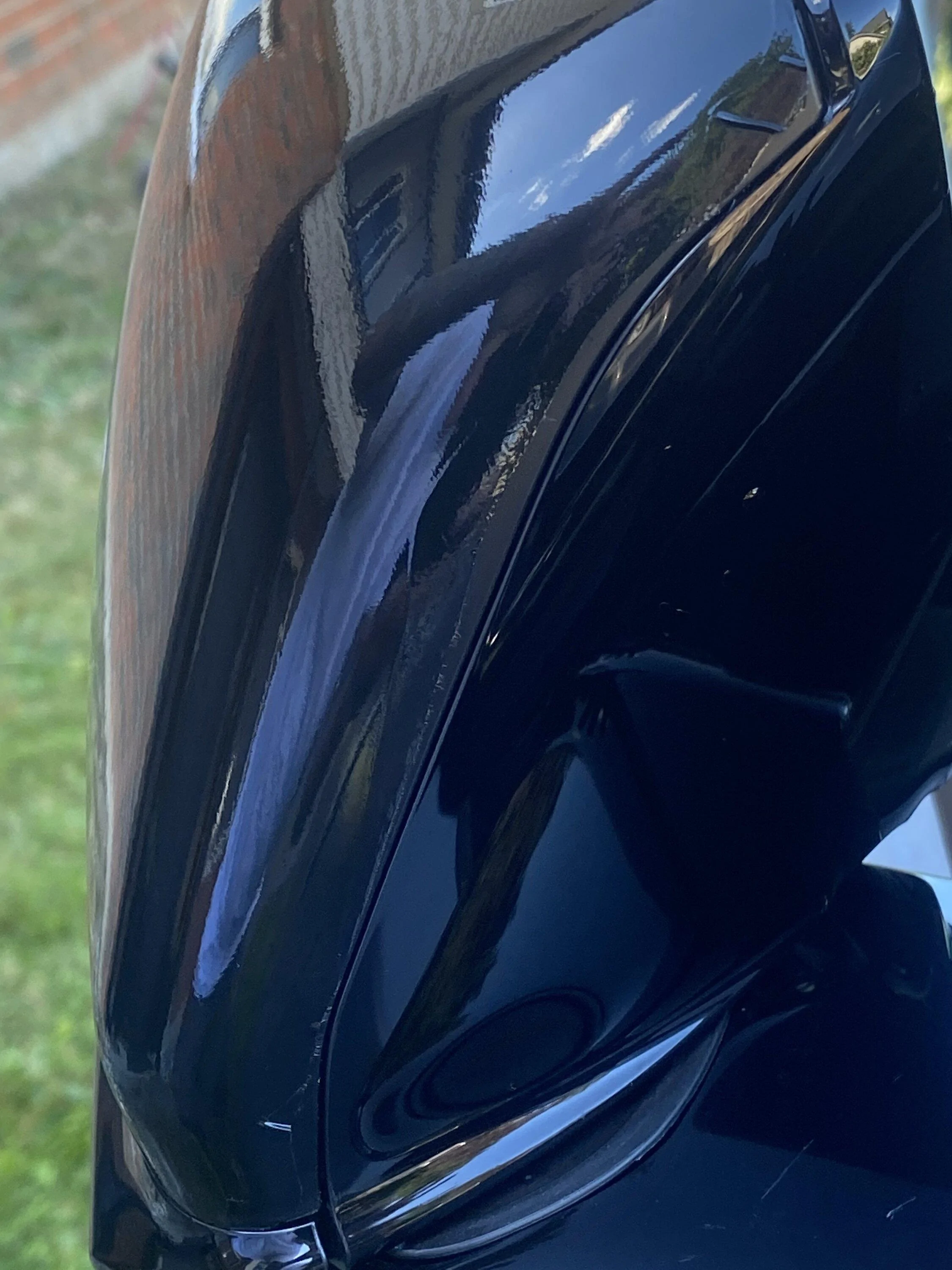

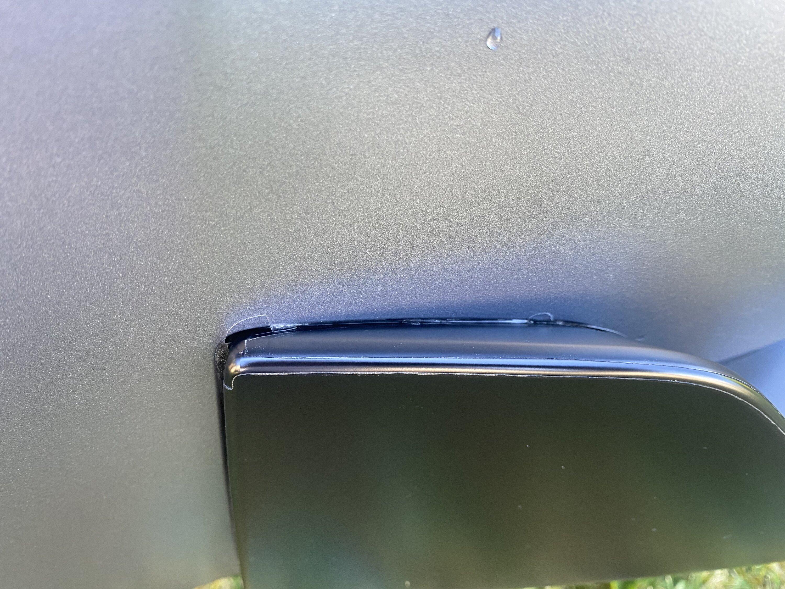

Had this done a few weeks ago and all these things are killing me..Am I being overly picky or is my concerns valid.What would you do ? Sorry for the photo dump and this isn’t all of it.The ceramic coating also hasnt been applied correctly and they are saying that there just gonna put another coat on top of it. Soap won’t even bead of it smoothly and is sticking to the film.Are these simple fixes or am I just going crazy ..lol
Dude, that is complete trash work. Get your money back and run away. I do my own paint correction and ceramic coatings. Because I have trust issues.

Run that chargeback and let us know the shop, i'll gladly hose their google reviews haha. I got my 2020 supra the first week these things came out, and I had a local detailer do it. Ceramic coat was on point, my front ppf was 8/10 as he hand cut everything. Few bubble spots in corner but not nearly as bad as yours. I sort of chalked it up to the car being so new to work with. He is going to redo it soon. I also got a pretty good deal on my install. Get your cash back hommie.
