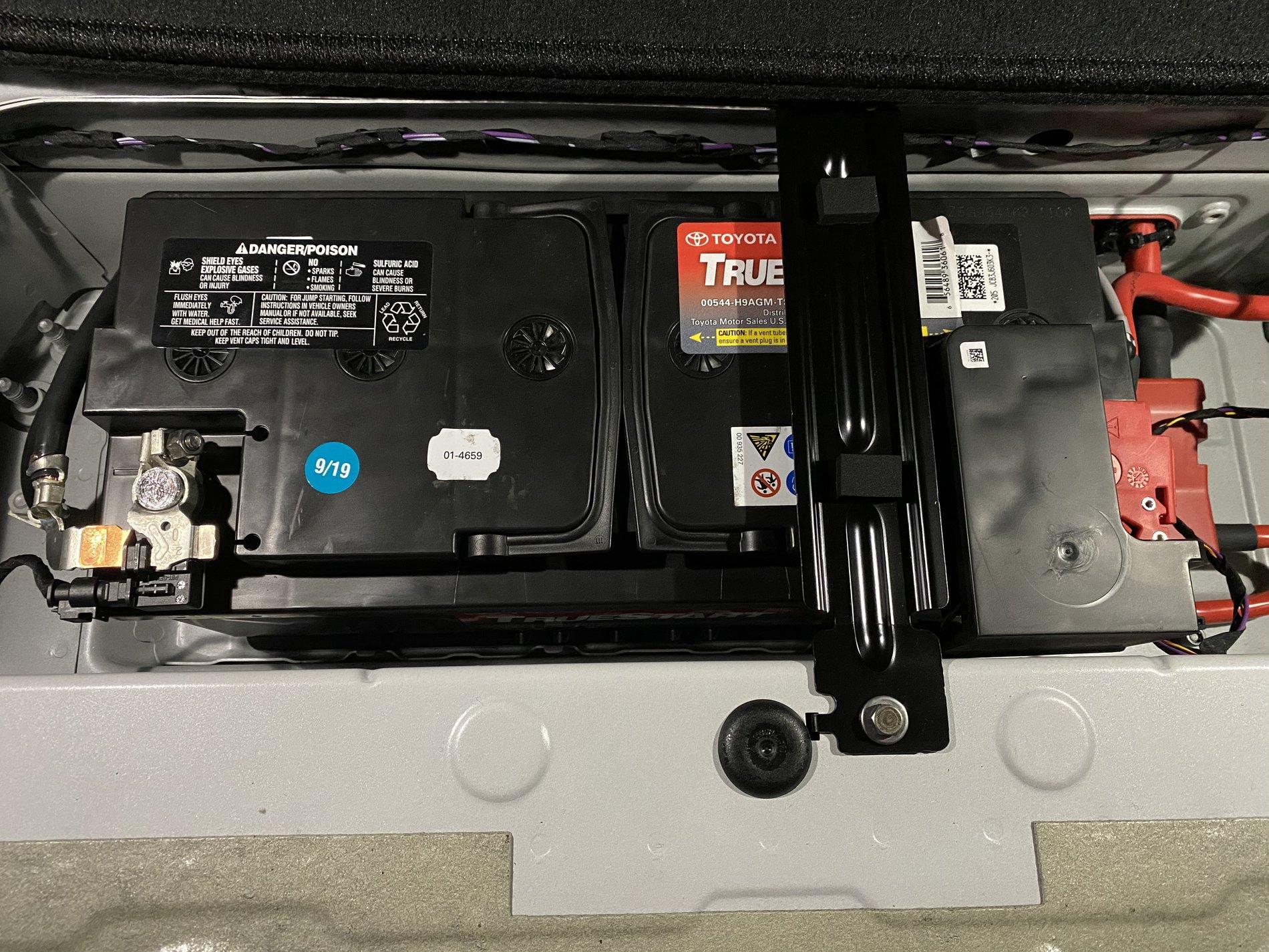

BMW manufactures their own batteries.
Pro tip for those who haven’t experienced them - once they’re dead they can’t be jumped, and you need to replace it with a BMW battery because they have a computer chip that tells the ECU how much charge it has. The cars will pull harder on an older battery to make sure the computer systems have enough juice. This also means the dealer has to install the battery to reset the ECU. Quite costly.
The battery can be recharged if it has drained completely. My previous BMW had sat on the lot so long that the battery had gone dead. The were able to recharge it and it worked fine for the next four years. I also had problems toward the ned of the battery's life. When I had to recharge it from dead again. It was an outside car, so the extremely cold winter didn't help things. I ended up replacing it because it was start to have consistent problems keep enough of a charge. BMW dealers charge between 5 to 600 to replace denpending on the dealer.

Strange... I have a Toyota battery in mine..
Mine is Toyota as well. Likely same battery different label than the other one posted.
Yours was either changed at the dealership or Toyota finally has their own inventory in Austria. It is still a large bastard for a sports car at 90 AH.

If it's not stamped Panasonic, then it's not a Toyota (Primearth) battery :)
