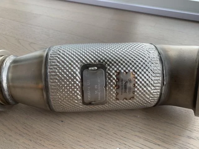

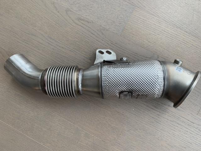

Ended up with the akrapovic, got a decent enough price when I ordered it together with an exhaust. Can't quite figure out which HJS cat it is, besides being one of the HD models, which is clear from the winding.
Nice piece though, just waiting on the exhaust now.
Thats a really nice downpipe :yes:
