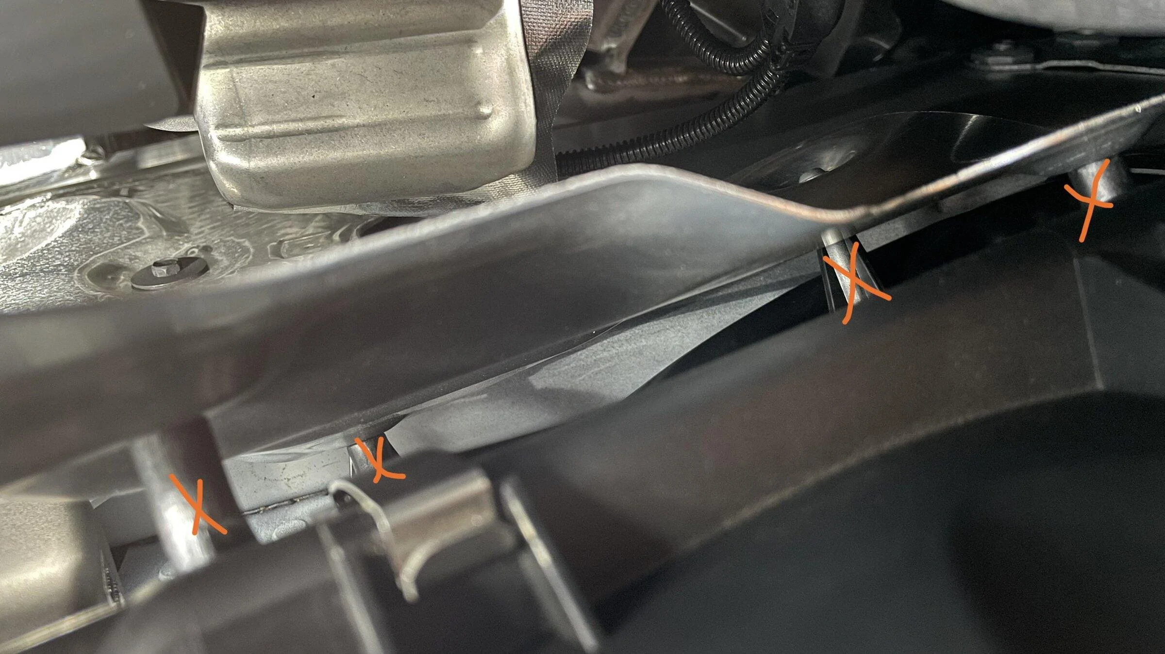

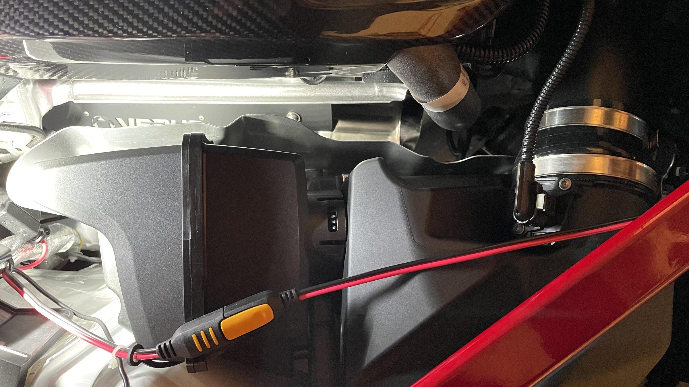

Not sure how helpful they’ll be but here are a few. I started the bending after the 4 screws that attach it to the filter housing.

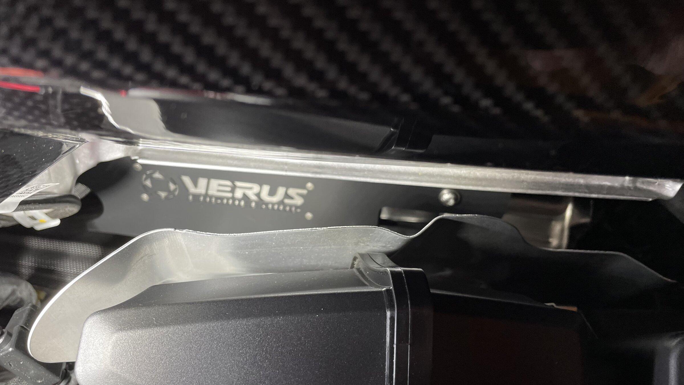

I simply removed it when I installed the Verus shield, put it on the edge of a work table, and starting trial and error. Bend it some, see if it fits back on the intake, bend some more, test fit, too much, bend it back, etc. until it fit back on the stock intake.

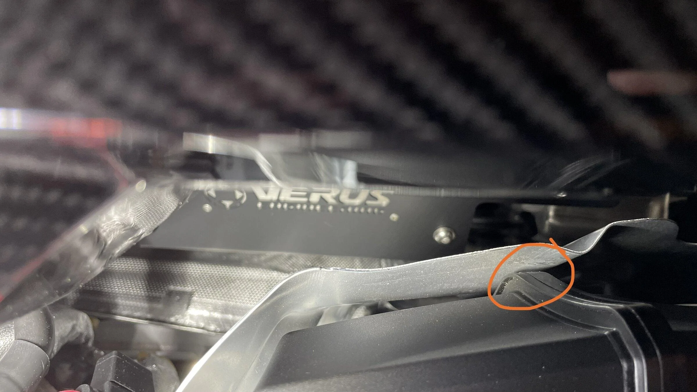

It ended up having to be a little close to this particular spot but it’s not actually touching. Not that it would have made a difference if it did.

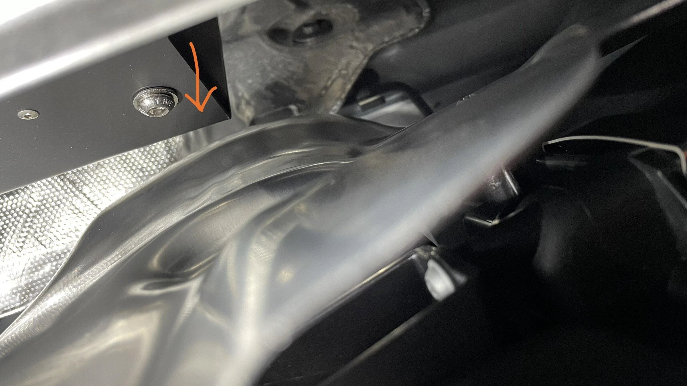

I initially didn’t bend it at all and tried it out. It cleared the Verus shield however barely, but would rub when the engine moved. There’s a little scuff on the front side of the Verus shield at this corner. I don’t think it touches anymore but I’m not certain. If it does I don’t believe it’s much.
I’m very happy how it turned out. Hate that my Verus shield has that scuff simply because I know it’s there. But I’m the only one I know who tried this so how else was I going to figure it out without trying. If anyone else tries this just to state the obvious, don’t try bending it while attached to the intake because it’s plastic. Those screws are in the actual filter housing and not the removable resonator section.

Ha! You know, it's funny, until I looked at these pics I had completely forgotten that the stock airbox came from the factory with a heat shield, which I have long since disposed of, because as you noted, it won't fit with the Verus Engineering turbo heat shield. That's funny. I really think the Verus part plus a turbo blanket would make anything on the airbox side of it unnecessary (and one or several hood vents if you want to go nuts). @zrk has the Verus vent installed on his car, if memory serves correctly, and has seen a pretty sizable drop in IAT.
