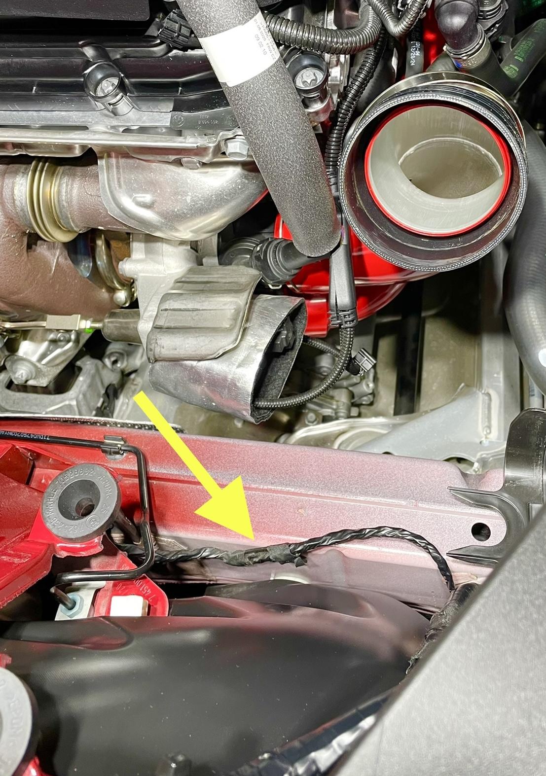

I read through your posts and problems because of the AOS system. The Eventuri has little wiggle room for installation. They designed it as stock replacement so any other mods might not play well with it.
Also it seems your 2021 is different than mine. For example the wire you had problems with on the second intake opening in the wheel well. You mentioned you had to tape that wire to the frame. Mine has a push tab holder that keeps that wire close to the frame, see pic.
The bottom post that’s missing would be damn near impossible to install and align to the second air opening in the wheel well.
I think for $1400 your mostly paying for a show piece that has performance in mind but not necessarily a better than OEM fitment.
-RJM
The bottom post that’s missing would damn near impossible to install and align the second air opening in the wheel well.
-RJM
The little differences in how the cars are assembled within a model year is extremely interesting to me. Thanks for sharing the pic. That for sure was a source of frustration during my install that some seemed not to have had.
You bring up a good point about aligning both the 2nd air opening and the bottom post by the factory cold air intake inlet. That may have required some effort. However, slotting it in didn't seem to be the issue according to the company, it was that the hole in the airbox that the (no longer supplied) screw-in post fit into was either too far forward or back (can't remember) on the piece that extended out from the main box to the inlet. Instead of fixing the product and selling an updated version with the hole in the correct place, they are just producing the version with a known issue (the hole is even still there) and not including the post. Honestly, I think that on top of all of the nights I spent in the garage taking the thing in and out just got the better of me by the end of it and I decided to sell it and go back to the stock setup. Just left a bad taste in my mouth. If I ever decide to ditch the Verus AOS I'll likely go with the MST product.
