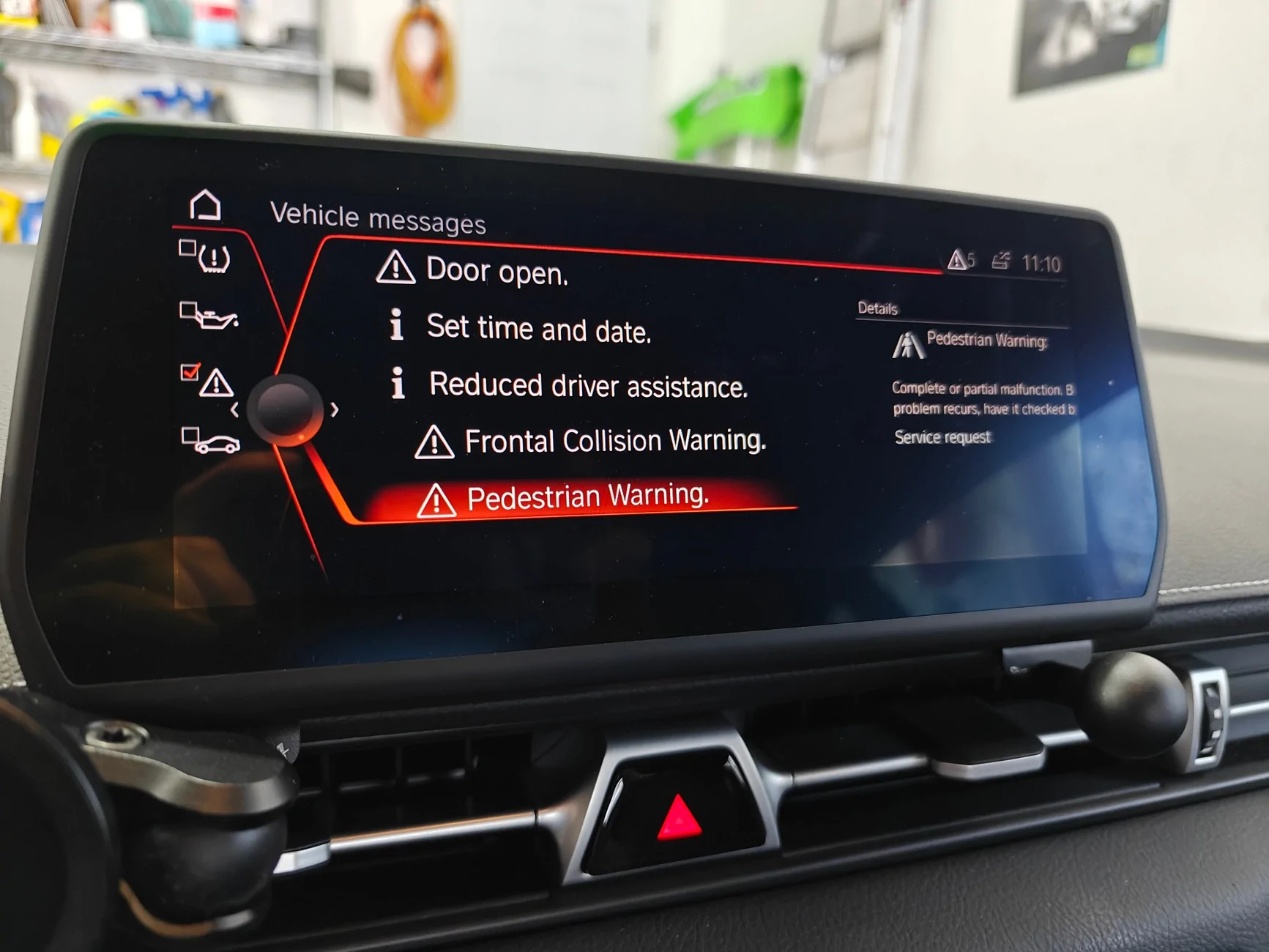

I wasnt able to get everything coded warning-free. I tried swapping the vehicle orders on protool (544 on, 5df off) with all default modules, but it throws warnings on the infotainment.
My next step was to undo and then selectively skip different modules until it stopped complaining, but i shipped off for dme unlock and ran out of time. I know that when doing EDC delete, you need to skip coding the BDC, so i was going to try that first

Anyone with ProTools and own a non driver-assist packaged car? Download your Vehicle order so we can compare for the camera modules.
Lane assist, auto braking, and the cameras need coded out.

@DivineDrive.co mentioned in DMs that they’ll provide full instructions to code out the errors with the kit. Wonder if they can share it here.
I have been busy with production, ironing out all the small issues that was affecting quality. Mass manufacturing vs making a few is a completely different beast. So I haven’t had time to address people’s error/coding concerns. If the parts were not perfect enough for me, they were not going out.
I3igpete has done some great work with ProTool in Android, which might be the way to go if we do a little more work. It is a bit more convenient than my original way.
My coding method is a bit different which requires a computer and a cable connection to the car.
I will share some more details later when I have more time but for now I want to focus on shipping out more orders as soon as possible.
If I continue where i3igpete left off and get a completely error free car using his method, I’ll add it to my instructions and maybe replace the computer method.

Something to note, more than likely the coding solution is changing the VO via Protool to mimic a car that did not come with adaptive cruise control. That requires removing both the front radar as well as the camera in the windshield.
