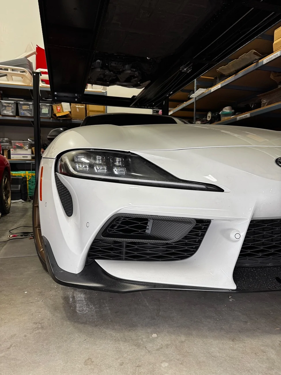

The asymmetry of the air duct isn’t an issue for me, I actually kinda like it. But I’m intrigued to see how your tow hook solution will function(?) & what it'll look like.
I just cut a hole into the plastic cover, so that the tow hook protrudes out neatly. Pretty easy DIY.

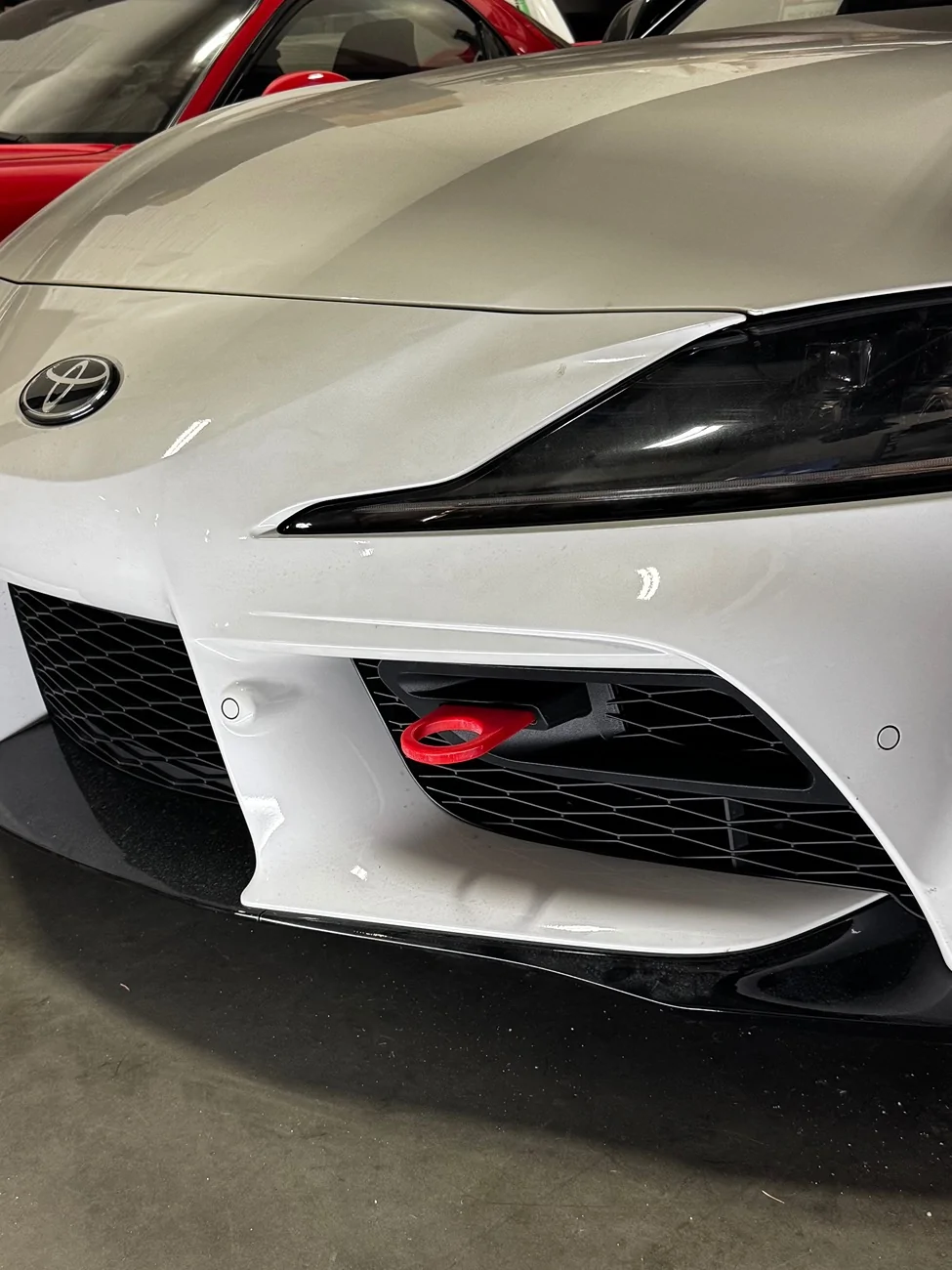

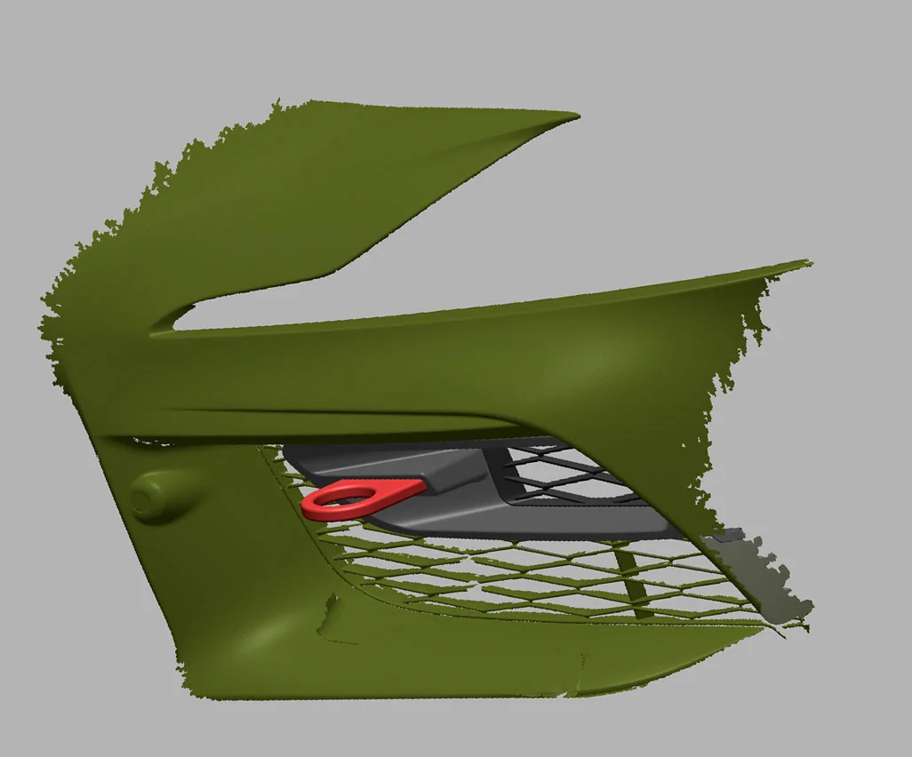

Was thinking something like this. I'll probably need to make a new thread and see if there is interest.

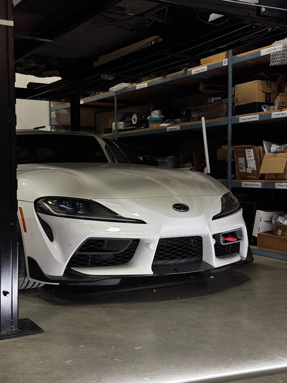

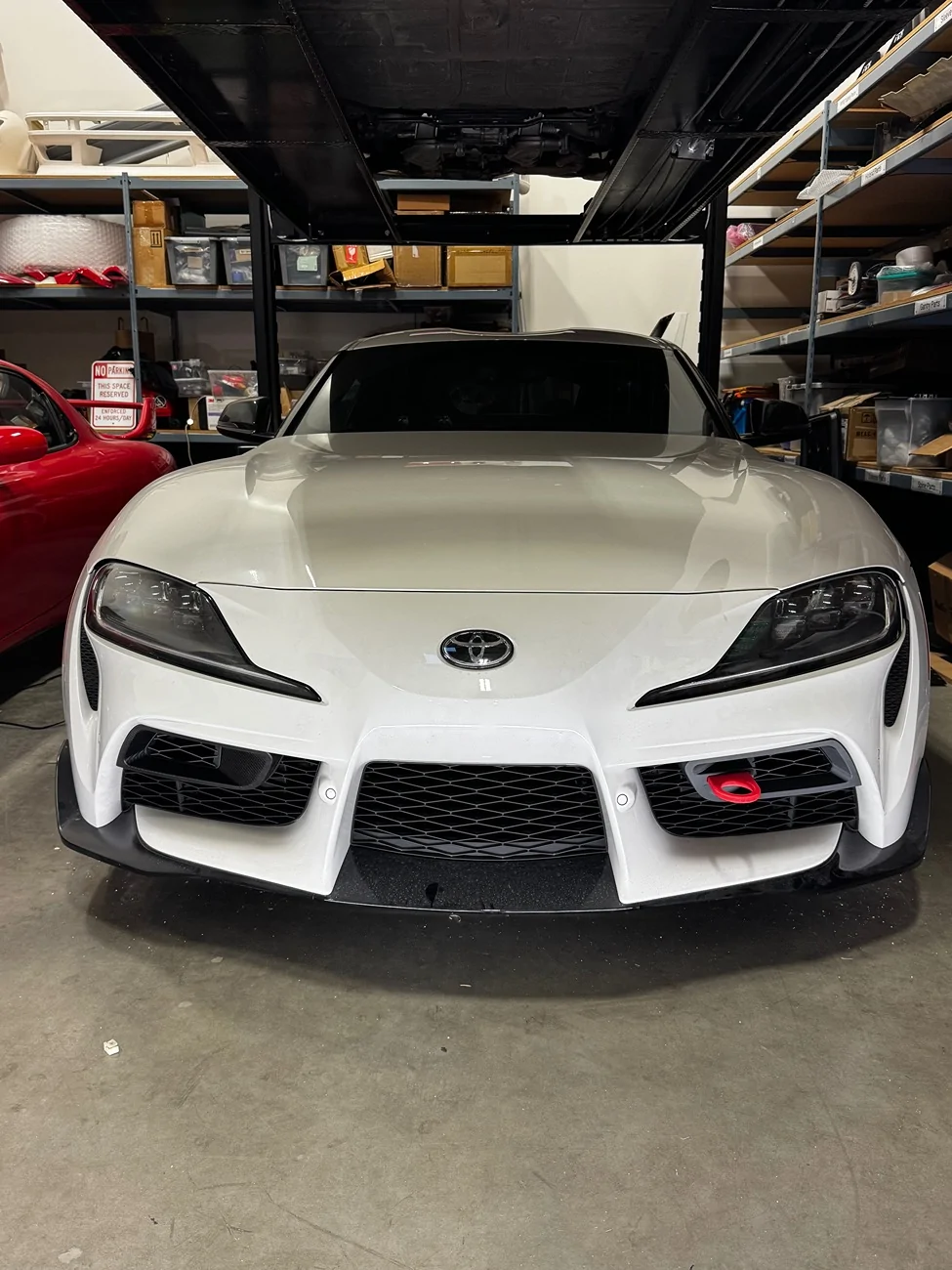

Test fitted the tow hook prototype for the other side. Now everything matches .
Like the symmetry! Will you still be able to access the OEM tow hook receiver for things like a front license plate mount to screw into?

I'm curious to know if the tow hook is functional or just cosmetic?
It will be fully functional. The tow hook will be one piece and stronger than those fold down ones with the hinge. Still deciding on the final alloy to use, but I’m leaning towards 304 stainless for its corrosion resistance. It will be designed to be used and abused.
You won’t be able to just unscrew it because of how the cover surrounds the tow hook. However, I do plan on creating a license plate mount add-on that attaches to the end of the tow hook and can be easily removed for track days or when the hook needs to be used. Depends on interest though.
