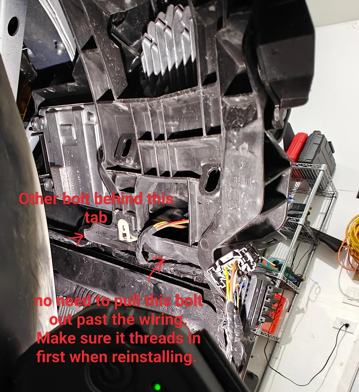

Glad to see your install went super smoothly! I never needed to remove the wheel. Just turn the wheel all the way to the left or right to access the fender bolts.
Ha, didn't even try that.

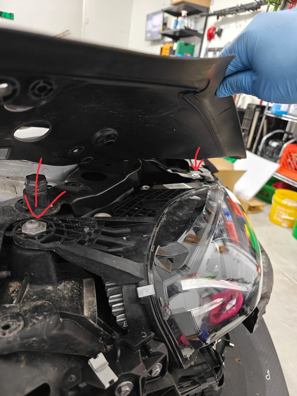

The trickiest part by far is getting the headlight out if you haven't done it before. (thanks to racebred for making me pull the front bumper 5 times this summer).
I know them racebred feels.

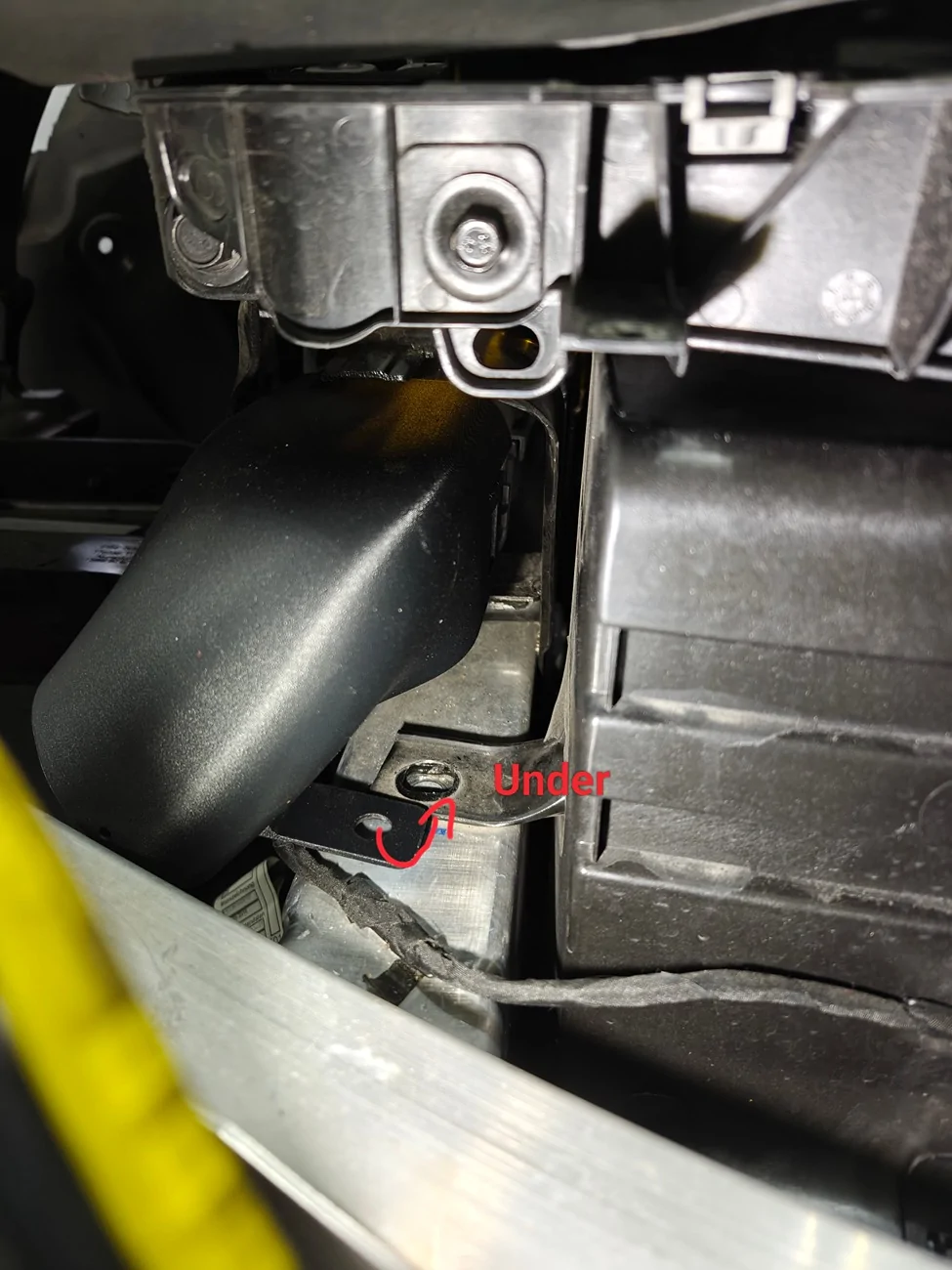

I actually designed it to go on top, not under. But if it works for you thats great too.

Yeah I saw that in your pictures, but I was worried that putting the bolt head directly on the plastic had a higher chance of cracking it, since it took a bit of torque to get off

Looks good! Can't exactly remember what I did with that bolt but I think I put it under that bracket as well.

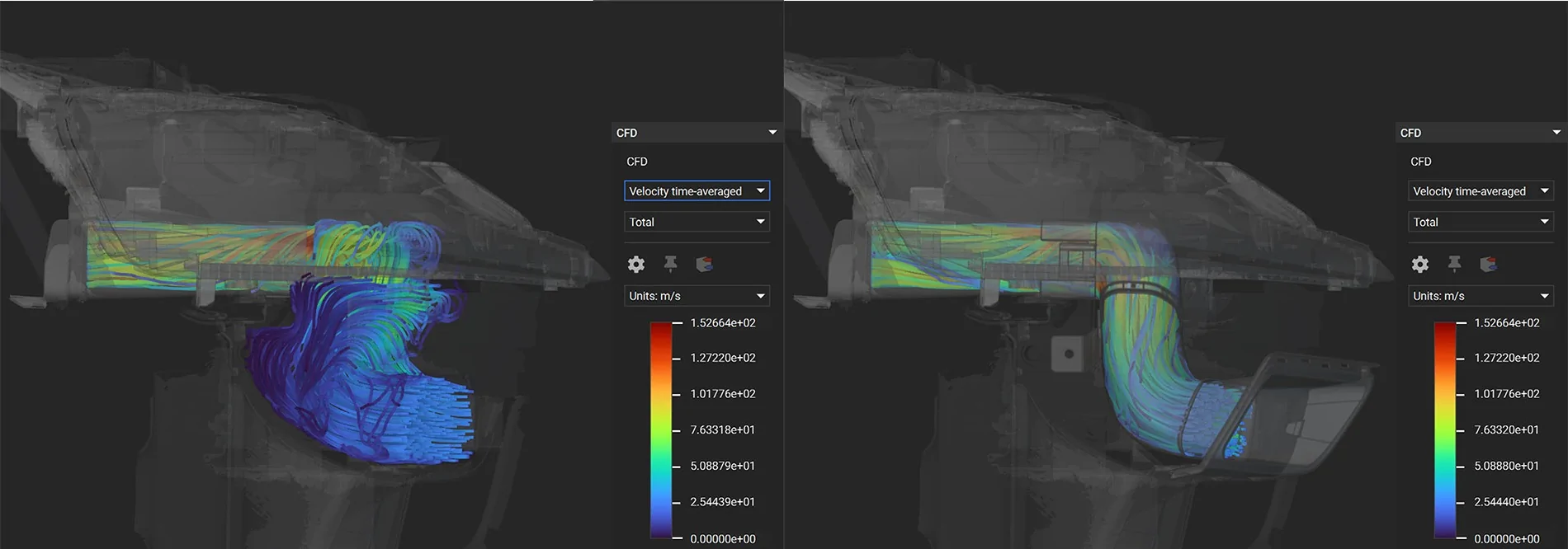

"Lower intake air temps would most likely be the main benefit, but just for fun, I played around with some flow simulations. This is comparing just opening up the front fake vent versus having a duct direct the air into the intake at 100km/h. The duct seems to work well, reducing turbulence, increasing intake velocity, and improving pressure recovery. Might not mean too much though because of the air filter and other restrictions, but it is still cool to see the comparison."
