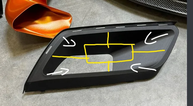

You did an amazing job on the air intake duct. I got an idea for AT cars, since you design the 3d model of the parts, you can add a cross (+ or x) mount for the active cruise control unit, and get the benefit from both the inlet duct and acc unit.

I'm having trouble visualizing where the radar could possibly go, given the tight space constraints there. Can you draw a sketch?
I tried to find a good photo of the radar/sensor but this what i got:

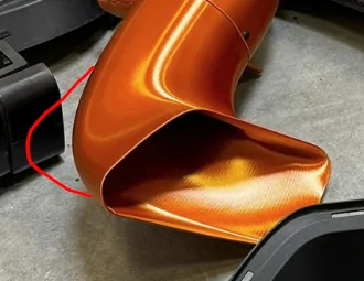

The sensor have a very big plastic holder it might be redesigned and be in small closed box shape to fit in the inlet like this :
You can add more support to the sensor box, tired my best to drow that xD.
The white arrows indicates the air coming towards the inlet and the sensor being in small closed box to prevent it from being damaged like they does in the original duct.

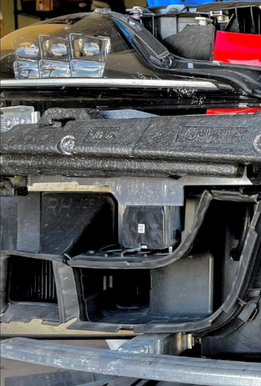

Yeahhhh I'm gonna fathom a guess that he's never taken his front bumper off, there is NO space for air to go around the sensor and there is nowhere else to move it and still have it point forward. Leaving it plugged in and tucked away is already kind of questionable

So basically cut off half the airflow to the ducting?
Yes, but at least you still have the sensor installed without removing it.
You are right, I didn't take off the bumper yet my car is under 10 miles. Even if you move it forward a little bit, or make the duct's inner groove bigger so it has more space inside to install the sensor??
