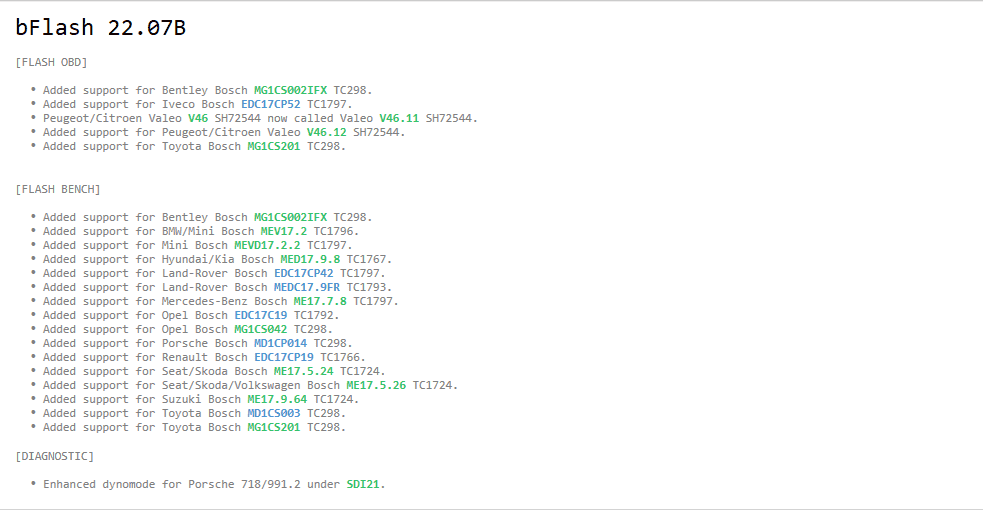

Release notes:

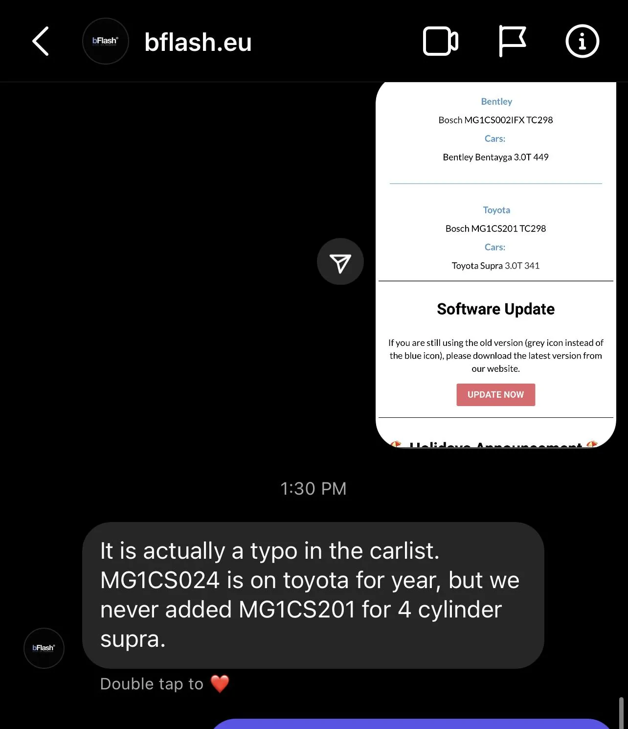

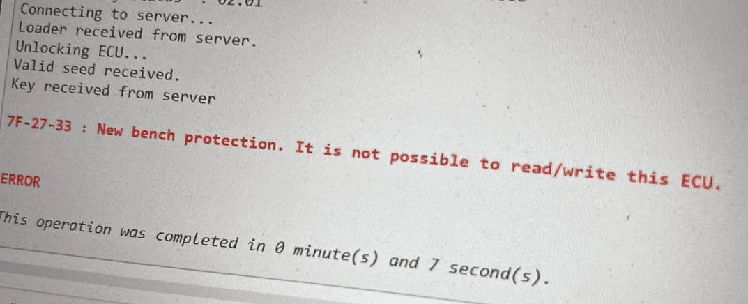

Tested today with a bFlash master via OBD and it's a nope.
Will try the bench mode either tonight or tomorrow
I've also seen a big nope.
I wondered why they would make such an unlock public, when they do require all 2020+ mercedes MG1s to come to their facility in Belgium.
I do think they have it in the cards, but won't make that play until they are ready. I also thought it would be silly to release such a thing right before their "break" over summer. They even paused the Mercedes 2020+ services.

Yeah not sure. But I had to go try it.
Where'd you see the nope?
