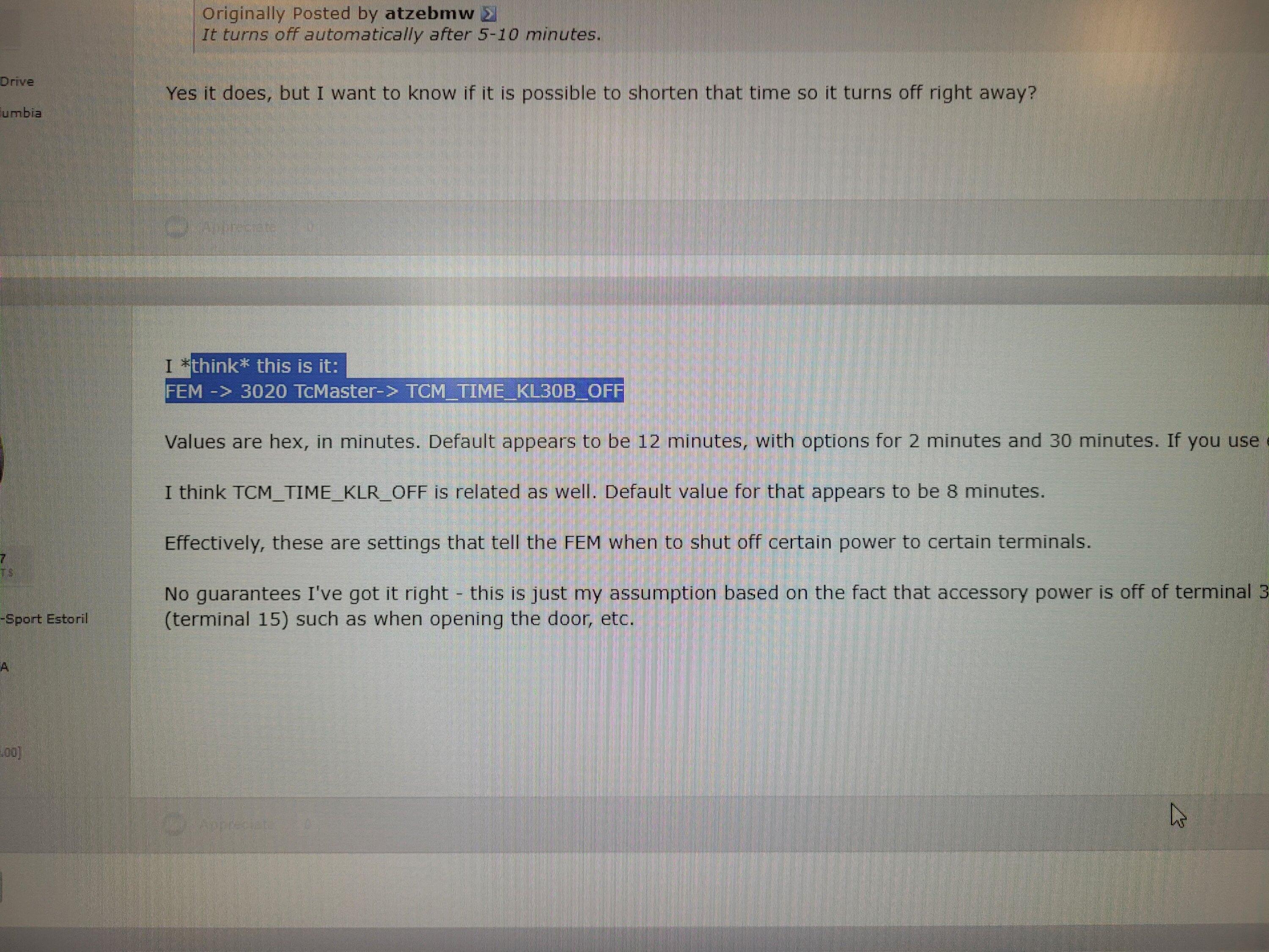

I hate that the accessory power takes 7 or 8 minutes to switch off.
Anyone know how to reduce the timer using Bimmercode?
I came across a random thread on a bmw forum, but I haven't tried it out. I took a photo of what was written (was on a work pc that I don't usually use).
Has anyone tried this or knows a fix?
I saw some people say they coded their cars so when the drivers door opens, accessories turn off. Ideally, that would be the goal for me (how all my other cars work).

Thanks guys. Where is it in the settings?
I just went through the whole lot and didn't find anything. The cloest I got was turn car off when last door opens. This just turns the engine off and I had it already ticked.
I'm in Australia, so I hope the setting is available to us, otherwise I'll be back at square one and looking for bimmercode option :(

I went through Bimmercode on the weekend. I couldn't find anything remotely close to the screenshot posted above.
Surely we have the 7 minute timer option... especially if another model has it.
Anyone at seen anything at all for direction or tried something/almost got it?

I had a good look over the weekend. I didn't want to play around with random lines, but nothing resembled the naming conventions from that post we both come across.
So I left it be :( I looked for a good 15-20 minutes too...
