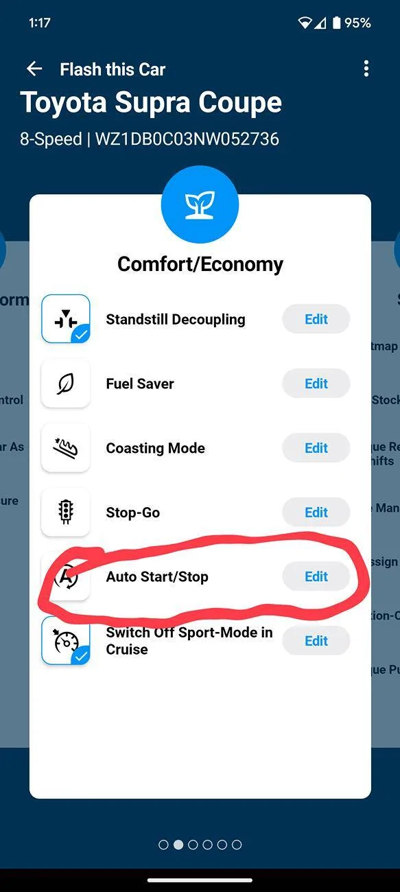

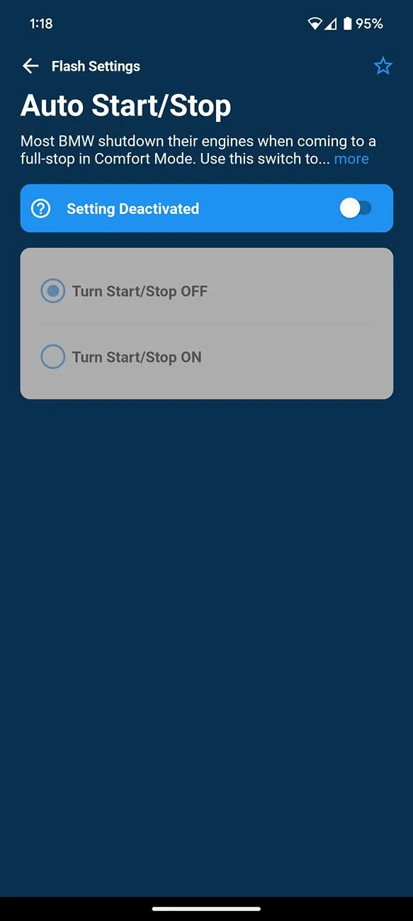

I had coded auto start/stop a few months ago and suddenly it’s not coded anymore.
When I try to recode it, does nothing. The first start up after coding, it will flash the no start/stop for a second then goes away.
I also tried coding auto start/stop memory function and it does nothing.
I saw some people who did the recall on the data module had this problem, but my car has not seen a dealer since I’ve owned it.
Anyone have this issue or have a fix?

I’ve coded the auto start stop 6 times, so now just given up. Sent an email to BimmerCode, hoping they have a fix soon. The memory function should really be standard from the factory…

There is no fix for it currently. It's a problem on all modern BMWs past a certain software version.

You can re-disable it if you have the 8-speed and use xHP.
