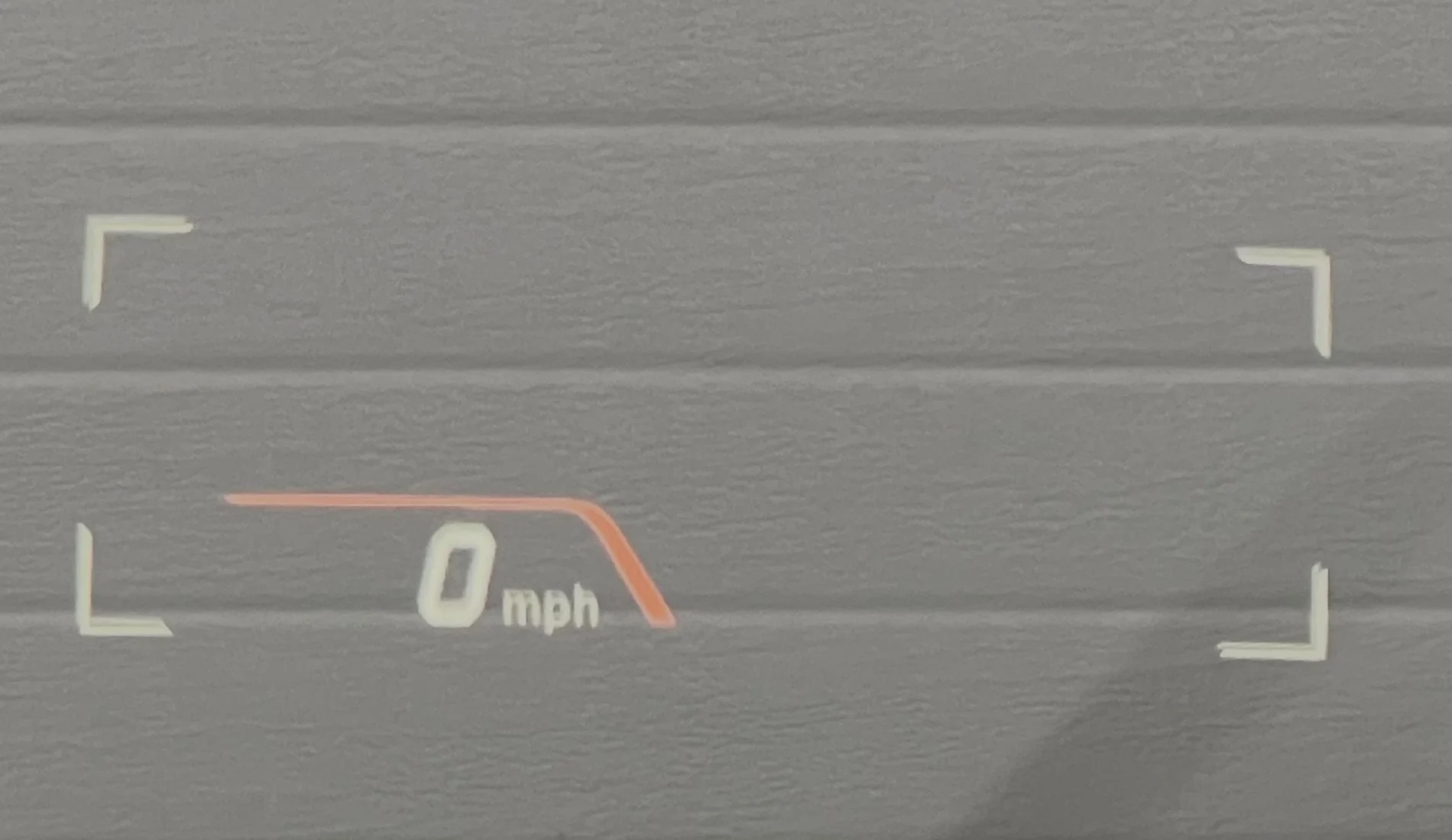

MY25. Everything OEM, no windshield replacement.
Have this issue from day one since delivery. Not as bad as some of the non-OEM glasses, but you could definitely see the double projections.
Expected issue? It doesn’t look like this on my other cars with HUD.

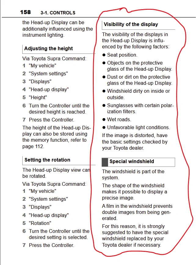

From reading the 2025 owner manual, I can't find anything related to adjusting the sharpness of the image. I did find this section which may be relevant to you however. If you've already ruled out all of the "visibility of the display" possibilities, I'd take it in. Looks like the windshield as you mentioned plays a role in the display.
Everything cleaned with no windshield film. Sounds like a dealer visit.
