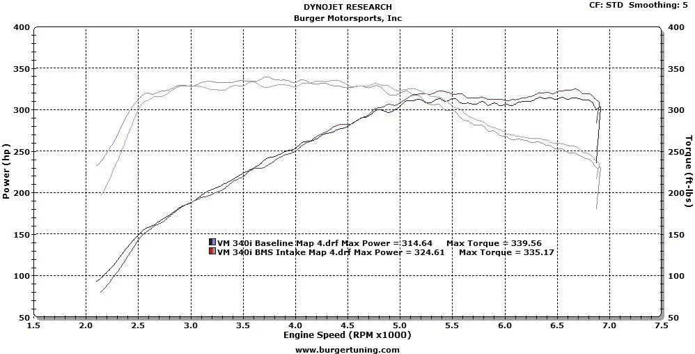

Dyno posts by VM engineering showed that BMS intake made 10 more WHP on the B58 stock engine. (not map 4 on the Jb4 means the Jb4 tuning is fully turned off).
