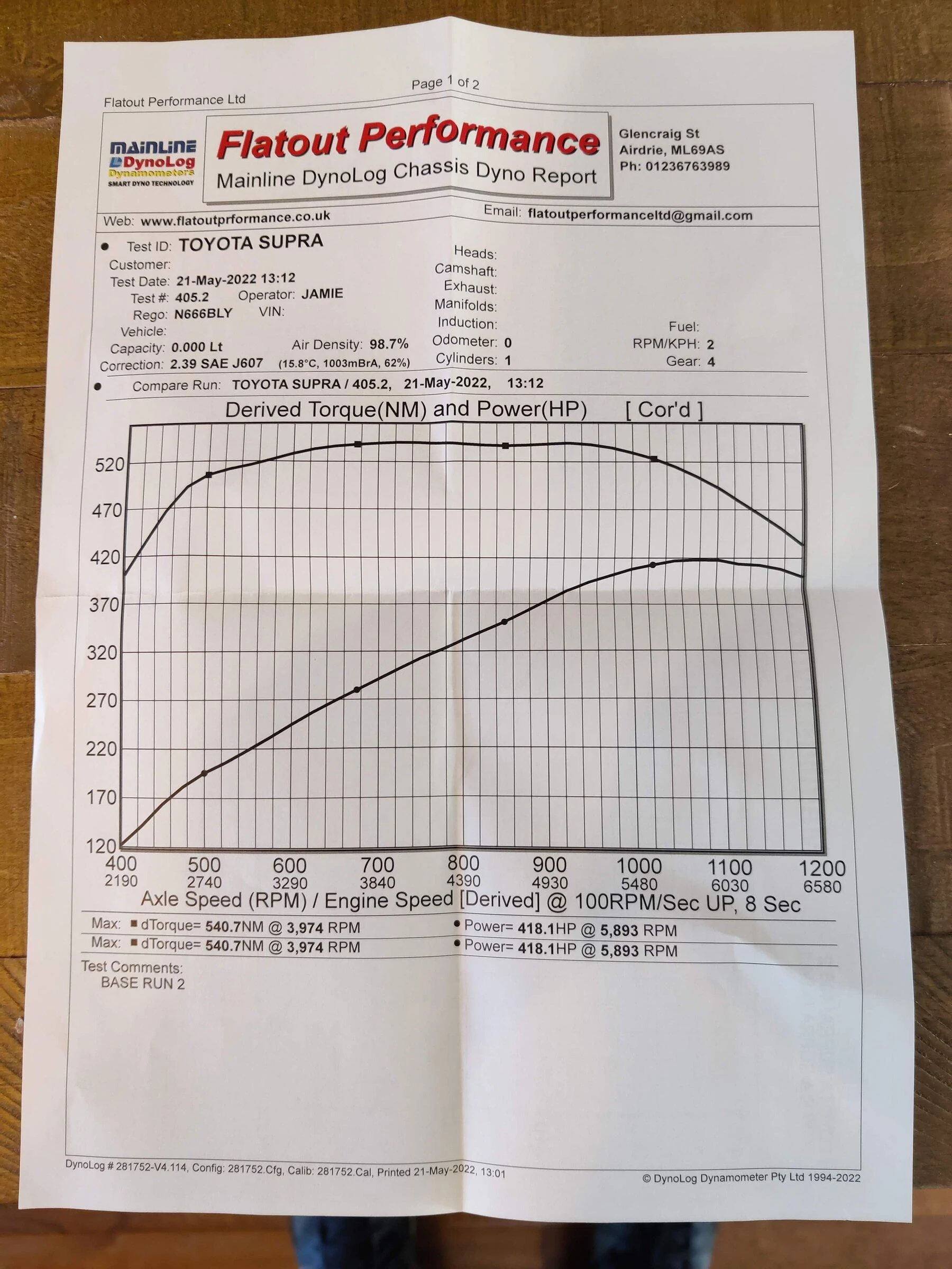

Had my car on a hub dyno last Saturday and it produced 418 WHP, which online calculators suggest is around 490 BHP (I know that's not 100% accurate).
Does that seem about right?

There's something wrong with that chart. Torque and Hp should cross at 5252rpm like the second one posted.
79
8,423
13,798
They do, they're plotted with axle speed and reusing the Y-axis. Torque is also displayed in nm, which is yet another conversion you need to do.
Edit: He even explains this in the second half of the video.
Yeah just saw the values..my bad

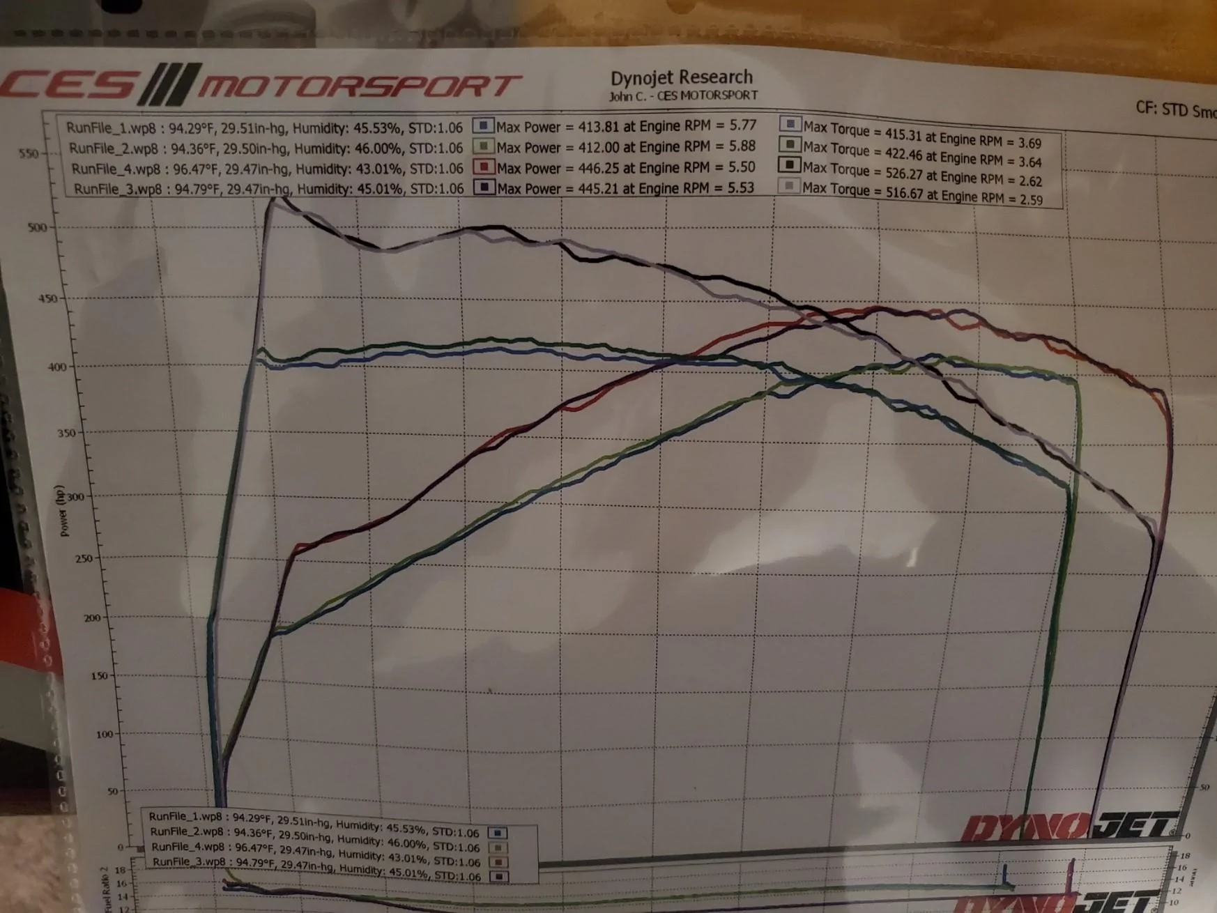

My stage 2 numbers were 443 whp and 522wtq with a catless downpipe and stock intake, 93 octane obviously. OP, your numbers are looking like 418whp and 398wtq. That sounds like no tune was flashed at all, or only a stage 1 tune was flashed and you're just benefiting from the aftermarket downpipe install. My car stock vs downpipe install baseline picked up close to 20whp from just the downpipe install.
EDIT: My cars peak power was a bit higher than I stated lol.
79
8,423
13,798

Ohh snap didn't even pay attention to the fact that OP was in EU. Ok, so minus about 30-40 whp. Where's all the torque loss coming from? Even if the EU cars are a bit weaker, that car should have still made closer to 450+ WTQ right, instead of the 398ish?
79
8,423
13,798
Yes, it should have. I'd think closes to 450/450. OPF/Exhaust/Downpipe restrictions? I don't know much about all that shit.
