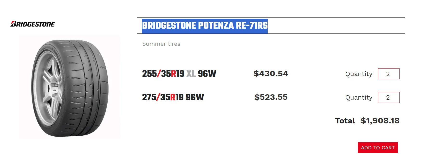

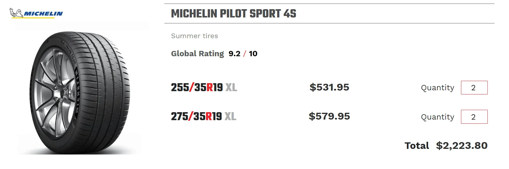

I'm thinking about replacing the stock PSS tires with something else. I drive my Supra on weekends only and that's between May to Oct due to Canadian climate. It's lowered and running a BM3 stage 2 93 octane map with DP. That's all for power mods. I don't really track this car other than the occasional drag strip once or twice a year, and the RE-71RS tires actually come up cheaper than PS4's or replacement PSS tires.
What's your experience with these tires for street use and weekend hooning around?

Price is CAD. At stock sizing, they are cheaper than PS4's - I think they are also slightly wider than a regular 255 and 275 tire. It's not a huge difference in price, but for someone that puts 2500 kms a year on the car - I won't be changing them out in 1 season, lol
What I like about them is that they are non-directional so they won't grab the grooves of the road and tram-line all over the place. I hardly get caught in the rain but I feel like they won't be so bad if you just take it easy.
