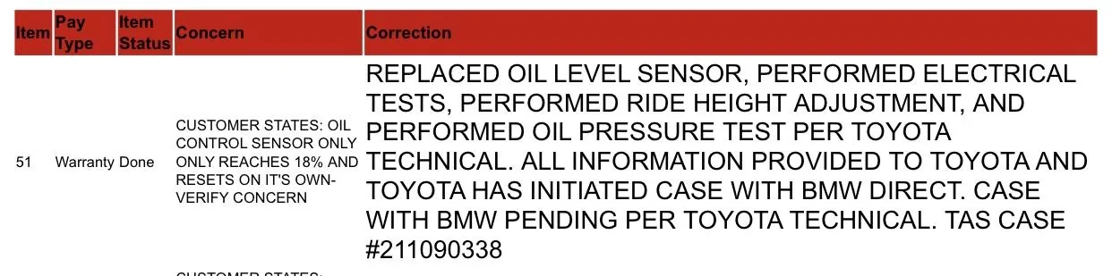

They have opened up a case direct with BMW now. They have exhausted all options from Toyota side. Let’s see what BMW says now.

So another quick update- the Toyota rep my dealer has been in contact with told them yesterday to disconnect battery for 30 min and reconnect and test drive. This was a solution another member was able to use for this same exact issue. They did that and then a test drive but it didn’t work for me.
Now in this new test drive a new error came up. They had low oil pressure code and check engine light came on.
I have been telling them since day one of dropping off my car that they need to replace the oil pressure valve assembly assembly because that’s what people on bmw forums did when this issue happened. I already pointed them to the correct part number 23950WAA01.
Having said that, I am also one of those Supra’s who oil is consumed at an alarming rate. Now if this specific part which controls oil pressure and consumption throughout the engine is faulty this early, does this mean this may be the main culprit in all the 21s who have oil consumption issues?
Let’s see and find out once this part is replaced.
