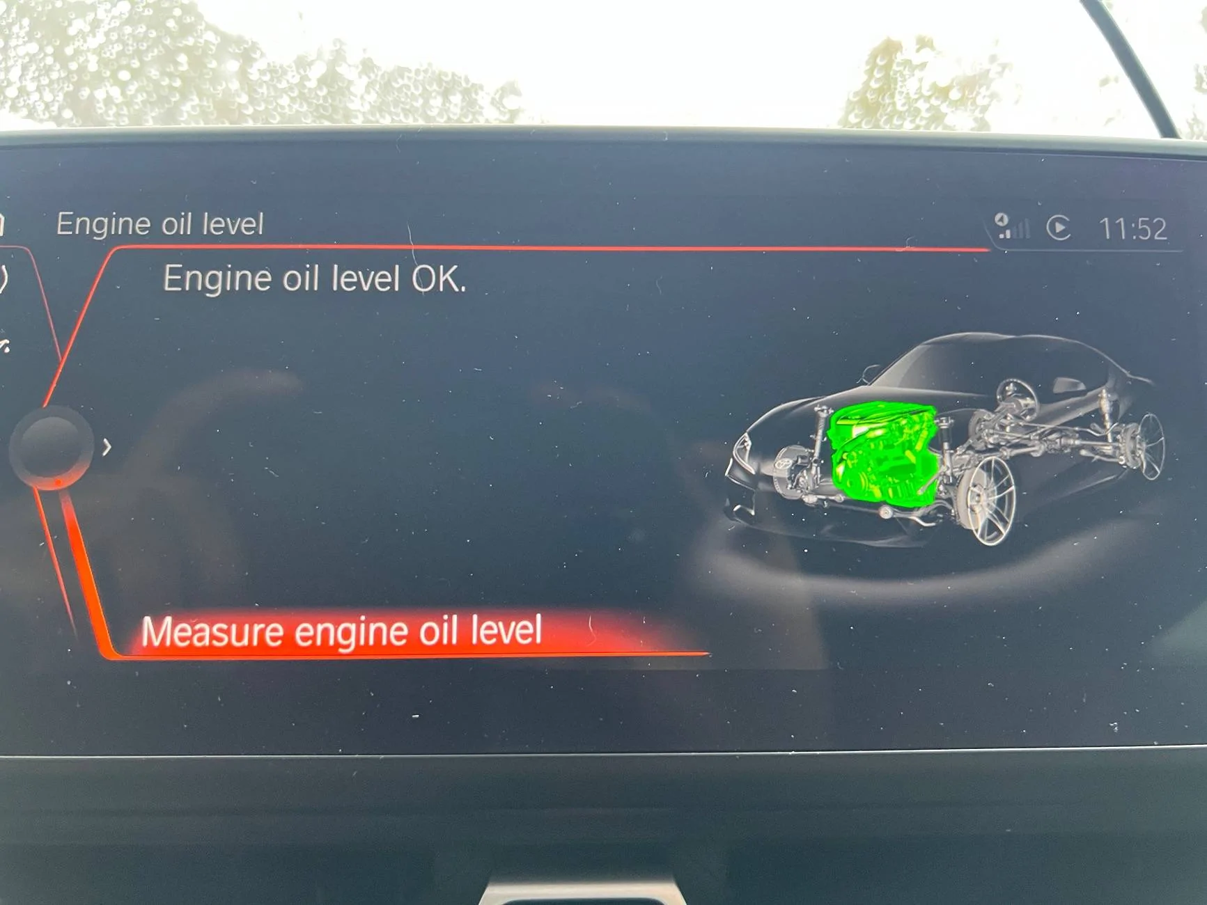

Necro: Man. Mine isn’t even giving me the oil levels. It gave me the low engine oil once and I added one quart.
Dealer said it’s fine, but I beg to differ.

"Engine oil level is OK" cant even measure the engine oil levels..... LOL
“OK” just means it falls between maximum and minimum. Not the actual amount in the engine.

Never tells the actual amount
It is supposed to have a literal gauge to the right of car when you run the scan showing the estimated amount. It may not be exact but it is the actual. The gauge only shows if the scan can be completed
