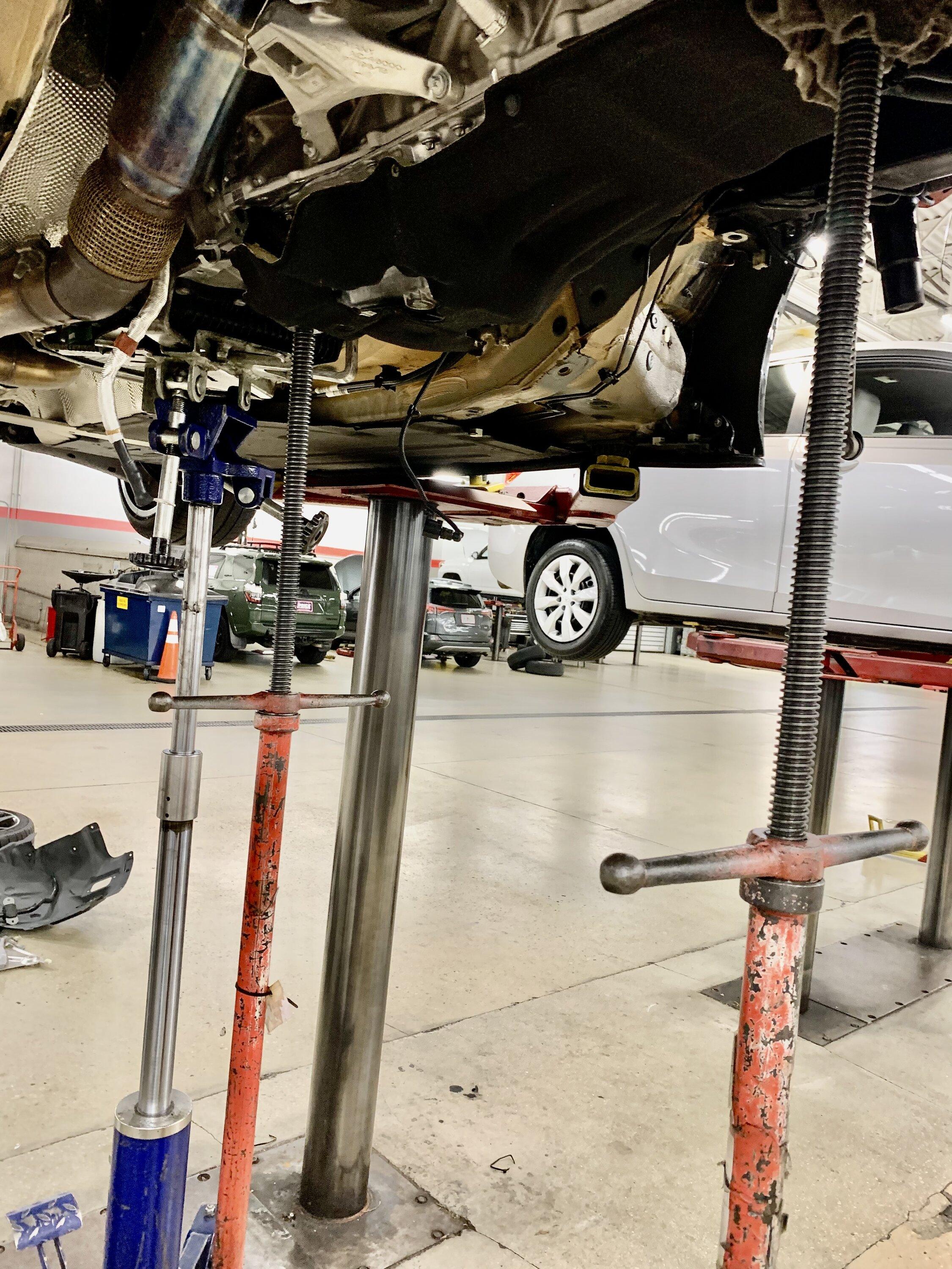

I was told by Toyota to replace the oil pressure control valve and it that doesn’t fix it then replace the oil pump. The repair looks miserable and the time they want to pay me to do it is unrealistic. I’m praying the valve fixes it.

I had to do both, thankfully under warranty.

As a 18 year Toyota tech I am extremely unhappy to be working on bmws but maybe if I’m lucky it will get bought back before the parts come in.

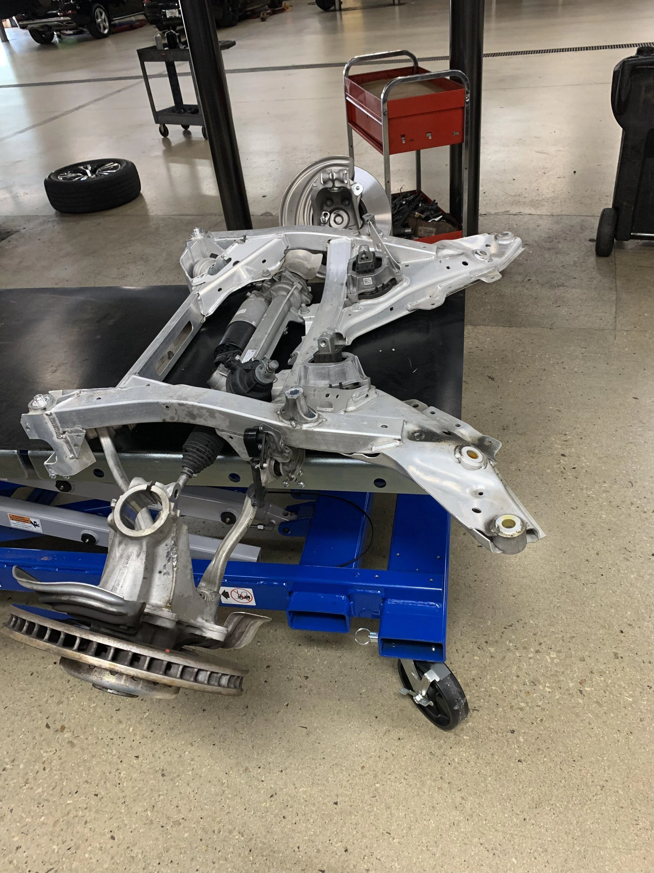

LOL... I wondered the exact same thing... that must have been an aggressive alignment adjustment. :oops:
that was complements of my hammer. Alignment was almost spot on after. I had to adjust front a rear toe. Drove straight as an arrow after.
