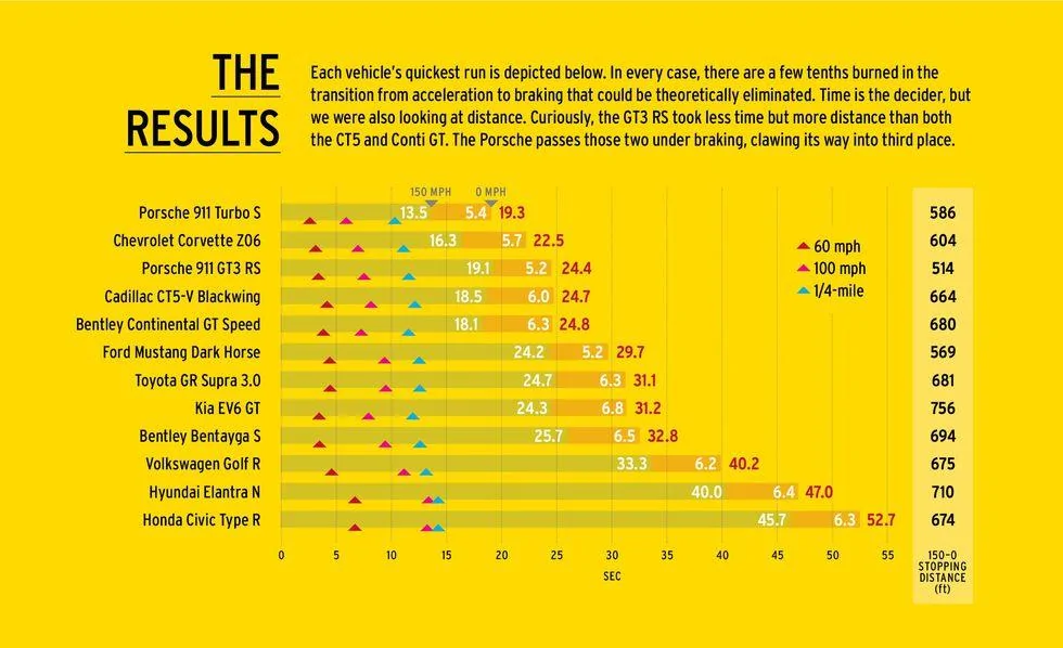

Only somewhat surprising things to me are how quickly the Dark Horse stops (given how heavy it is, must be massive brakes and big, sticky tires) and how slow the Type R is (wouldn't have expected it to be so far behind the Golf R and Elantra N).
I've only gotten the Supra up to 140 or so, but I was impressed with how it continued to pull up there. Gets a little loose in the rear with heavy braking from that speed though. With better aero, it would probably stop quicker, but there would be a tradeoff in acceleration/top speed, so probably a wash.

The DH wears P Zero Trofeo RS tires. That's why it stops like it does.
Semi-related note, my lifelong dream car broke/held the 0-100-0 record three times 🤤 (but it looks like the 0-150-0 is the new yardstick now)
