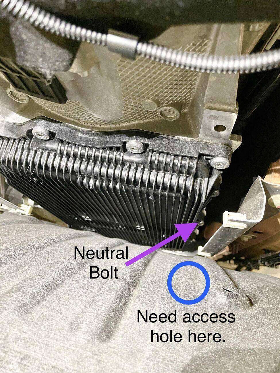

after all the attempted starts and the shenanigans of having to get it into neutral just to winch the damn car on and off the flatbed, the battery has died completely...RIP
thanks for the info on the trunk release J29DB03.

after all the attempted starts and the shenanigans of having to get it into neutral just to push the damn car on and off the flatbed, the battery has died completely...RIP
AT don't have the emergency shift release thing? It's like a small cover over a slot where you can insert a flat head or key to release the shifter.
