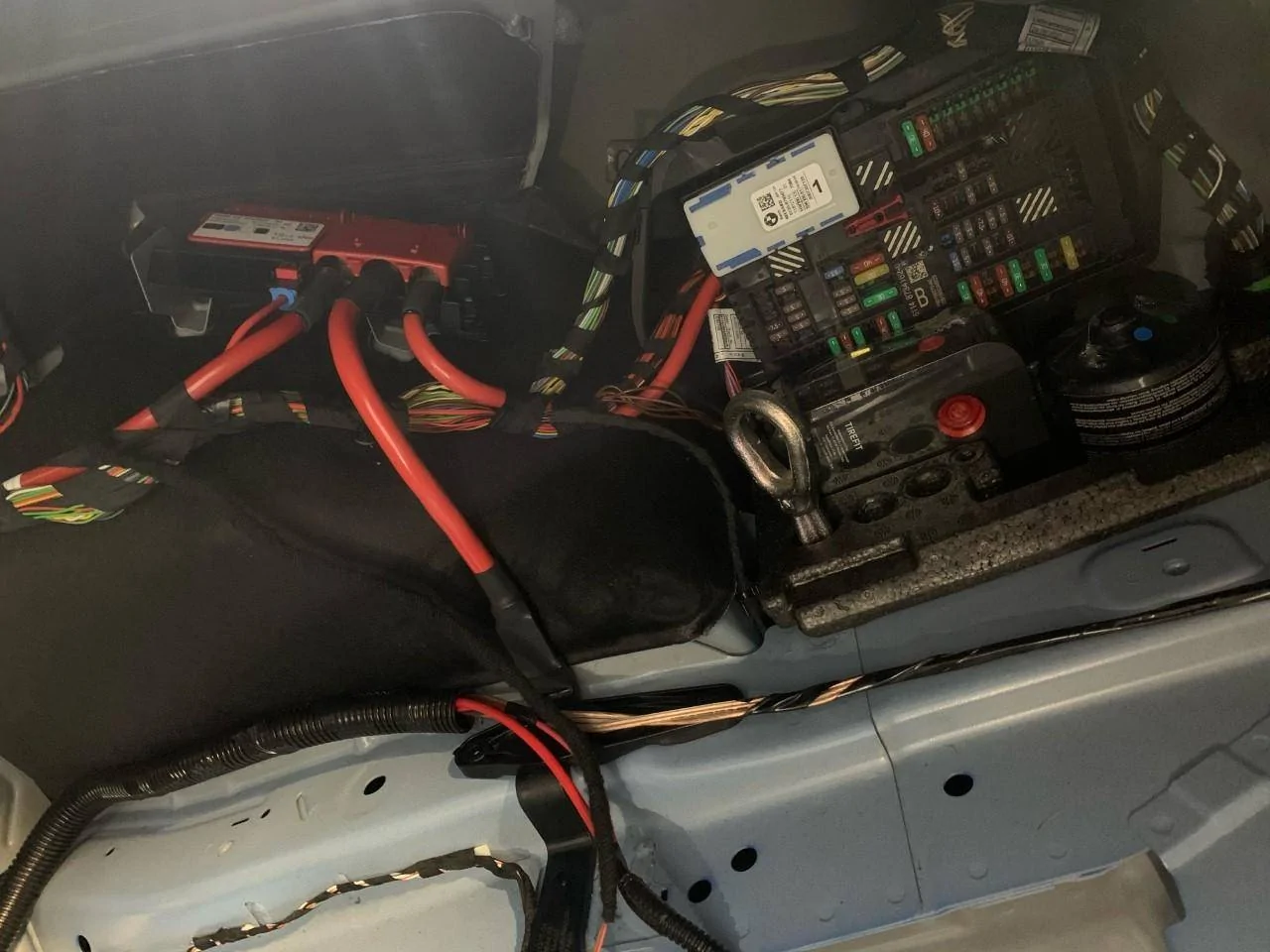

Check the connections behind/inside the right wheel well trunk area for the distribution box fuse connections. Make sure all of these are securly fastened. Seems like there is a main line not giving voltage.

Main lines are secure in the trunk. Gonna check all the connections and fuses next.
