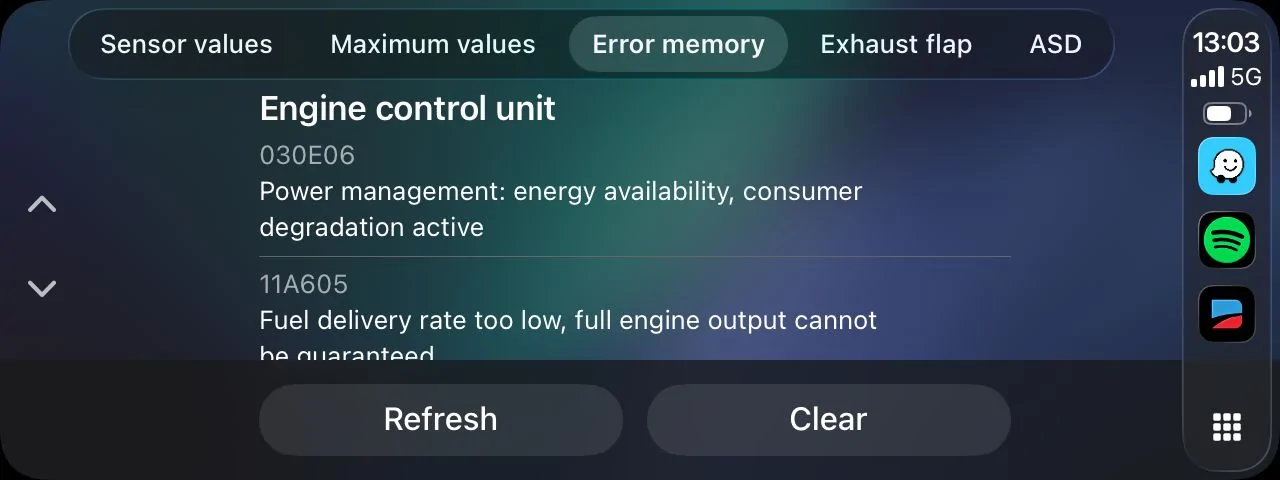

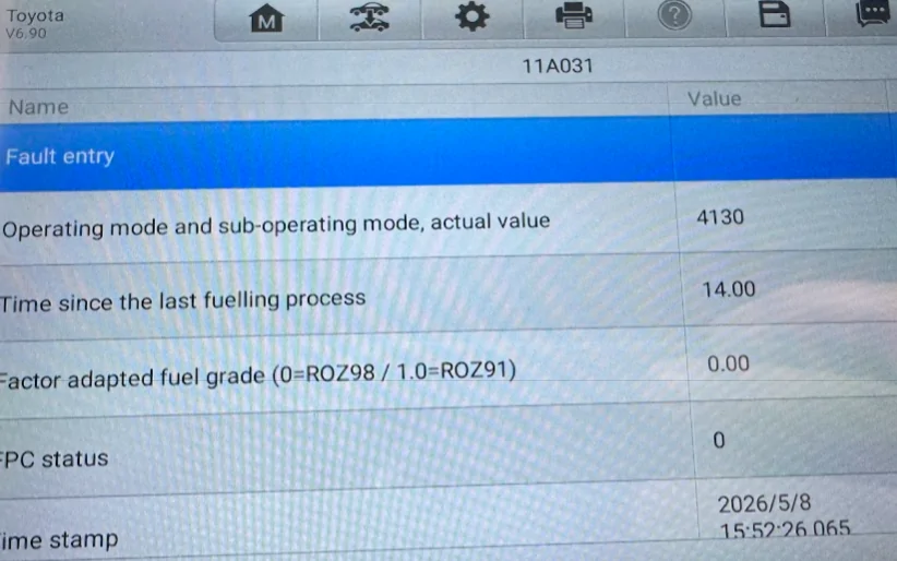

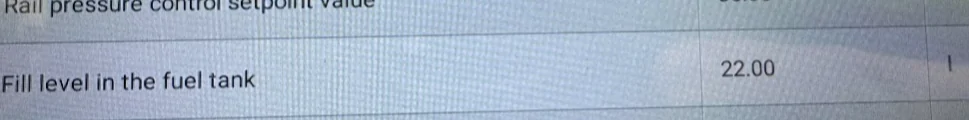

I had the same error on a trackday this Weds.
Mine is a B48.
"Limp" went away before getting out of track, let the car cool down before the following session and it behaved properly for the rest of the day. About half a tank. All right handers bar one :D but I'm not even remotely fast. Been on track with it before twice and didn't have any issues. Pretty vanilla: JB+ on 3PM setting, air filter, wheels. Nothing special.
Awaiting to receive the new ODB dongle (used this as an excuse to upgrade :) ) tomorrow so I can read the error codes.

Narrator: "It was, indeed, fuel starvation after a right hander".
