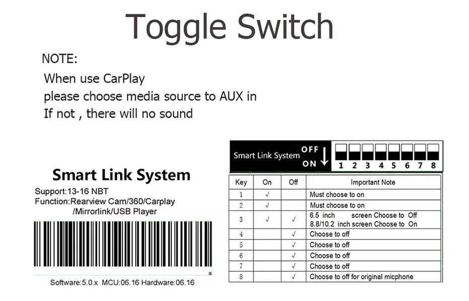

Did your unit come with a manual? I received mine with no documentation of any sort. I have no idea how the dip switches are supposed to be set.

After installing a no-name version of the Apple Carplay/AndoidAuto upgrade unit and running it for a month, here is how it went.
Purchased on Ali-Express. It arrived with no documentation whatsoever but the seller got back to me with a link to the manual here.
The install went relatively easy. Follow the Bimmertech video in this thread and buy a basic trim tool kit here on Amazon, you will need a Torx driver too, everything comes apart without much effort. Give yourself a 4-hour window for the entire job.
Once installed plan on spending some time with the interface to get it set right. We are an Android family and it runs AndroidAuto with my crusty Note8 and my Wifes Pixel3 pretty flawlessly. The wired version is most consistent vs. Bluetooth. Since you are usually going to have the phone mounted and charging it really is a moot point. You can run 2 apps on the head unit display. Usually Waze/Google maps and Spotify. That frees my phone for Hiway Radar and Laser Jamming app. Have not tested the CrApple Carplay.
This unit does NOT support touch screen. Menu navigation is with your counsel controls and works satisfactorily in AndroidAuto. The base menu offers an equalizer feature that works great and a Youtube application, while Youtube does work it is impossible to navigate to the search feature so you are stuck with whatever choices Youtube offers in the Vid menu. Seems like that needs to be fixed in a firmware upgrade. You also have an option to screen mirror your phone when you absolutely need to watch videos while screaming down the highway.
Speaking of the firmware. I contacted the seller about updates and they claim they will notify me when updates arrive. Additionally, there is a support thread on bimmerpost regarding all the different vendors of this device and their firmware here. I have yet to figure out the true vendor of this particular device. Certainly do not want to flash the wrong firmware and brick the unit.
For me, this was a worthwhile endeavor. My Supra is a base model with no factory GPS or CarPlay, AA isn't even an option for Supra. Gaining both AA and CarPlay under $300 and my time was worth it. Having the head unit main display running navigation is huge.
Touch capability on these devices seem to be a no-go for all. Even the expensive Bimmertech one doesn't have it (afaik).
Enjoy the head unit! It took me quite a bit to install it correctly. Almost accidentally botched one of the speaker wires... Only had sound coming from the right when I first tested it ?
