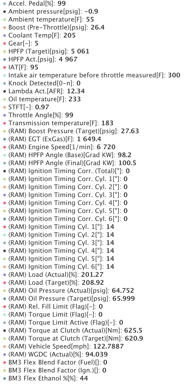

That's different, that is the max "reported" torque to the trans. Which is 528nm.
All available to be changed in BM3.

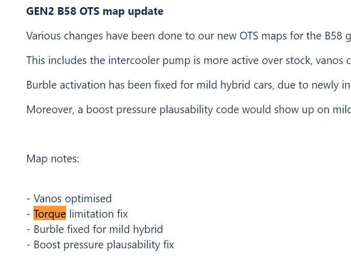

I know this is old, but the mhd ots doesn't spoof limits, atleast not since a year ago. I had to get xhp so the ots map wouldn't limit power. Without xhp I had tq limits and boost was low for my femto unlocked.
