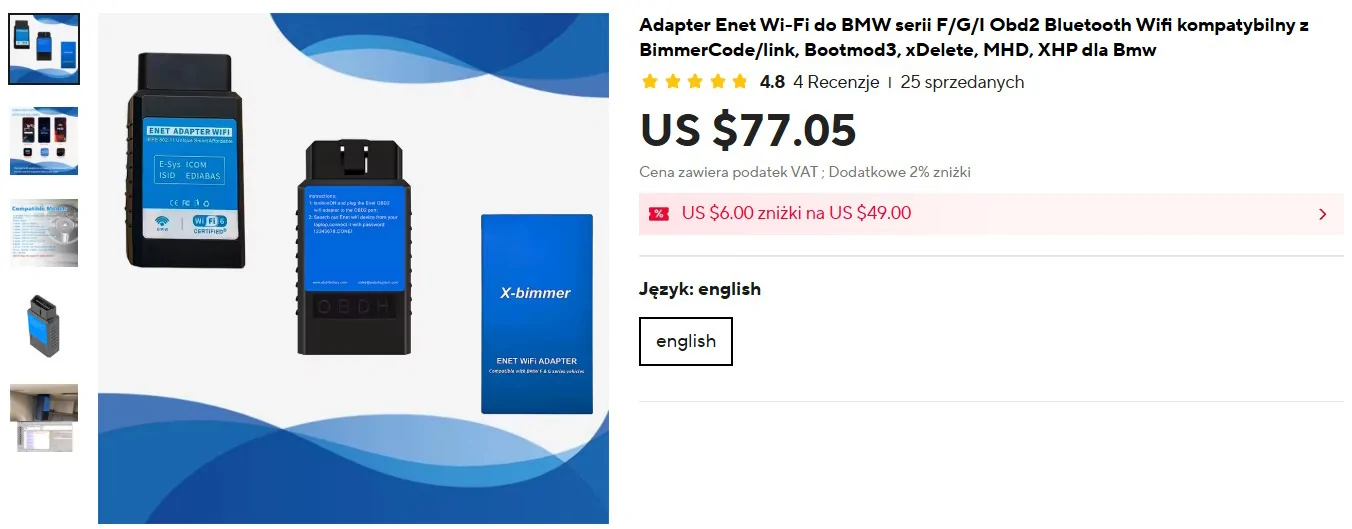

-Do I need the xhp dongle or will bm3/mhd dongle be able to communicate?
I've noticed their dongle has been sold out for a while: https://www.xautomotive.com/products/xhp-wifi-adapter
And on Aliexpress I no longer see Bimmercode wifi OBD2 adapters which used to be available for approx 40USD a few months ago, just BT3.0/4.0 ones which I was told are too slow for data transfer required for ZF8HP driver programming. There are available only "xHP" wifi adapters for almost 80USD, picture attached. Which wifi adapter do you guys recommend right now, which is available to be purchased in Europe?
8,838
17,332
MHD works. The pinkish one. https://mhdtuning.com/pages/mhd-wir...zxEuHBj6y47flNvlAUC1-jis-e_PewyZZJcRDYRIA7Xey
