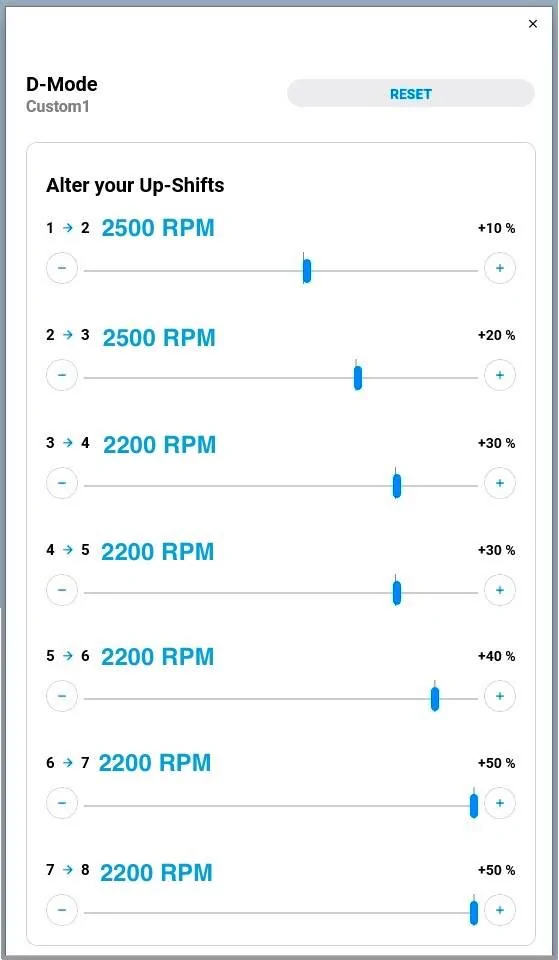

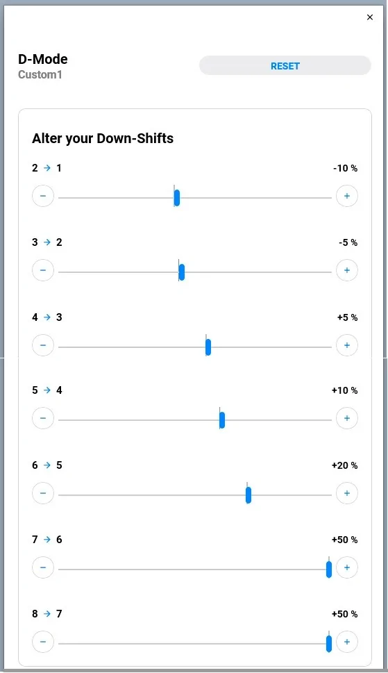

Here is my contribution to the thread. Also props to @Xproplayer for posting his D-mode settings as a baseline.
I’ve been running xHP mostly D-mode to improve normal driving while cruising around. My car doesn’t like shifting at low RPMs.

Glad others are enjoying it. I'm dialing in my settings again for my 2nd supra, I have notepad in the car and I'm doing 5% adjustments based on how the car drives in ACC or me driving the pedal. How'd you calculate those RPMs, I should consider doing that, but it seems like the car also shifts based on load too?

The RPMs are based on gradual pedal input while accelerating, like when cruising around. The deeper you get into the pedal the higher the shift points.
Also, for Sport Mode the start in 2nd gear and downshifts disabled makes the car much smoother when launching. I don’t miss 1st gear at all.
