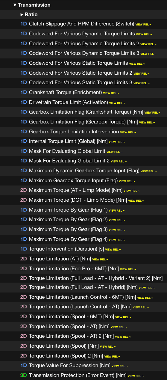

AFAIK the OTS maps have the limitation upped/removed. If you start from scratch, not OTS (custom tuning) then you need to up/remove them in the rom.
There are 20+ limitation tables. Some of them make the car up/down shift crazy aggressive. I actually had my Supra shifting insanely aggressive before I even had xHP. xHP by itself is much less aggressive.

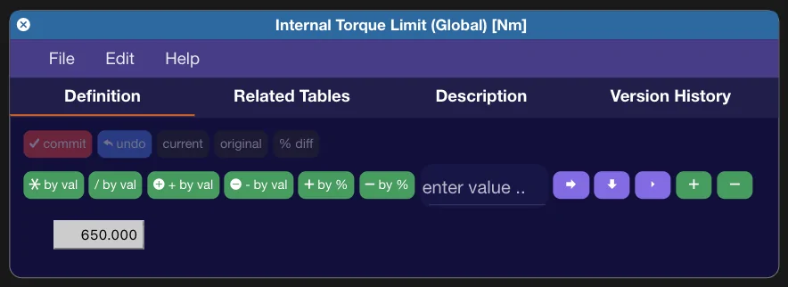

FYI, @kfer is incorrect about the torque limit. It is 650nm, not 500nm.

That's a lot of tables!!
And am I seeing this correctly? There is a launch control table?

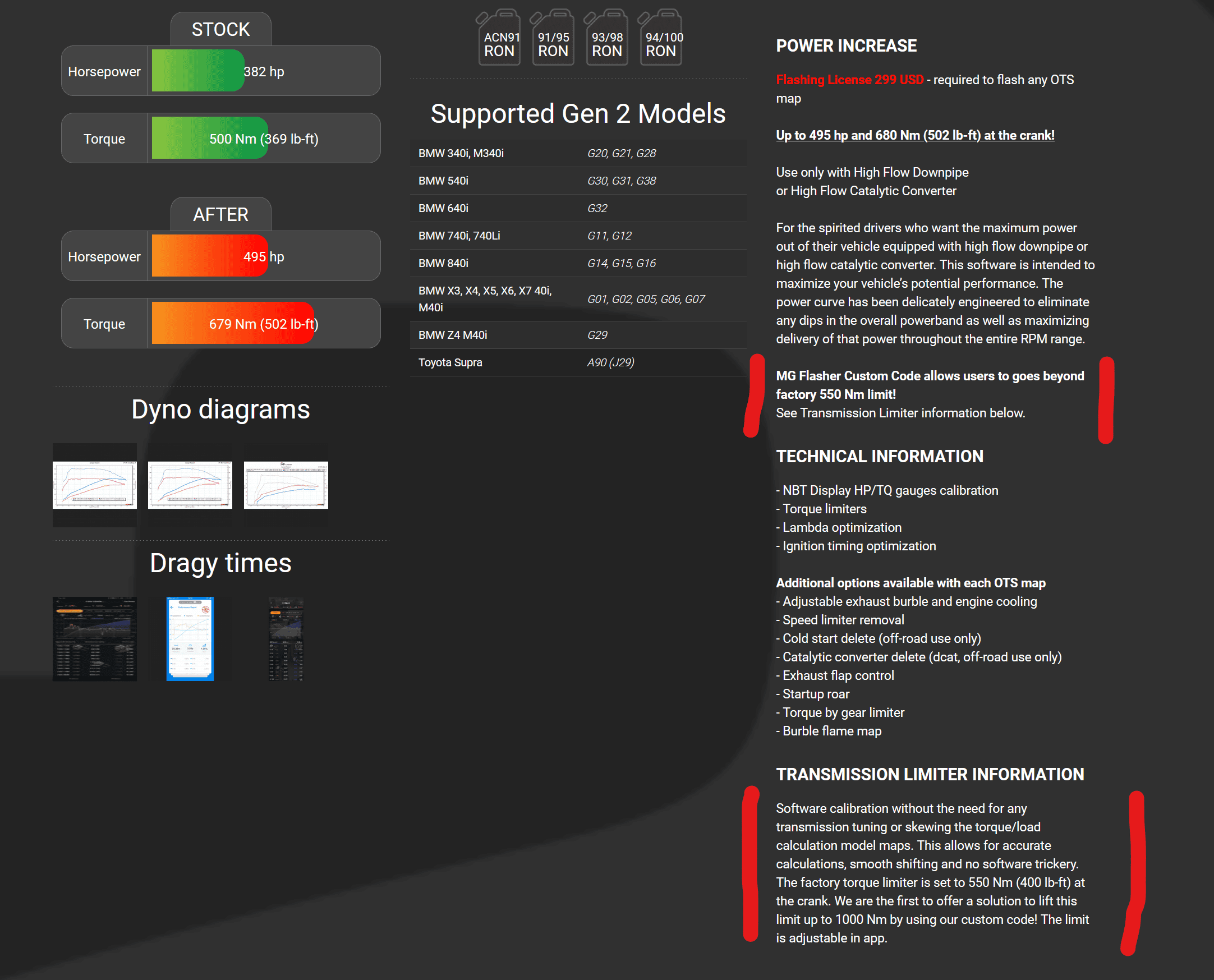

I mentioned 550Nm and it's the information from xHP. And that was also MHD's explanation of why they stayed below this limit , although their tuning makes a lot more.
In Germany some people switched from MHD to MGFlasher when they were able to "overwrite" this 550Nm.
8,699
17,048
That's different, that is the max "reported" torque to the trans. Which is 528nm.
