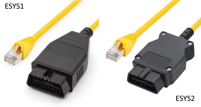

Will xHP/Bimmercode work with ethernet cable with USB-C adapter on the phone? If yes, which connector do I need to buy: 1 or 2? Is 100Mbps speed for USB-C adapter enough for stable data transfer?
xHP will not work with an ENET cable for the initial flash. You will need a DCAN cable for that. It’s much smarter to just buy one of the well known wireless adapters such as MHD/bm3/xA Ultra.
Will not work with ENET BimmerLink/Bimmercode will. You will need a xHP adapter or you can use a Thor adapter you can buy from visconti website which works.

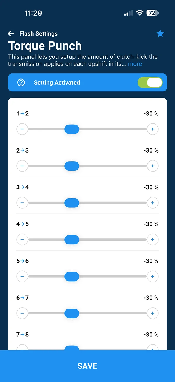

Just got my car unlocked and flashed the OTS MHD stg 2 tune a few weeks ago. Absolutely hate how the tune makes the car shift so early in normal mode. I'll be going 40mph and the car is in 8th gear. Read about ⅓ of this thread and it seems like this would be the best solution short of getting a custom tune.
Just curious if anyone else has flashed XHP to fix/bandaid MHD's awful throttle mapping/super torque-y low end feel in their OTS tunes. I just want my normal mode driving to feel at least as good as stock again.
