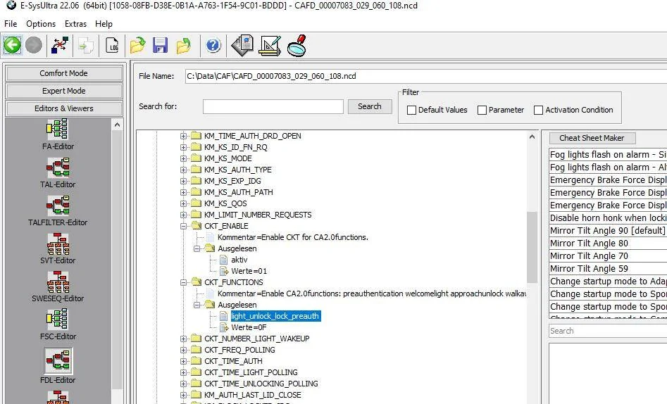

When I go under CKT_FUNCTIONS, there is no option for ->light_unlock_lock_preauth. Does anyone happen to have a screen shot of the options under this menu for selection in bimmer code or happen to have the Hex code for this selection? Thank you in advance.
I don’t have BimmerCode but when I get a chance I will get you the hex values

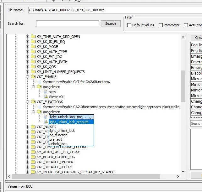

I know there is a setting if you go into Expert mode in the BDC, look for CKT_function and change it from light_unlock_lock_preauth to light and see if that works for you. Remember, the welcome lights are by default set by rls (Rain Light Sensor) dependency, so the lights probably do not come on in a daylight scenario. You may be able to change the setting in the attached picture to a different mode also to see if it will yield the result that you are looking for. Hope this helps.
Edit: For some reason I cannot get the image to upload. Try changing
BDC:
WL_CKT_KONFIG
RLS_abhaengig (00) -> ohne_RLS_Mode_3_4_5(03)
Description: Parameter indicates whether WL (in connection with CKT=Comfort Key Tracking/light on approach) is activated depending on the RLS and if not - in which mode.

as promised here is the Hex code, I don't have the app so this is the best i can do

maybe try one of these options under CTK_Functions

This code works if you just want approach lighting thanks to @dklamac! Video of it below.
CKT_function > light
Car Guy, I am glad that I was able to help out. If there is anything else that you are looking for, let me know and hopefully I can help out. Until the take care.
