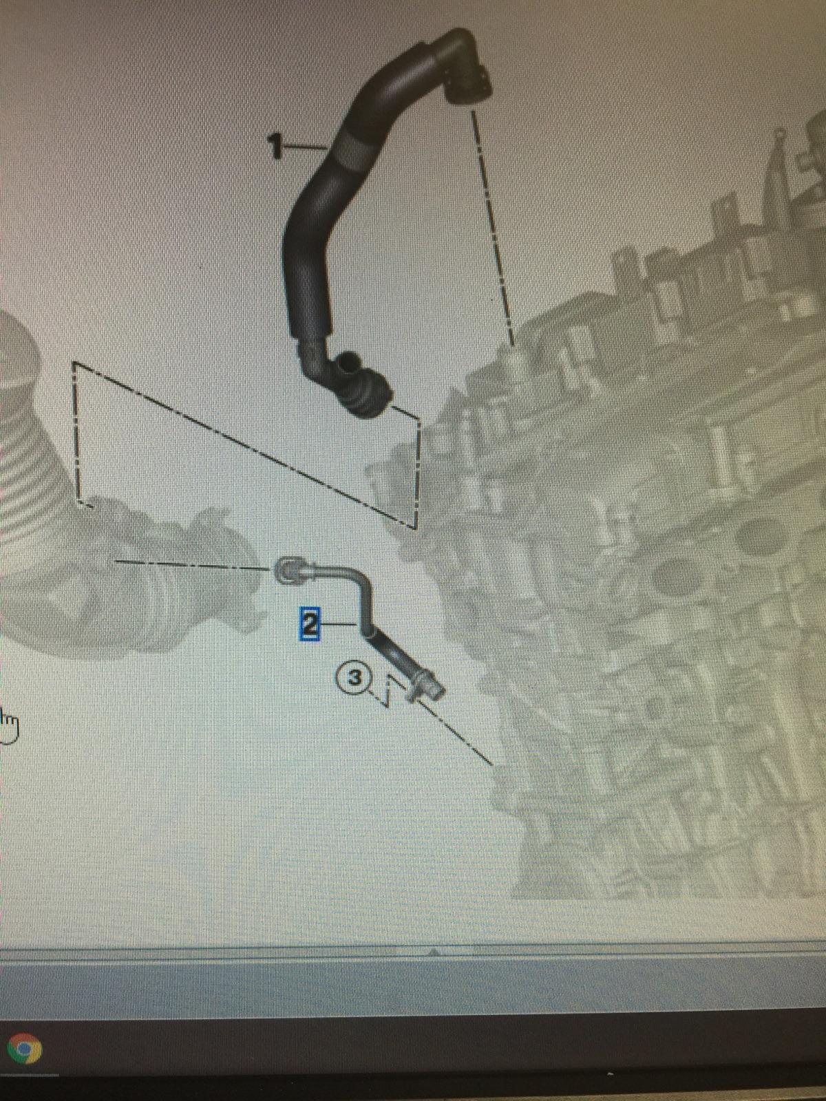

I'm trying to figure out what this hose is or does. It appears to be vacuum only. It is #2 in the diagram and connected from the intake pipe to the side of the block.
BMW has a valve that opens when under boost only to return crankcase pressure back to intake at least on the n55

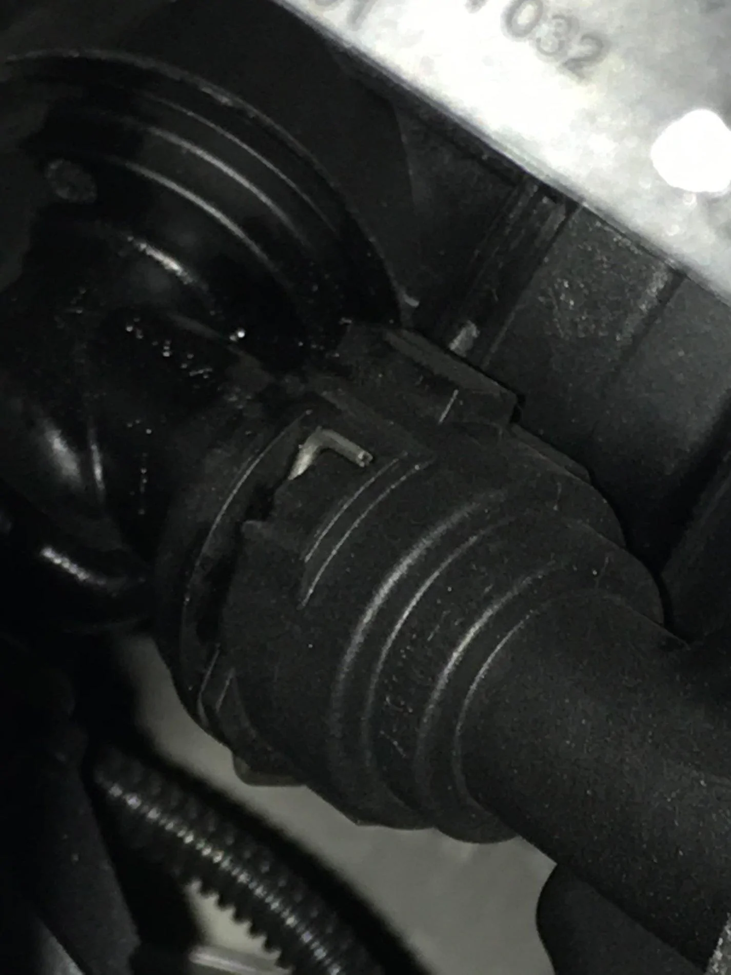

where did you get that diagram from? and where can i get a replacement hose for that? when i tried to remove it for my new intake the pinch piece made of plastic was brittle and broke, its still holding on but im worried it make not hold as well as its meant to
RealOEM or BimmerRefs

I broke mine same way when installing my intake, ordered a replacement but ended up never replacing the broken part because it’s working fine 🤷🏽‍♂️🤷🏽‍♂️
I have a brand new one on the shelf in my garage lol
I lightly cracked the corrugated part where it attaches to the intake. The hose is still very securely connected and pulling does not release it.
I ordered a hose from Toyota and plan to install it eventually when I replace the charge pipe.
yup mine is broken in the same way, been running it like that for over a year with no leaks… I would be more worried about the end that’s attached to the block. I always inspect that little hose expecting to see PCV leaks but it’s holding up just fine.
