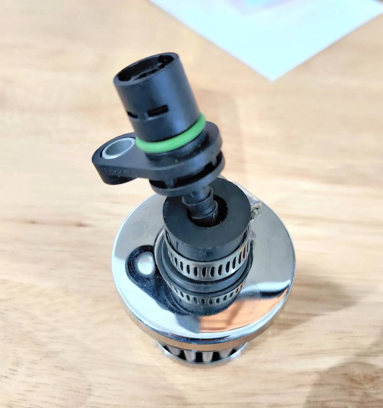

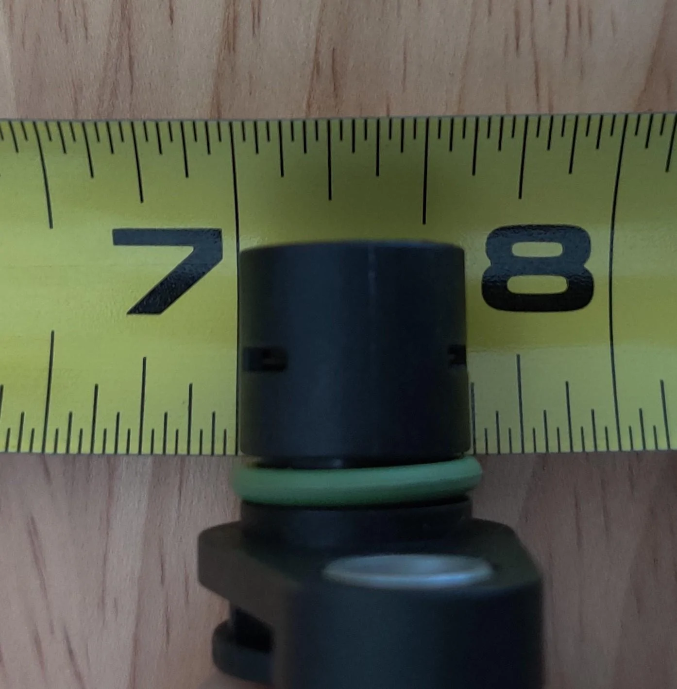

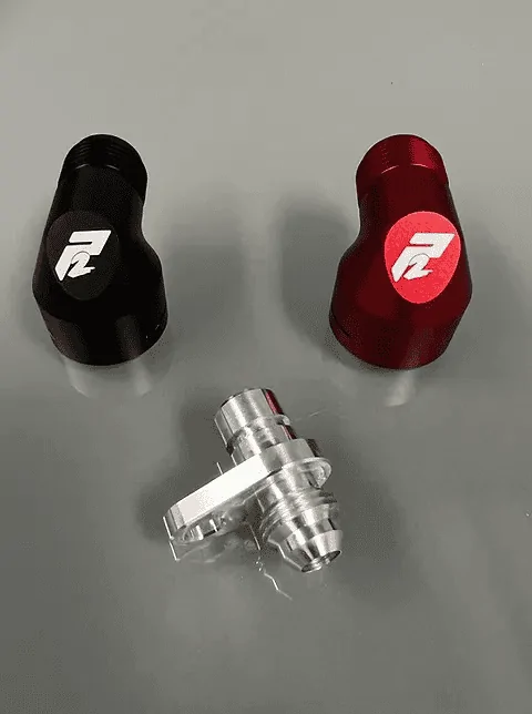

Want to take some measurements of the fitting? I would imagine it's a pretty standard size.
All I've got at home is just a tape measure... looks like a hair under 5/8 inch diameter. maybe 15 mm?
The barb is 1/4 inch, not having much luck finding a breather of that size. 3/8 inch is about as small as they go.
racebuild
Jul 14, 2023
241
290
BMW
AN-4 would fit a 1/4” Barb fitting. Could use a non-stainless reinforced hose like push lock hose or a pro-lite hose.

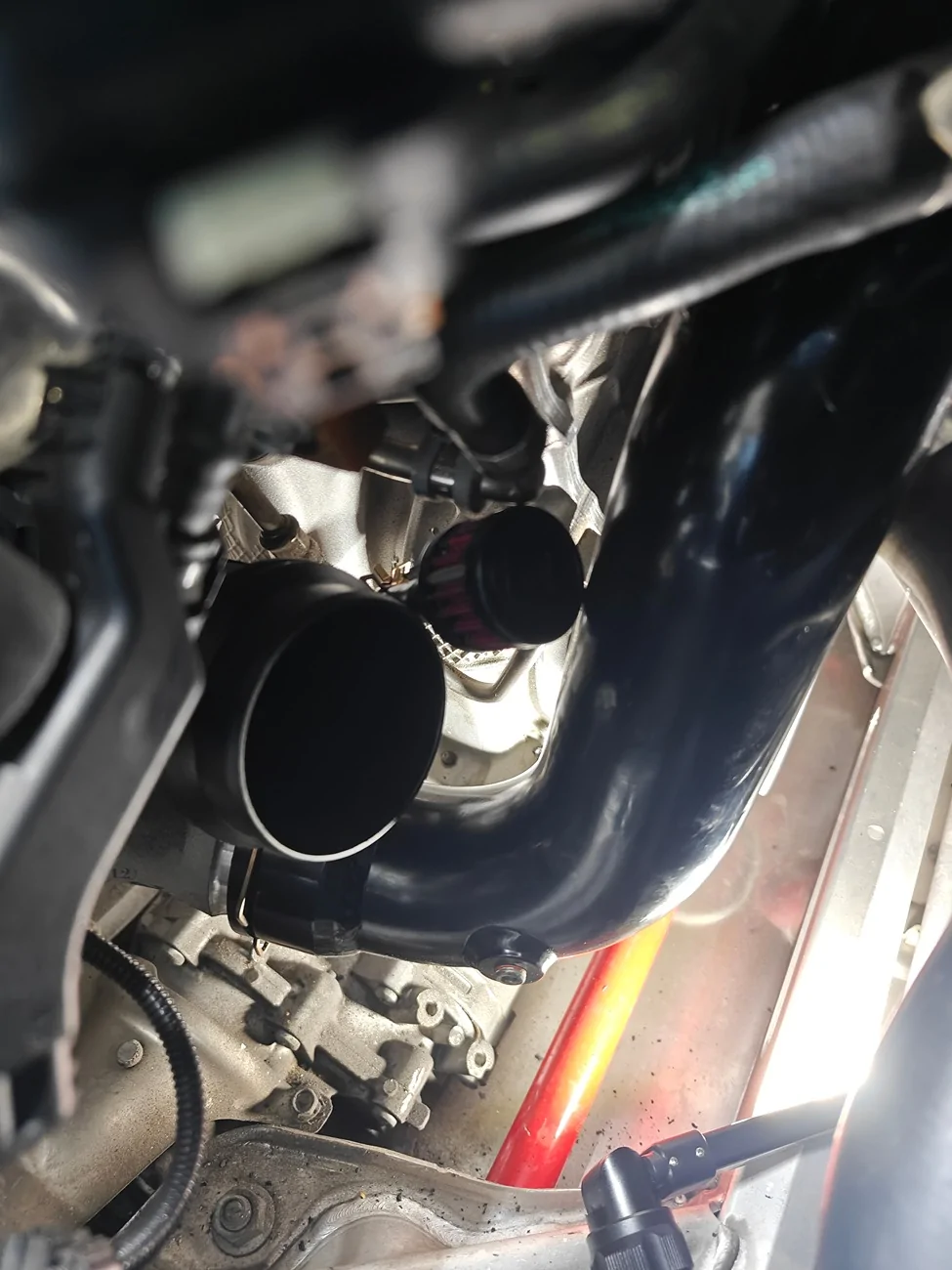

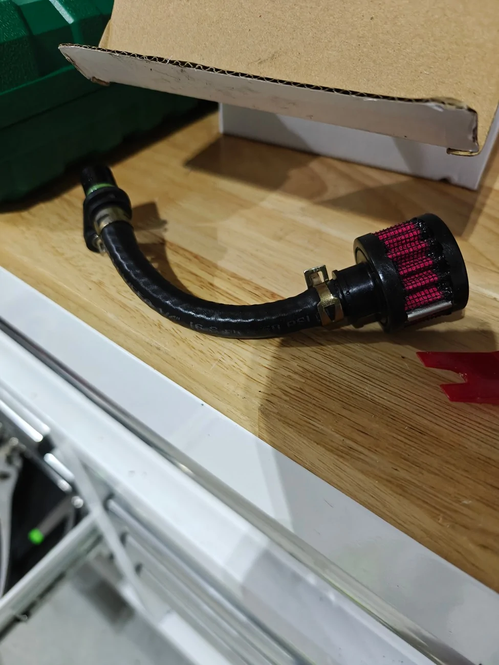

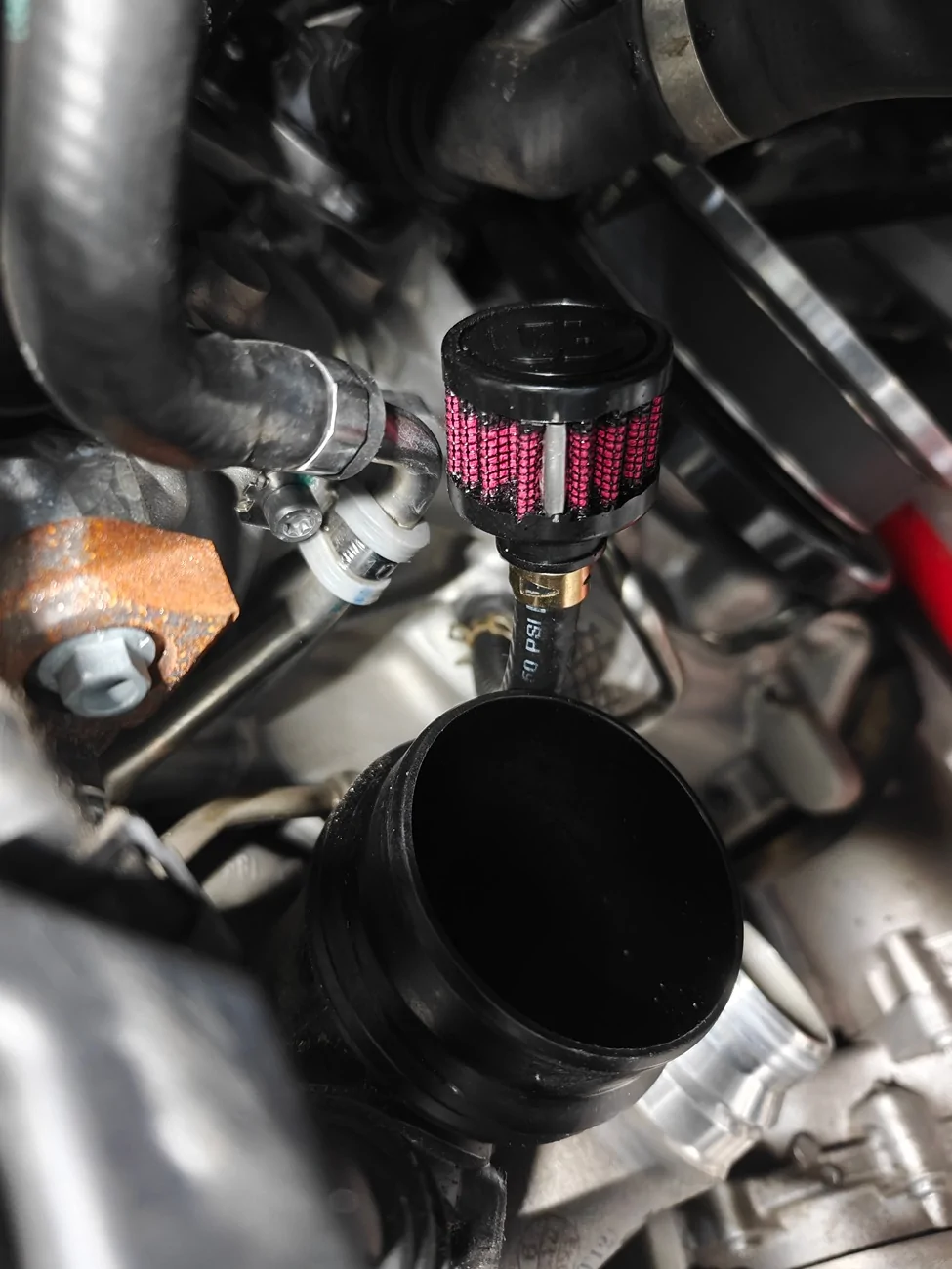

About 2 weeks ago I harvested the fittings from a new stock hose and connected them with some 1/4 inch 30R7 fuel hose (about 12 inches or so). I was debating on 30R9 or 30R10, but I figured the reduced permeation would come at the cost of increased stiffness (and therefore, less strain relief), which isn't a good thing if the fittings are the weak link.

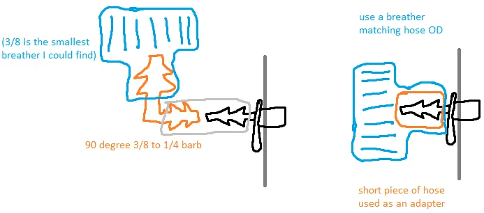

However, a small breather on the CCV and capping the intake would still be ideal, IMO. Here's what I was thinking, I'm guessing you were thinking of the right option?

It's too tight to butt the breather right up against the ccv. need to give it 6 inches of length to make a bend. Theoretically, it would have fit if the Breather had a rubber clamp on instead of a plastic Barb.
i3igpete
May 16, 2022
46
1,310
1,584
Chicago
2023 3.0L 8AT

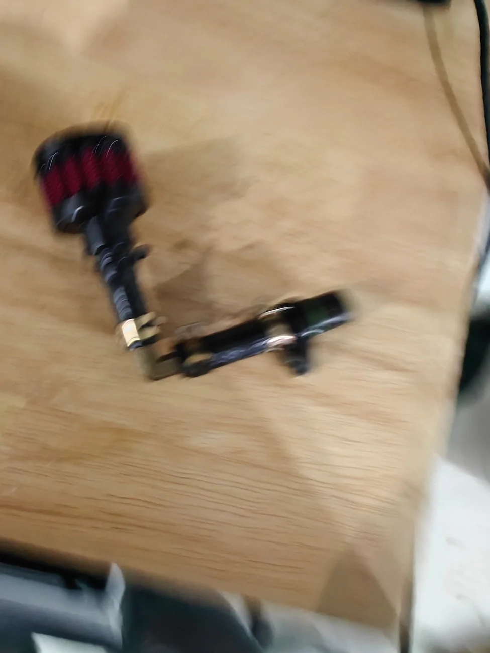

Out of curiosity I grabbed a brass 90 and see if it would fit between the crankcase and turbo without getting in the way of intake or charge pipe. The answer is no, there's also not enough space to clock it to the left or down
i3igpete
May 16, 2022
46
1,310
1,584
Chicago
2023 3.0L 8AT
That first one would probably work if you chopped it down... Though at this point i dont think anyone cares but me and I'm just typing into the void

There is a check valve in the fitting that only allows air to go into the crankcase from this hose. That being said, no check valve is perfectly leakage-free and some oil will weep out over time.
