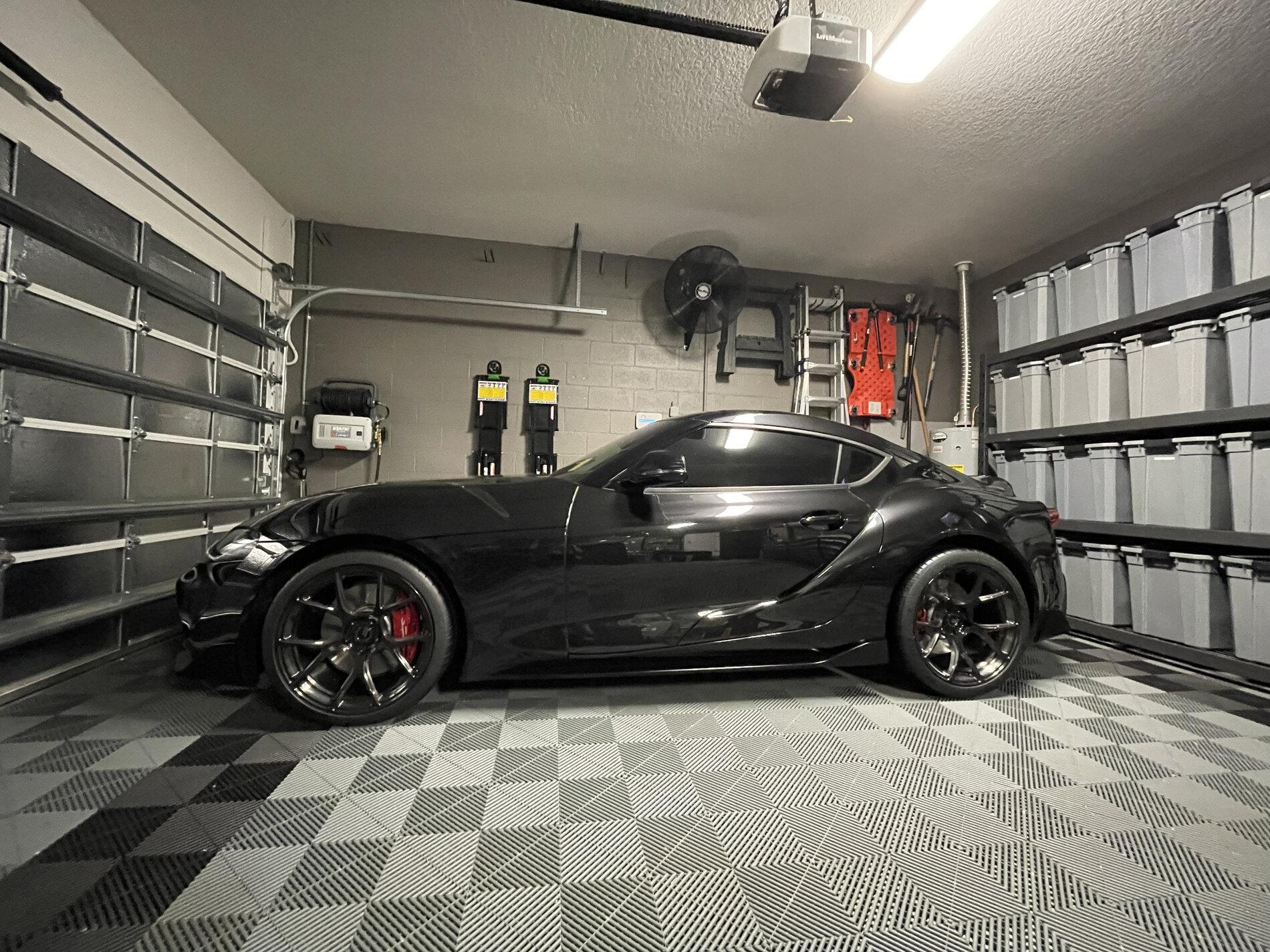

A few people have asked for more pics of my garage. I spent the weekend reworking some parts of it, its still a mess (to me) but its getting better. Nothing new on the Supra until someone decided to ship me parts I've ordered, or I finally decide on a spoiler.
Garage viewed from one side to another:
A few drawers from my cabinets to show some tool storage:

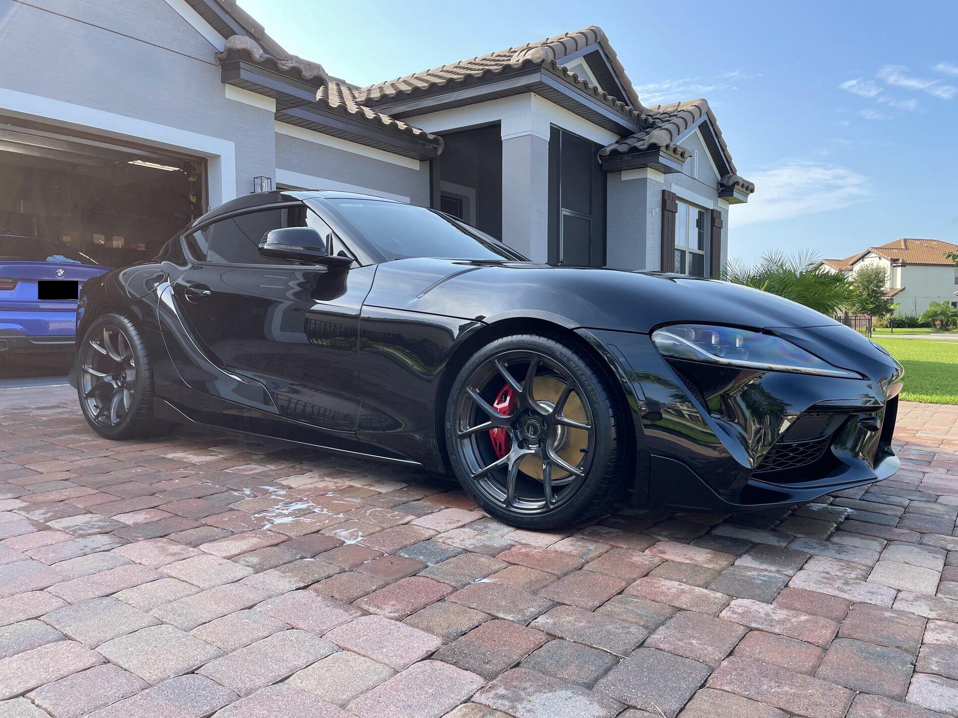

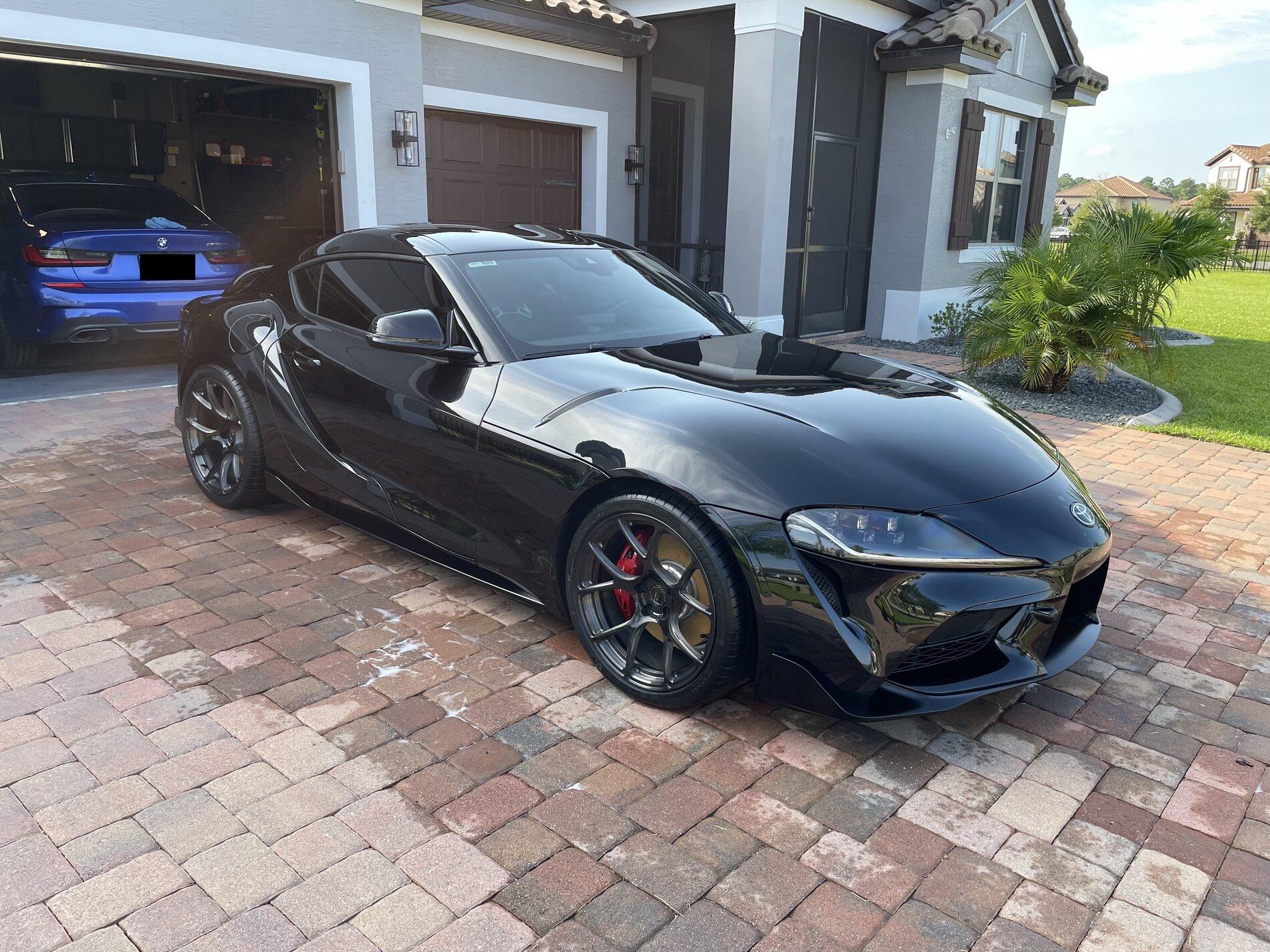

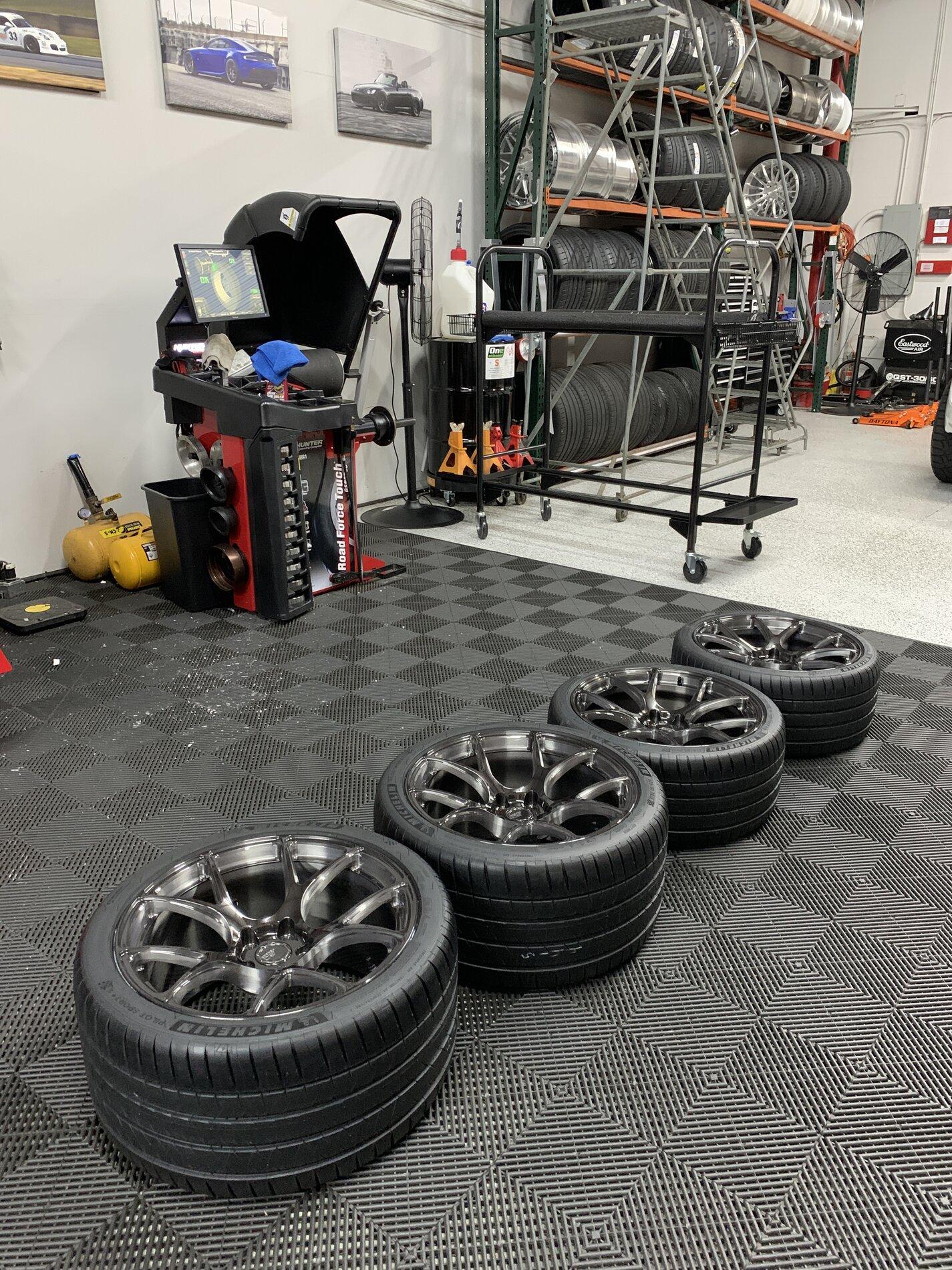

Great News Everyone!!
New wheels have arrived and are mounted. Unfortunately I'm still waiting on those pesky Germans to finish building my suspension, so I'm in 4x4 mode until that happens (allegedly end of the month).
What suspension did you order?

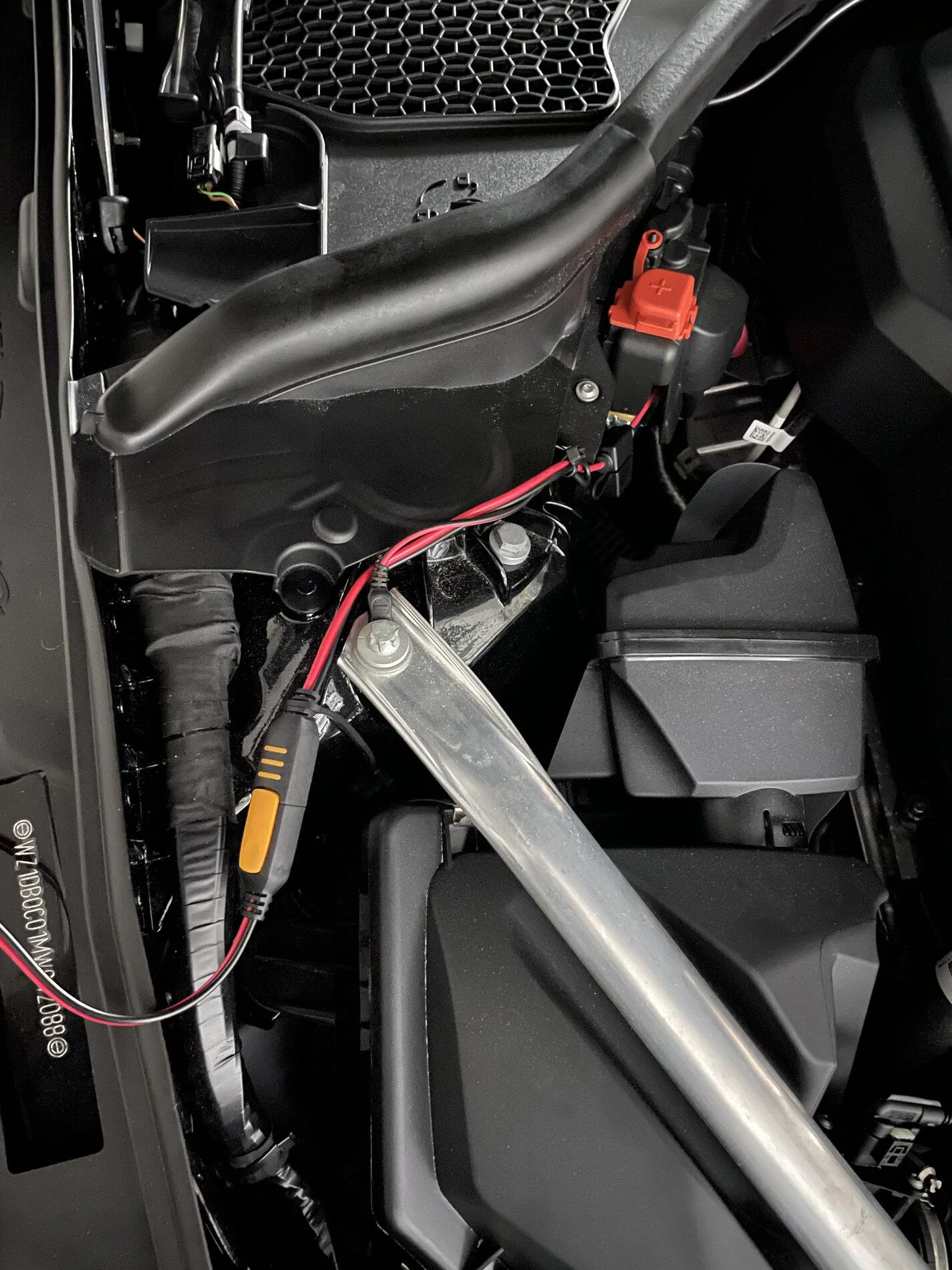

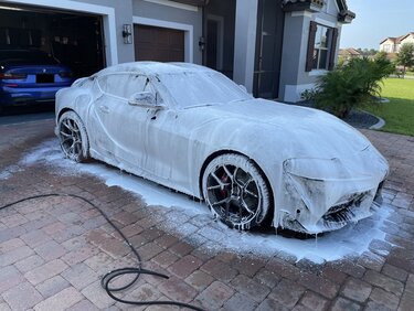

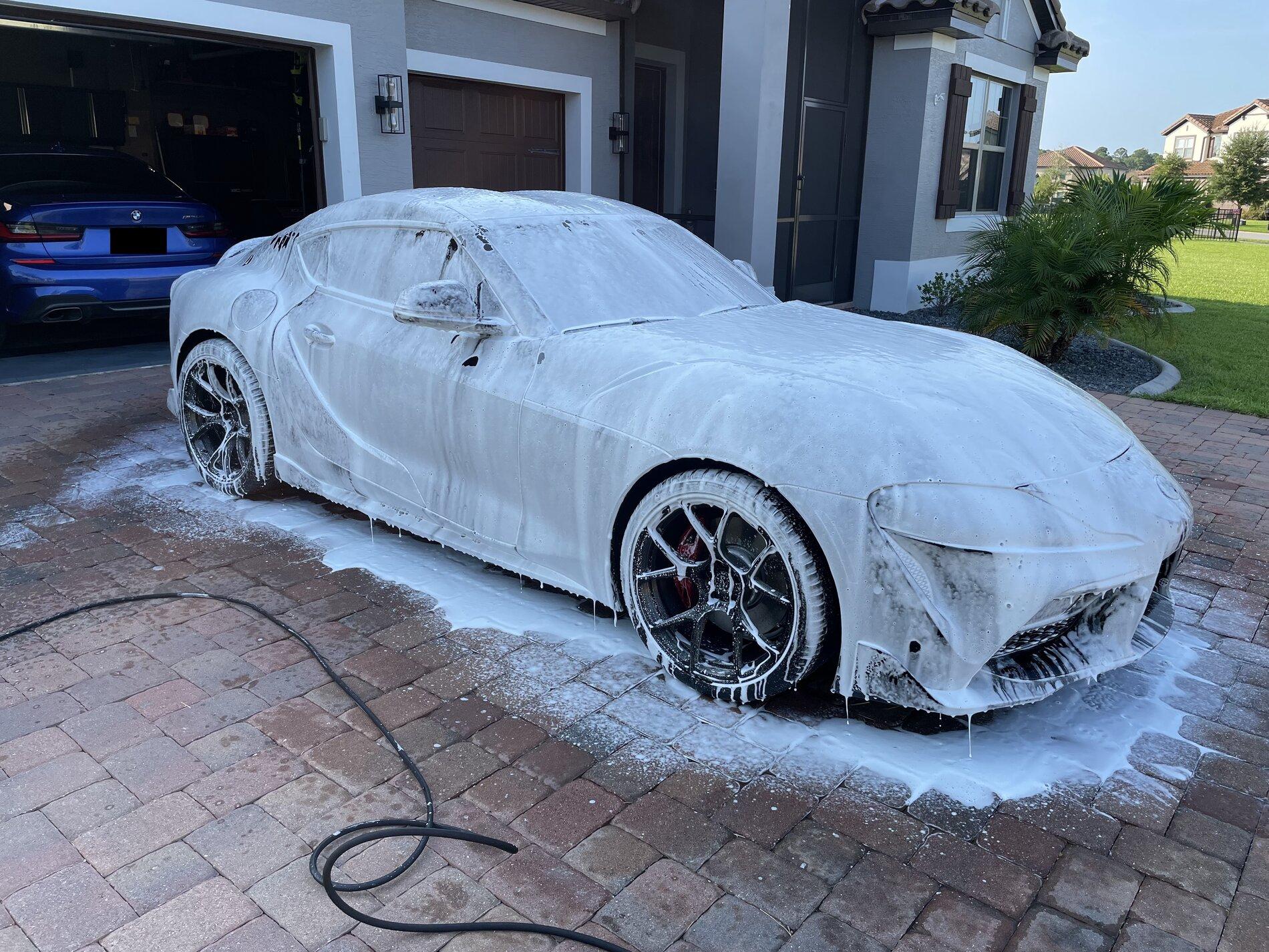

Finally had a weekend with no rain so I could give her a wash, and got my CTEK wired in. Im not super happy with the wiring location, so Im gonna have to play around with it.

In your second picture, there is a split in the weather stripping there. You can pull that back, and run the lines under/through there into the cowl that covers up the empty area behind there. It's much cleaner for that particular installation. (In that space, you will also find a ~cloth square cover over a gromet that enters the passenger compartment if you want to run the wires that way.). If you really want to get clean about it, there is a metal brace directly under that weather stripping. You can losen the bolts on it, and feed the wiring under it.

Thanks for the tips! Ill try to move some things around next weekend.

I also just noticed you're running the ground to the shock tower, there is a better location in that cowl area I just described where a factory 8mm (I think) is holding a factory ground for something. Use that. :)

Interesting, Ill take a look. I checked a few spots with my multimeter and that spot had proper voltage and low impedance, so I figured it was safe.

That's a fair point. I don't doubt that it's safe, but it's ugly. :)
