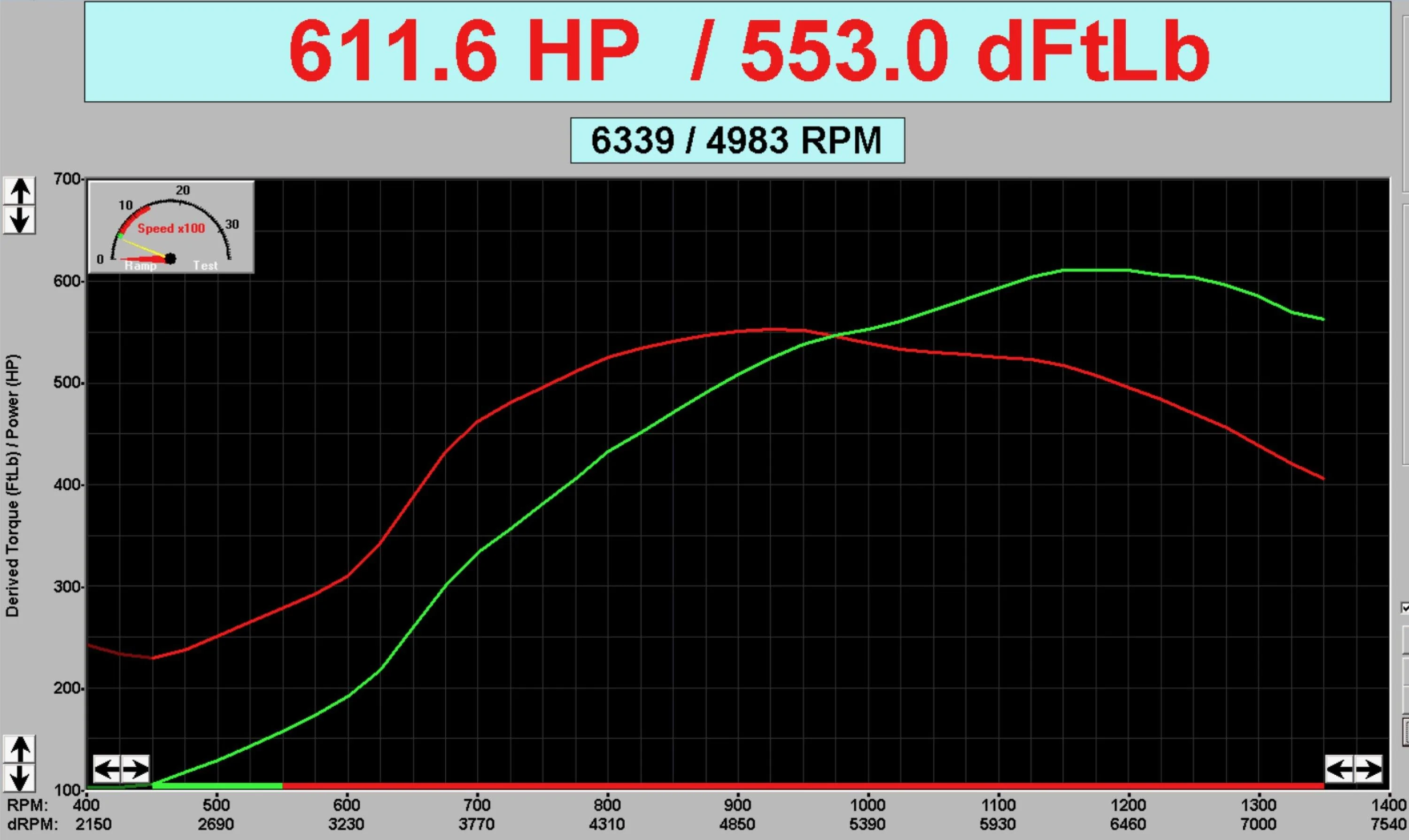

Here is my dyno from the new 6-port Flow Max.
MS109 with port injection.
Was done on a hub dyno at AMS.
Tune is a bit unstable below 4k rpm

My first one blew at 25psi. Second one was fine.
New ones have upgraded internals.
My friends first dyno run was 605/738 on stock trans. And has no issues. Tq was dialed back a bit

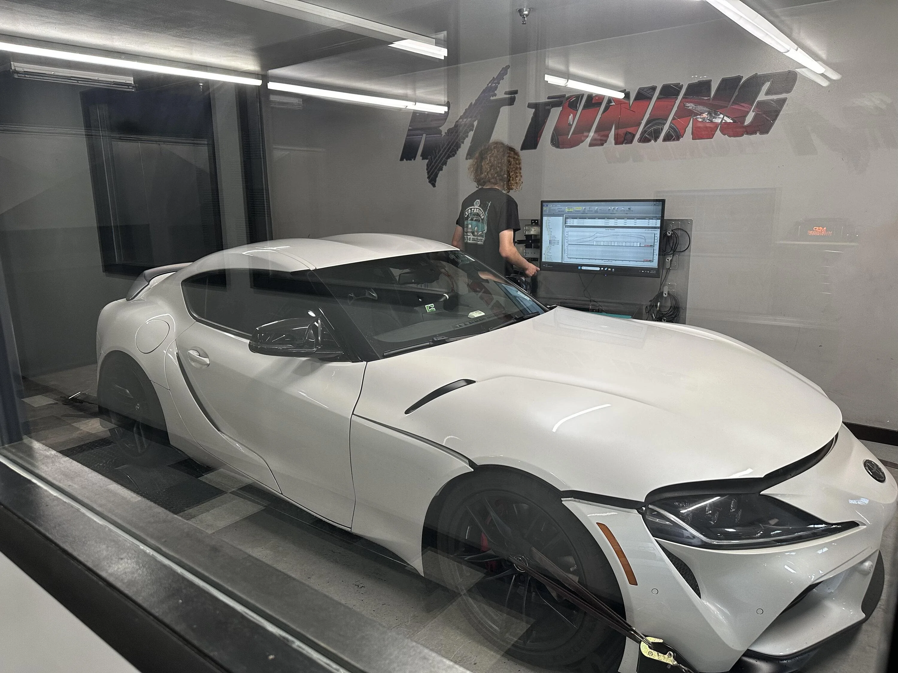

Baseline numbers would have been nice. If it’s a regular reading dyno this seems very unimpressive on 93 octane. Only 10-15hp more than stock turbo on 93 and an OTS map.
Are you planning on running ethanol?

Hey yall. Just wanted to share some dyno numbers on the DAW Ultra Flow Turbo since theres not a lot of data for this turbo specifically for the supra. This is the original release of the ultra flow not the revised "r" model. 2020 supra 3.0 2 port. Dyno used was a Dynojet. Running stock intake, catless dp, tomei exhaust, 93 fuel. Final numbers are 458hp/496tq. Not that it would make a huge difference but the dyno tech forgot to turn AC all the way off in the car (i had it on before handing over the keys so its my fault haha). Not the best numbers comparing with other hybrid turbos on 93 but ill take it. Car feels pretty good so im happy. Just wanted to serve as a reference for prospective hybrid turbo buyers.

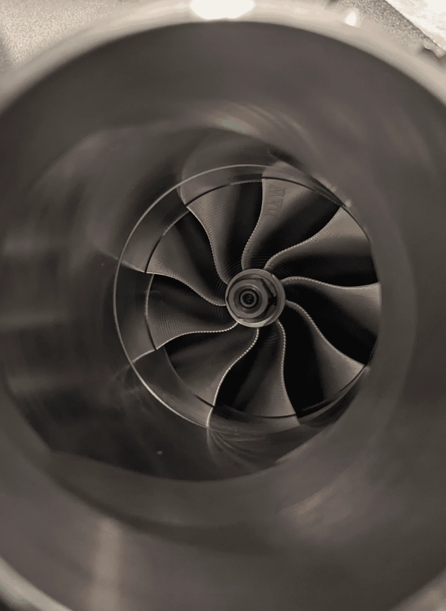

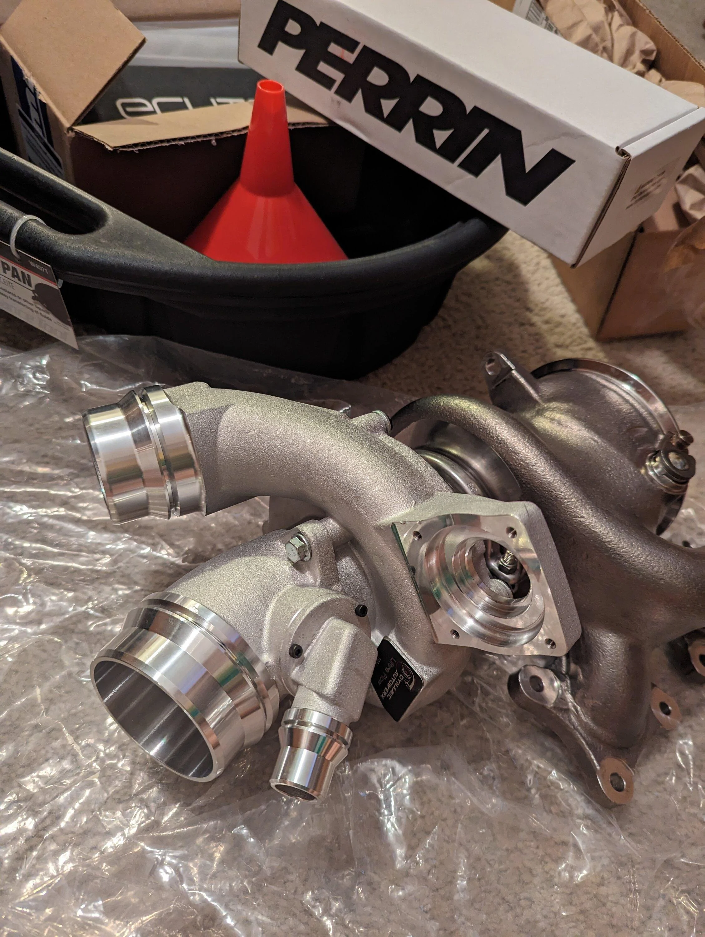

I've been told there was no original ultra flow for the 2 port and that all 2 port ultra flows are in fact the revised versions but are not stamped with a "R". I have one but have not installed it yet. I've also been told you can tell by the blades... If they are flat it is an original version but if they are curved it is the revised version this is what mine looks like.
