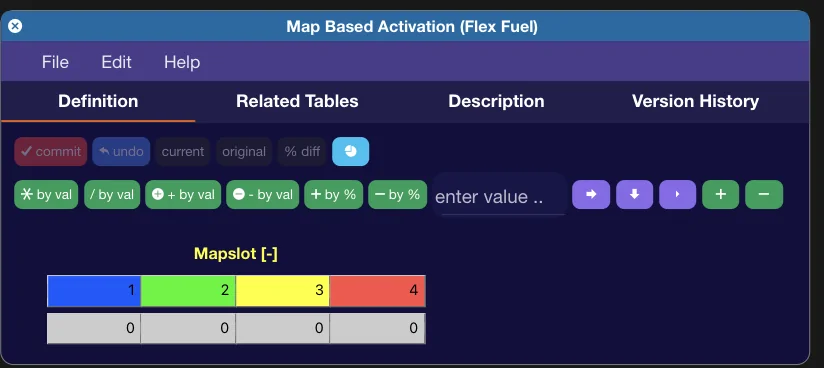

afaik, map switching is when you use your steering wheel to pick between separate discrete maps.
if you're taking about bm3 multi-map, it uses 2 maps (full gas or full ethanol) and interpolates ALL lookup tables on-the-fly. note that the "full ethanol" threshold is user-defined and doesnt necessarily need to be at 100% E. Multimap then takes up one slot on your steering wheel map switch.

I looked around for vids on the bm3 flex fuel kit and wondered how the auto switch map works? Does it just adjust the boost depending on your ethanol??
Adjusts fueling, ignition timing, load and torque target, the last two change the boost indirectly.

One slight bit of clarification. With multimap and flex fuel, you can still have four different maps you switch between and you can set them to also interpolate to your flex fuel map as well. All four or just ones you select to have that capability.
Which is super awesome for flexibility. I use it like that to have different power maps for track use.
If you just want super simple, you setup one map slot for your pump gas tune and use the flex fuel to interpolate based off that.
That's.. wtf that's super cool. So you don't have to worry about going 93 to E30 or 50?
So how does it work when you have custom tunes for set fuel grades?
8,717
17,089
If it's tuned correctly, nope.
If they are in the map slots, you switch maps via the steering wheel toggle or the app.

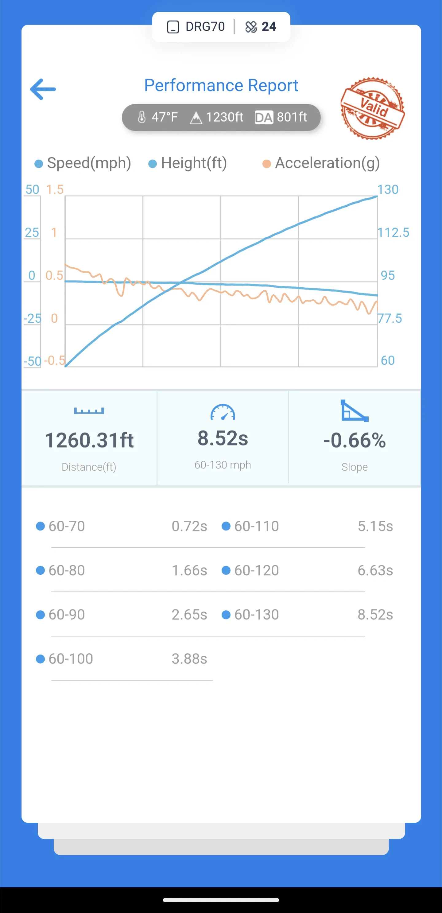

Just got my ultra flow r and BM3 flex fuel kit in today after a bit of black friday shoping and ECU should be arriving today as well. Probably going with Sameh for tuning see how that goes.

Well there is this sheet
Many people on that sheet are in that .01%, constantly trying to make small modifications to improve times in similar conditions
I’m a little confused how an EcuTek tuned stock turbo car is laying down quicker times the a Pure 850 jb4 car?
