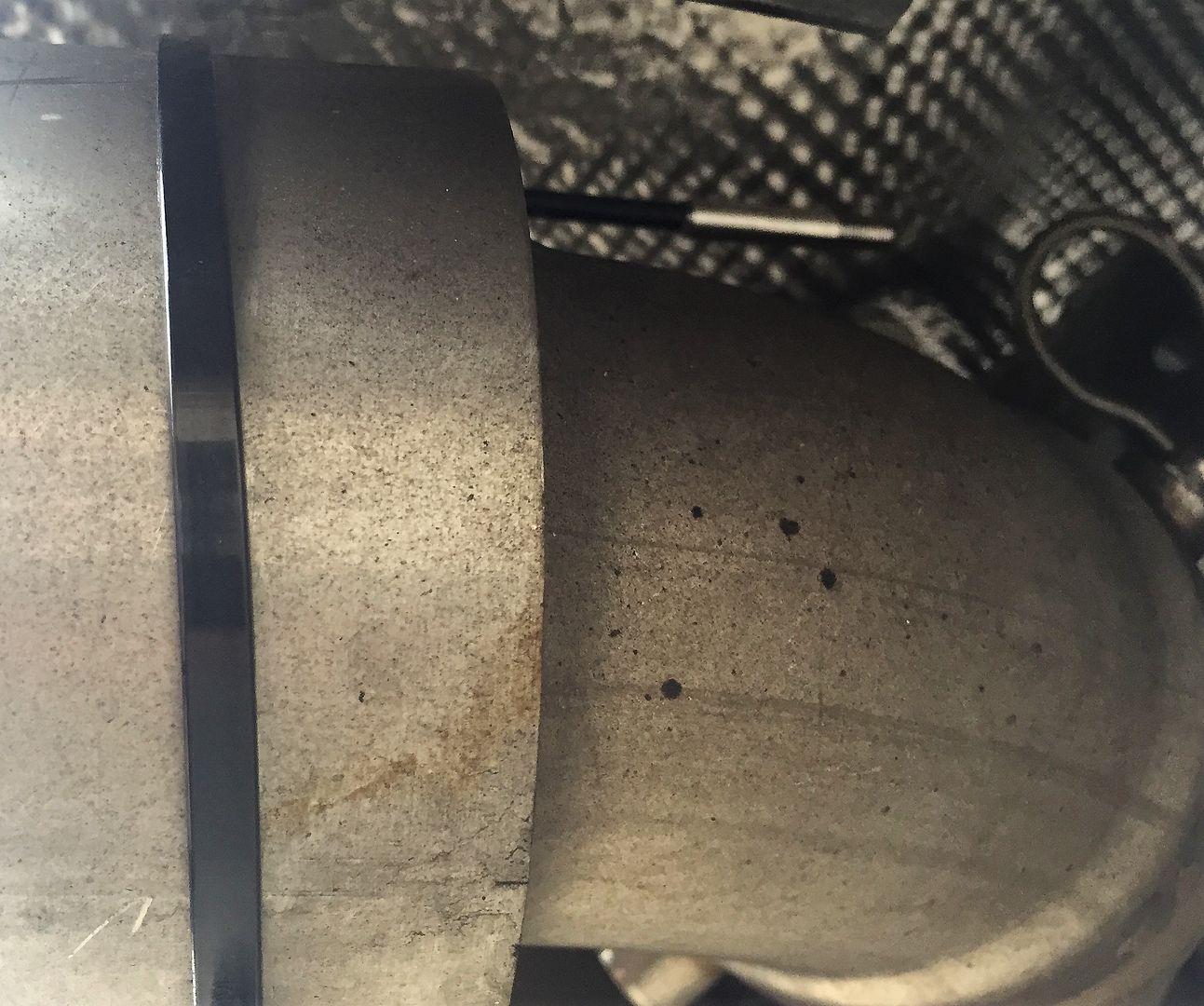

I grabbed one of my bore scopes & "gettoed it up" this afternoon with cable ties & chucked my laptop on the passenger seat
a90moe's post is correct, on my car (non US) in comfort mode it opens once the cold start sequence is finished then shuts at 20 KPH
Sport mode opens the valve, I couldn't get fast enough to see if it shuts in 7th & 8th in sport, if caught I would be instantly walking :(
I can't hear a difference in exhaust note as our factory exhaust is much more quiet than the US one even with a catted Wagner down pipe & our roads have coarse chip so there is plenty of road noise
Looks promising for a Valved Cat Back :)
