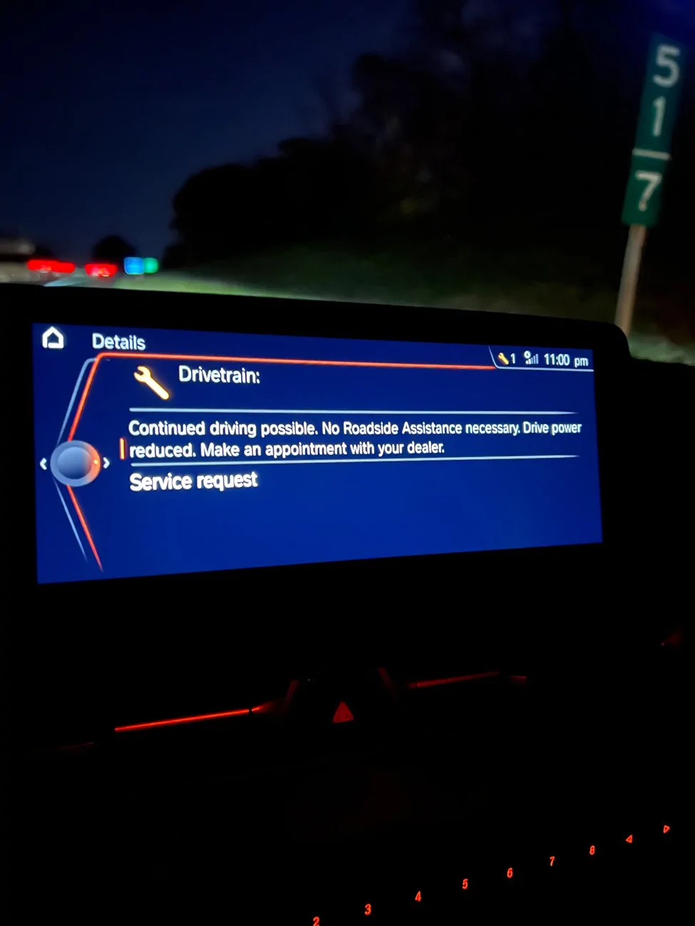

Recently got dyno tuned. Car made 415WHP and 505TQ on 93. I have a CTS Catless Downpipe, MST V2 Intake, RK Titanium Single Exit Exhaust. Driving from work last night I did a pull and got this message. Car went into limp mode. What can be the issue?

im going to change spark plugs tomorrow and see if that fixes this issue. will update

Got strapped to a dyno?
Do yourself a quick favor and check the rear ride height sensor. The bracket is plastic and breaks on lowered cars or when strapped to a trailer or dyno and sometimes it just gets moved out of position. Plenty of threads regarding this.
If that's not it, then scan for codes before doing anything else.

Post the codes. Why do people ever even bother posting here, or investigating any issue, without looking at and sharing the codes? OP is out there changing spark plugs without any idea as to whether or not the ignition system is triggering the codes. Y'all need to relax, step back, and think.
